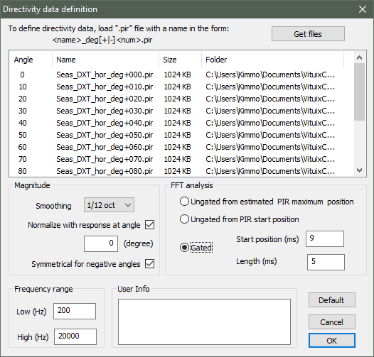

Arta help please
Please forgive me if these question have been asked before.
1. Is is possible to normalise a FR, set it as an overlay, load another IMP and add the normalisaton 'error' to that response in FR?
I'm trying to make a polar response plot that shows just the off-axis errors.
2. I find the FFT analysis option of the Directivity Data Definition box confusing. How do I set the gated time window for each response? Where can I find the appropriate 'Start position' value?

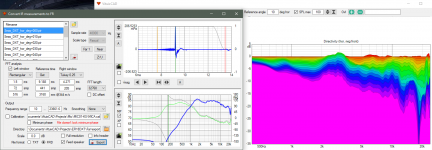

One option without ARTA is VituixCAD. Convert IR to FR, load all pir files, set FFT parameters, export all responses to driver in the main program, single wire as XO.

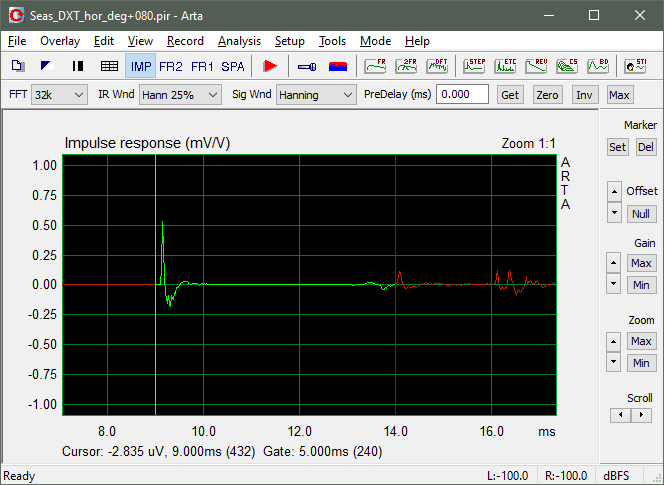

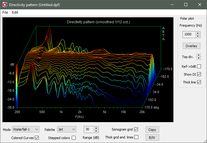

Anyway, directivity plot should work directly with ARTA. Just open pir file e.g. 80 deg to IR window and investigate start position and length of time window. Set those values to directivity pattern tool and plot.
