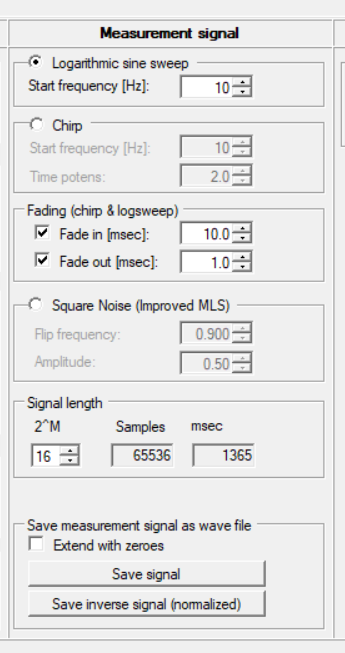

By this I mean is there some way to export the test signal generated by the "Impulse response measurement" function (swept sine, periodic noise etc) as a WAV or FLAC file instead of being played back through the sound card ?
In HOLMImpulse there is a provision to save the measurement signal as a wav file. This is how I managed, fiddling with start/stop, to record FR of my old smart phone.
