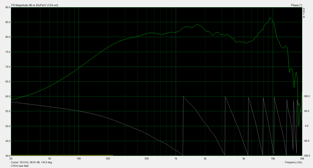

Thanks, but I'm not looking for minimum phase.
What I want is a correct phase response, like the one I got with my old Clio system.
In measurements with Arta, I always get this sawtooth visualization of the phase, as if there is always some group delay. I cannot understand where my mistake is.
![Cattura.jpg](https://i.postimg.cc/15sWwrNJ/Cattura.jpg)
