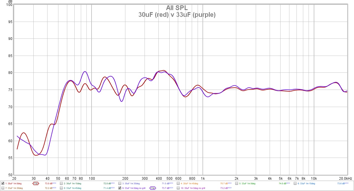

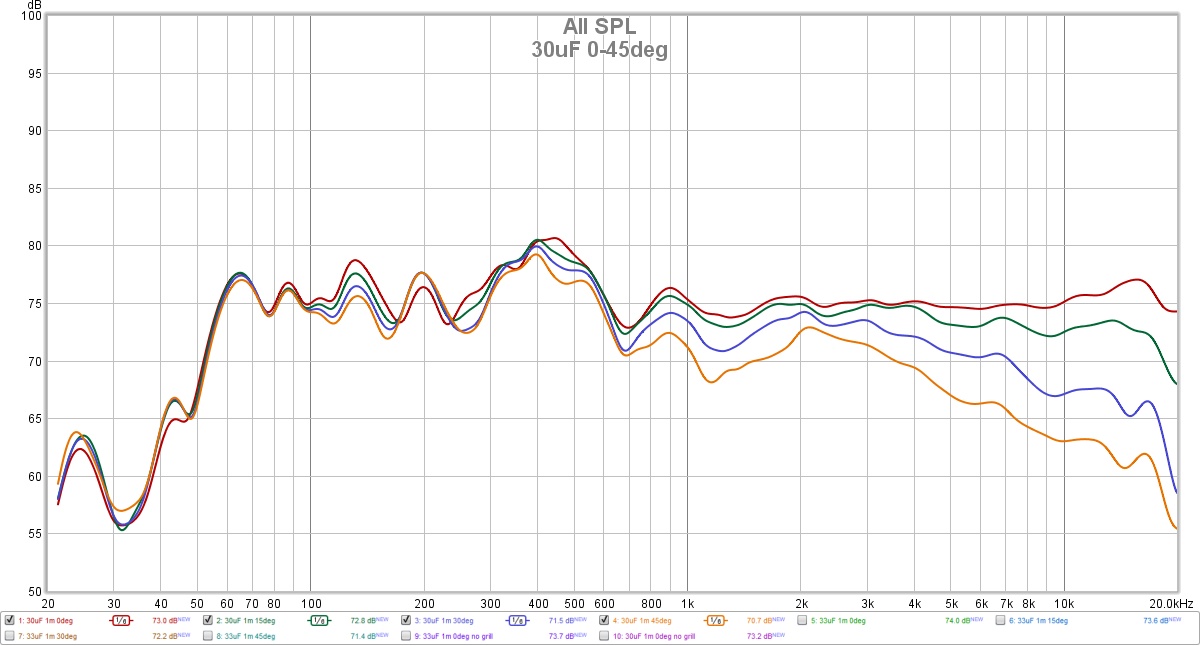

This is a bit strange, but there are a few small causes that may add up to this error.
The main reason is probably the 33µF cap instead of the 30µF I used. Maybe your two caps also fall into the upper tolerance range and have ~ 35µF.
When I posted the x-over with values common in the US, I wanted to make it a little easier - that was maybe a mistake. I have also just seen that 30µF is available from parts-express. Sorry for that, I'll change it in the plan.
The protruding woofer could also cause the slight increase at 2.5kHz, so that the dip underneath is even more noticeable.

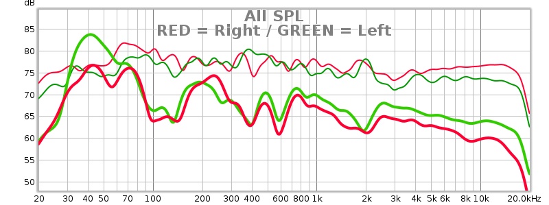

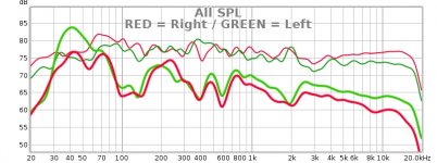

@Jesper:
That looks very good, but when it comes to scaling, almost everything looks good.
Please change the scale to 50-100dB, then you can say more. This can be done very easily via the "Limits" tab. You don't have to measure again for this.

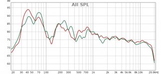

Doesn't look so nice anymore, but is quite normal when taking a measurement in a room.
You can see the dimensions of the room nicely. The peaks at ~ 42Hz mean your room is about 4 meters deep. The peaks at 70Hz come from the 2.5 meter ceiling height.
The dip at 130Hz is the floor reflection. Between 200 and 1 kHz it is mainly reflections that cause the unsteady measurement. Everything is as it should be.

Frankly, that's a relief. I didn't really compare the two schematics for differences. I've now ordered the 30uF parts.
FWIW, the woofer is flush mounted. 12mm tall magnets attached to the screw heads act as standoffs for the grill. I measured in-room with and without the grill but the responses looked identical. The previous rattling issue was resolved with a little gasket material between the magnets and grill.
Since they are room measurements, they are not gated.

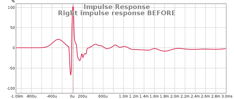

Can you put one loudspeaker with the microphone at a distance of 1m (~ 3ft) at the height of the tweeter in the middle of the room and measure again. Make sure that no objects are closer than 1 meter to the box or microphone.
Then also set a gate (button "IR-Windows", set right window to 4.5ms). With this you only measure the speaker and not the entire room.

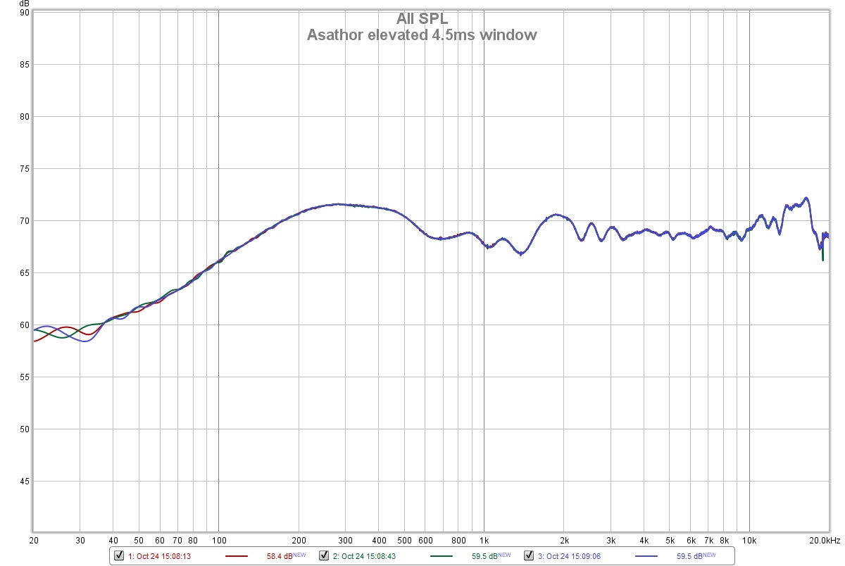

Thank you for measuring again. It looks like the measurement window is still too large.
Was the speaker in the middle of the room when you took the measurement or was there something within 2 meters (6 feet) that reflected the sound (walls, window, table or similar)?
This could be the reason for the increase in the lower frequency range.
Between 1kHz and 2kHz it is not quite optimal, but that can also be due to the tolerances of woofer and tweeter. The resonances of the woofer, which are exactly in this range, can differ somewhat more from woofer to woofer and this is then reflected in the overall frequency response.
Unfortunately, I have no other explanation at the moment, but all in all this is not bad and such small differences are also very difficult to hear.

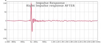

Evening all.
While enjoying my AsaThor's here, i ofcause couldn't resist making some EQ/Drc DSP fun.
I did not really yet have a good listning after filters applied, but will return here when i have some more time with it.
(Btw.: The dip @ 3kHz is something i did with EQ.)
Jesper.
