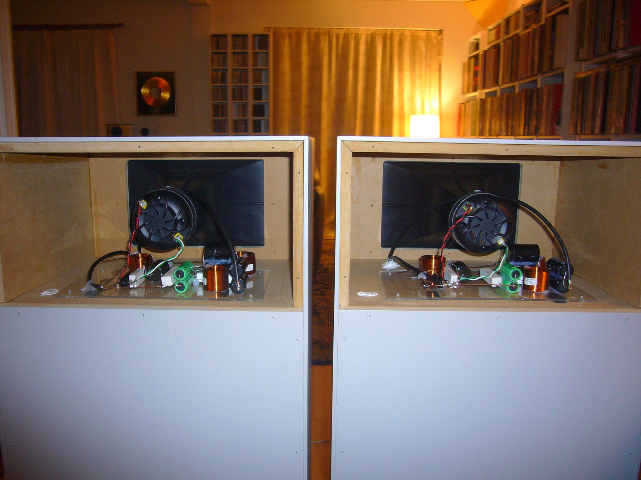

I for one thought, that I´d give´m a go after reading the home page and this thread.
So...... almost finished. Will be making the crossovers tonight, and hopefully tomorrow
these will play for the first time....... that is, if "Murphy" doesn´t interfere along the way

I chose a 5.6uF instead, so lets see, where this goes. I finished the crossovers tonight, got them mounted
in the boxes, and here comes Murphy again. Moved not so long ago, and now I can´t find the box, where I
hid all the plugs, connectors and................ speaker terminals.
So....... maybe tomorrow.

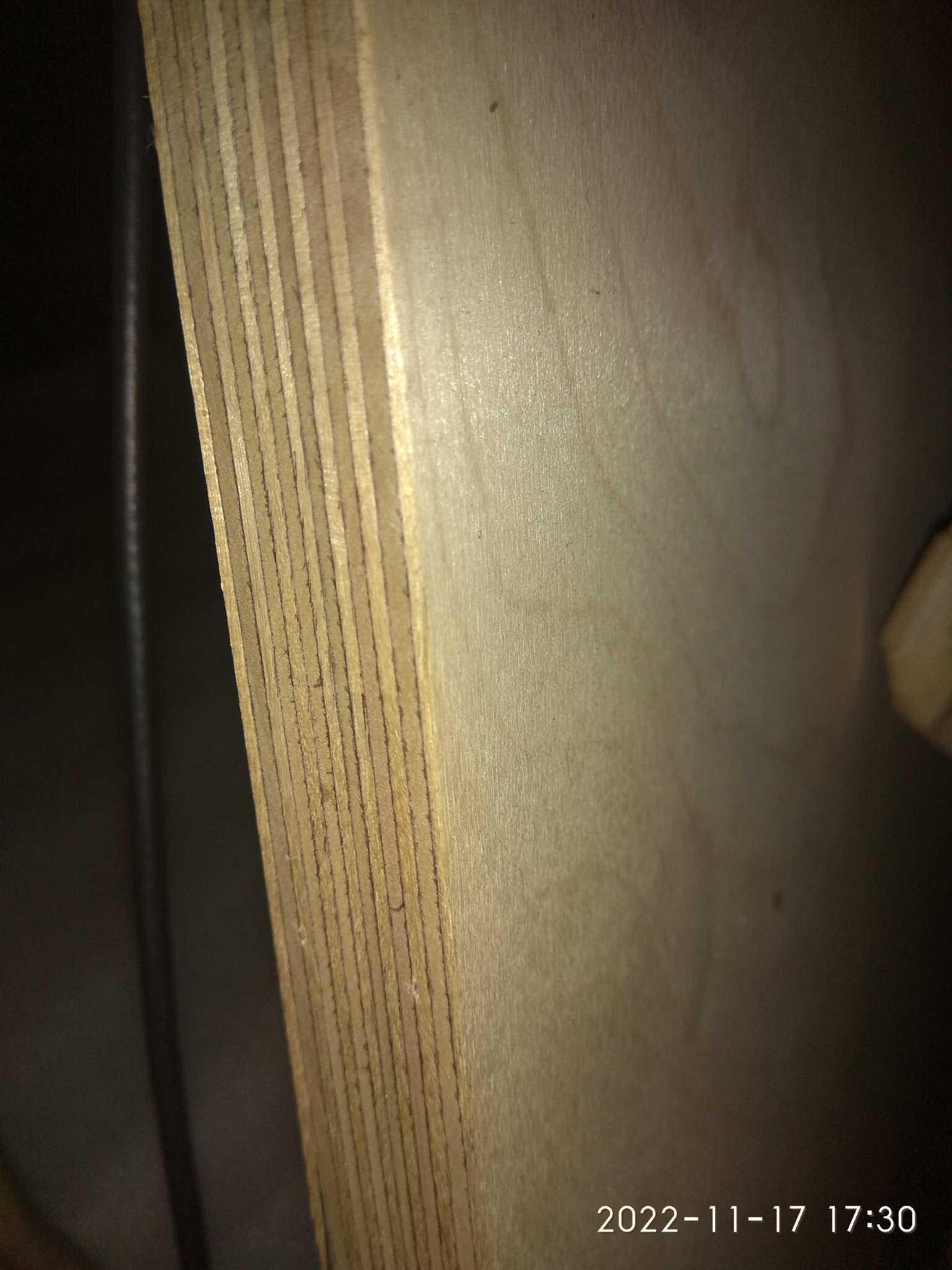

Of course you can use the plywood, that's no problem at all.
