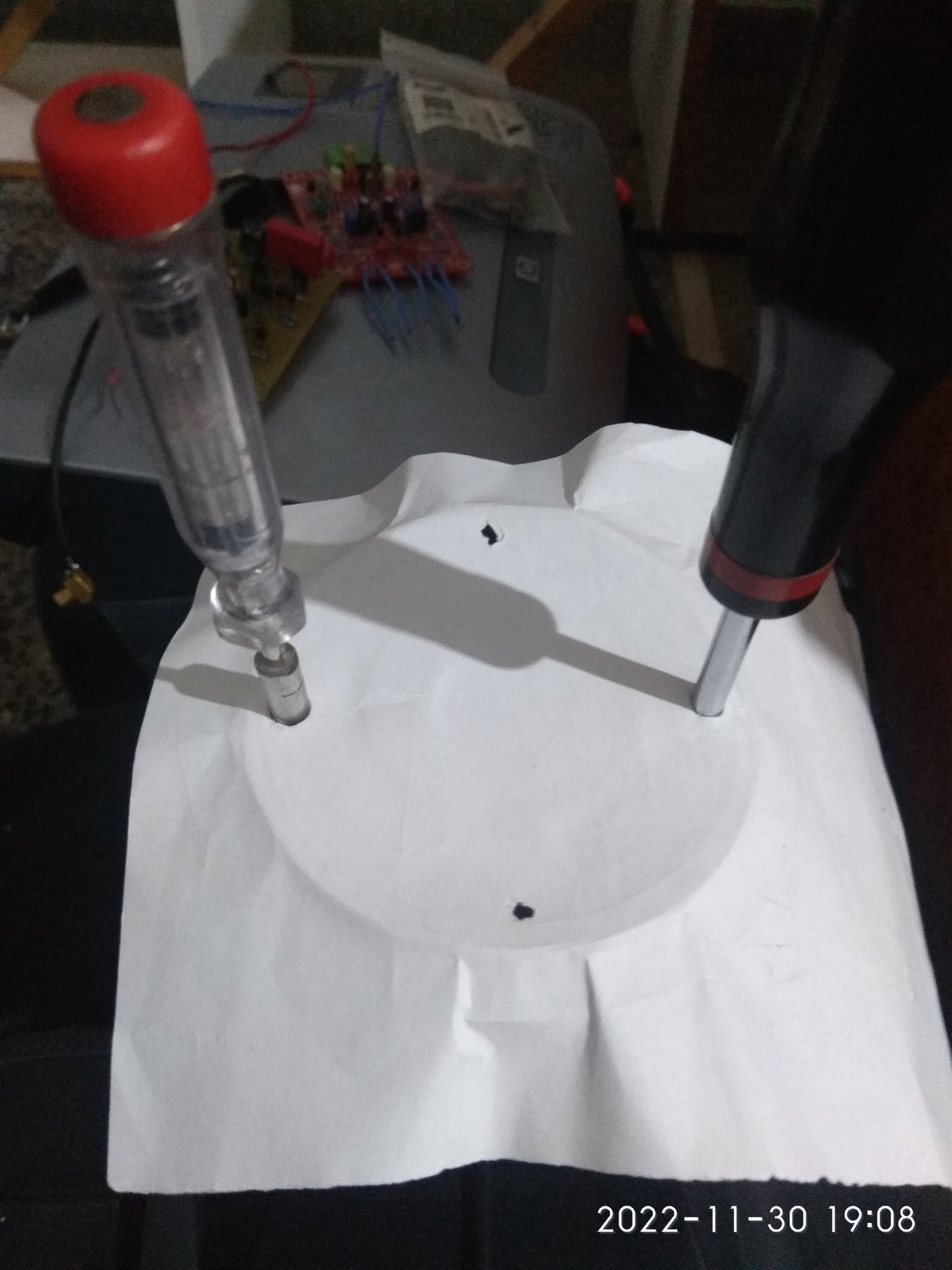

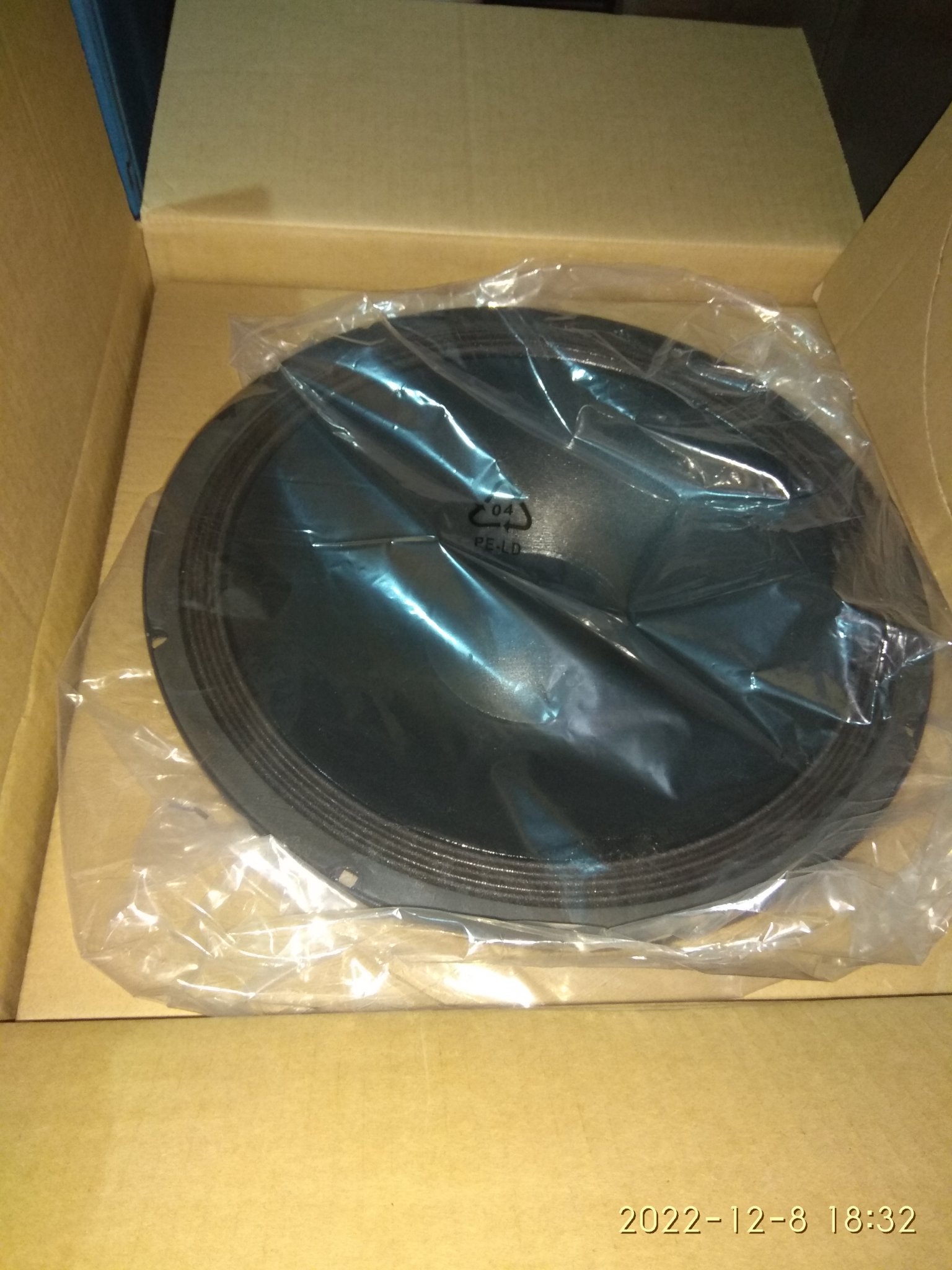

A horn driver arrived now.
I find that I have two options to mount the driver with the horn ,either i will use the two only existing holes or i will use only one existing one and open three new holes. In the first case, the driver will be supported on only two diametrically opposed screws in the second case, the loudspeaker will rest on all 4 screws.
What is better?
Another question,do I need aluminium screws?

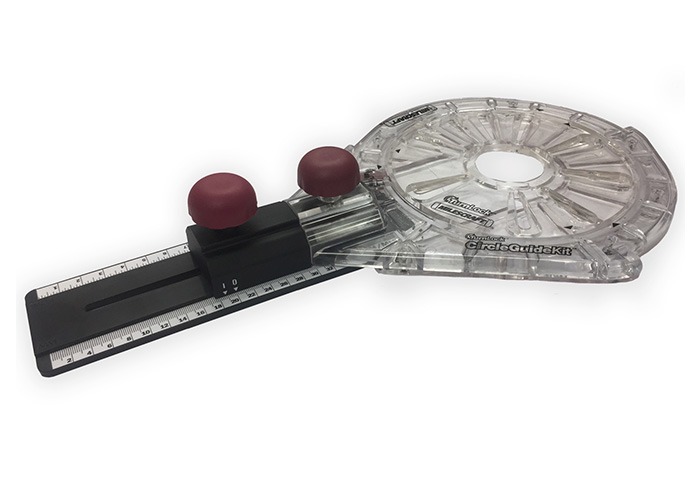

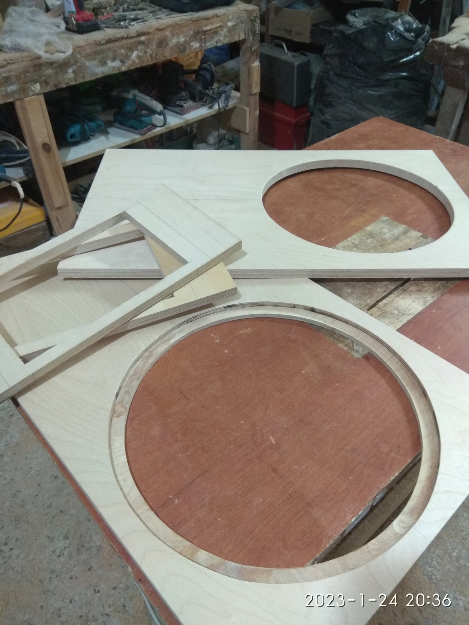

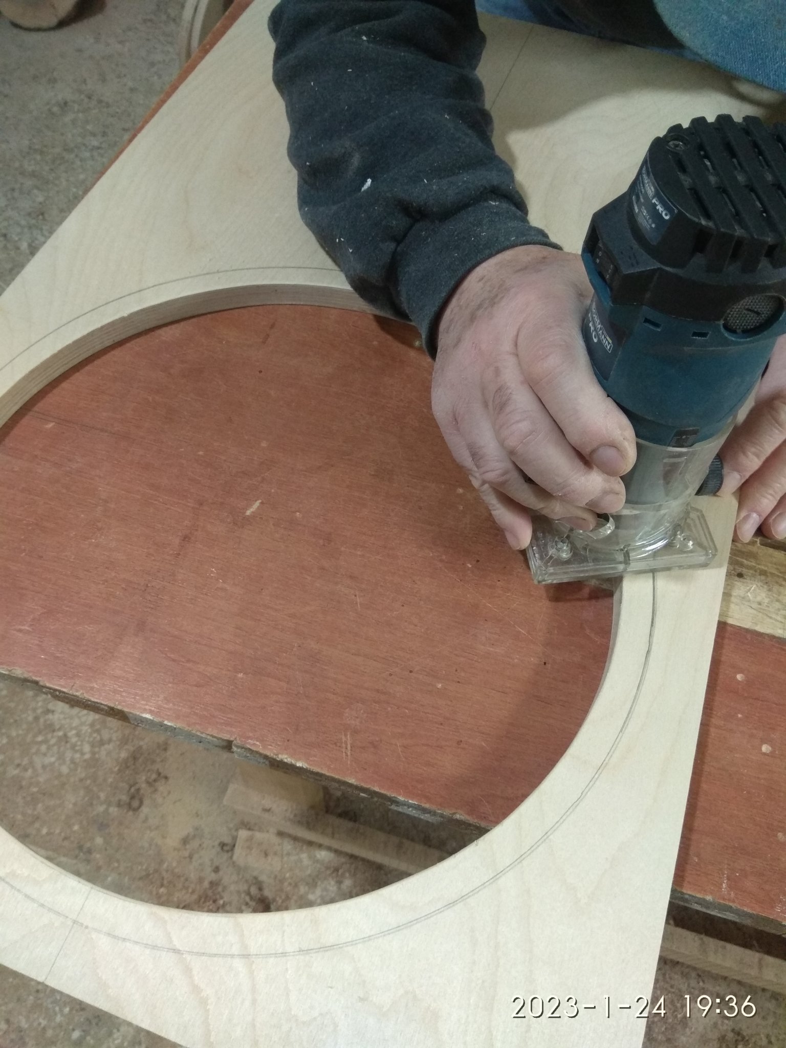

Do not even try it. Takes a very tallented carpenter with an extremely calm hand and years of experience to follow a line free hand with a router. Same with a jig saw. To cut a straight line or perfect circle looks much easyer than it is.
Most do it with a device that is fixed in the middle of the circle as pictured. You first cut the recessed parts and keep the center material until finished. Cut until you have a few milimeter left and then use a jig sam for the last bit.
If you got a router you should have one, as it is quite useless without it. You get them in different sizes or can build one your self with a router. Does not have to look perfect. A good project to learn how to use the router, too.
You can make circles twice the size of the tool. As you may use it for tweeter too, it is more interesting how small it can work, not how large.
Hint: Do not make the part where the router is fixed to strong, as you will loose depth for the router bit.
The one pictured is made especialy for this Makita tool, there are universal ones and plans for them in the net, too.
CNC is the right way but isn't available.
I cut my first round speaker hole with a handmade jig 40ya. For the last 20 or so I've used the inexpensive Jasper Jig. Works perfectly fine. I've seen handmade jig how-tos on YT too, but didn't save links.
CNC is nice, but NOT needed, even for odd shapes like waveguides or non round speaker drivers like 6MD38. Different technique required for the latter, but not difficult at all.
