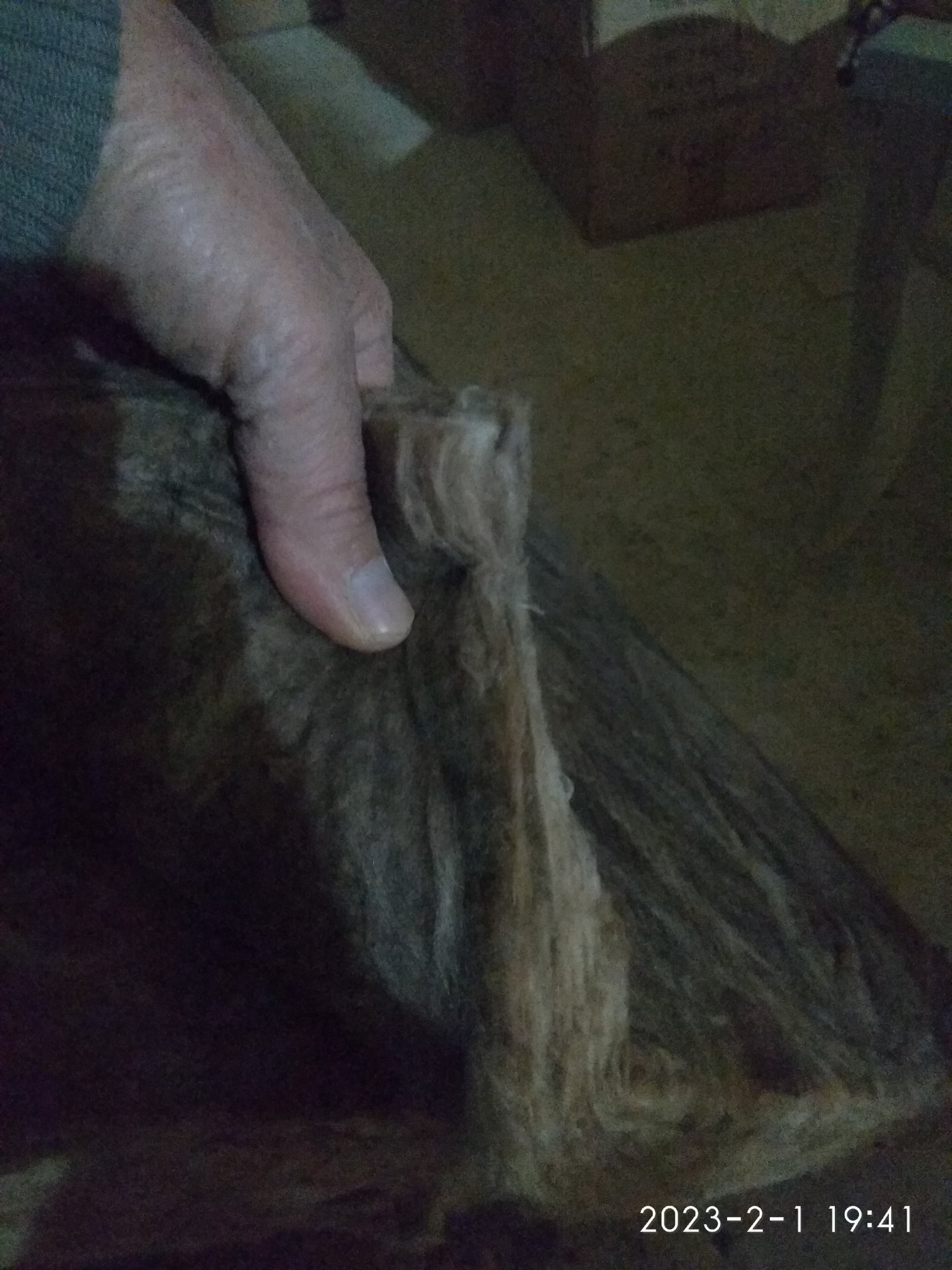

it is not a rigid material just to be more clear.These types of rigid plates are typically used to soundproof rooms. I'd be curious to see if they offer the same performance as a batt type would inside of a loudspeaker enclosure. There will be a difference in density between the two types. I believe a lower density batt type damping infill would be preferred to break up a wider range of frequencies. IME higher densities tend to be more reflective in nature.
It's denser, more rigid, than the batts are though. The purpose here is to adjust the enclosure "Q" and to kill off high frequency reflections as much as possible. Try it and see how well it works for you. Run some measurement with an empty enclosure and look at the lower end response. Fill the box till the roll off is nice and smooth without any "hump".
Hopefully, the damping you have applied will also be enough to kill off higher frequency noise in the box. If not, you may need to employ a less dense material to help with those reflections. Play and listen. This design has the woofer playing up high(er) so you'll want to do what you can with those frequencies.

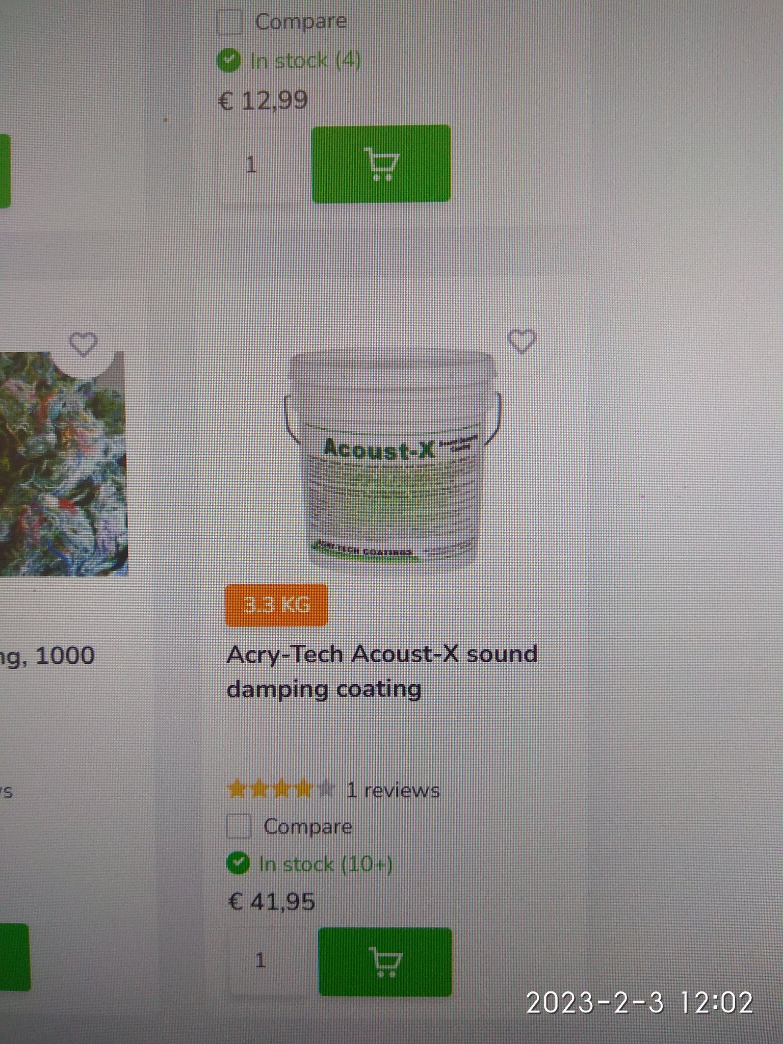

In Greece market it is a new sound absorbing material.
This in photo.You can paint speaker walls(internal) using this and place the mineral wool after this.
I think that two materials are equal.
What would preferable,one of this materials,bitumen pads or nothing?

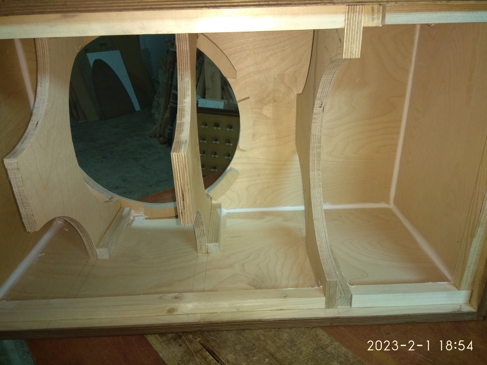

Bitumen pads will change the resonance frequency of the panels due to added mass to a lower frequency. I think that at lower frequencies, more energy would be needed for the same amplitude if energy is the same, so this also reduces the resulting linear distortion of the amplitude response. They add virtual stiffness, the panels behave as if they where thicker due to mass. I assume (without looking it up) that Acoust-X is fulfilling the same role, applying weight to a panel. I assume bitumen/alubutyl-pads are superior in this role.
Asathor is a closed box? Then, bitumen pads and lots of rock wool are the proper combination. For ported enclosures, you cannot apply as much voluminous damping material because of the port function. In this case, the walls are covered with felt, under which bitumen-pads might be applied if needed, and some selective infill material is applied to diminish major standing waves without blocking the port.

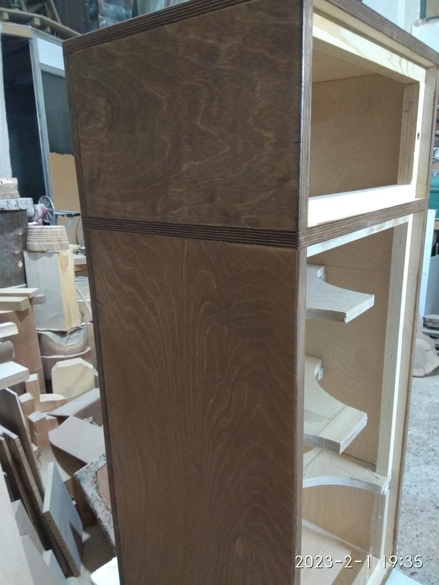

Hi Guys!
I have always been fascinated by the large monitor speakers from JBL. Unfortunately, these are not cheap, so I wanted to build something like the 4367 myself.
http://www.newaudio.it/JBL/4367 JBL (1)/JBL Synthesis 4367 White Paper.pdf
15 "plus compression driver / horn was given. So I started looking for suitable drivers.
My friend Nico Germanos from Quint-Audio, Germany gave me the tip to test the new Tymphany DFM drivers and sent me a pair.
Since I don't have many horns to test, I immediately sent the drivers to my DAU buddy Christian. A few days later he sent me the measurements on the Monacor MRH-200 and I was amazed. Nico was right, the Tymphany DFM-2535s run great.
Since the MRH-200 is quite expensive, I decided on the almost identical Celestion H1 9040-P, which costs only a third.

The damping material is just fine. Cut it to pieces that are just a little larger than the space you want to put them, so they stays in place. Fill the box completely, but do not compress it. If some places are not completely filled, do not care. This is no job that needs ultimate precission.
The damping paint is some cheap water based product sold extremeyl overpriced. It should be effective, but it looses a lot of wheigt when dryed out. You could just as well take car body undercoat, the type that comes in large can's and you screw a simple spray device on, powered by compressed air. This is much better to apply and serves the same purpose. These come in water and solvent based form. Takes only half a minute to empty such a can.
Be sure to let any water based product completely dry out before you close the cabinet or the magnet gap of the speaker will develop rust and block the voice coil. In most speakers the internals of the magnet assembly are not protected against corrosion, sadly. If using solvent based, let dry for at least 24 hours, too. too. Paint thinner may otherwise destabilize glue and plastic used in the closed speaker.
If you use any a water based coating, better prime the inside with some water proofing material. This will prevent the wood to absorb water from the coating which may get trapped for a long time and finally will make the wood crack. A single, generously applied coat of wood floor varnish is cheap and effective.
If you decide to take self adhesive bitumen pads, such a primer prevents them from falling off after time, as it ofthen happens on raw ply wood.
If you decide to use this convenient spray stuff, use it outside and protect the visual wood from overspray. Apply serveral coats with a little time in between. The resonances occur on large panels, so there is no need to fill any corner.

I appreciate your effort to help.
I agree that water based materials should be avoided.
