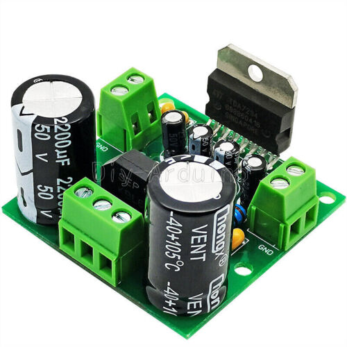

For a first please (!) do not use an amp. Level matching is quite complicated and one mistake will blow your sound card. Which is especialy bad with a laptop. The "ARTA" measuring box has parts build in that prevent such mistakes, but the simple wire/ resistor jig is a potential sound card killer.
Only use the headphone out, you can not damage anything that way.
Results from high (with amp) and low level (only soundcard) measurements will be quite similar. If you have very large, high excursion sub woofer speaker, they may not move enough to give a typical result, but a "normal" speaker with good efficienty like yours will measure just fine with low level. Keep the noise level as low as possible while measuring, otherwise the speaker acts as a microphone and give erratic readings.
Later, when you have a measuring box or do SPL measurements, you should add an amp, but for now it is much better the simple and inexpensive way.
If you want an amp, later, consider building one your self from a cheap ebay module. For limited output level you can even run it on batteries, which has some advantages. A very nice one is a TDA7294 Amplifier Board, cheap from ebay (10€) or some other medium power AB chip amp with dual supply voltage.

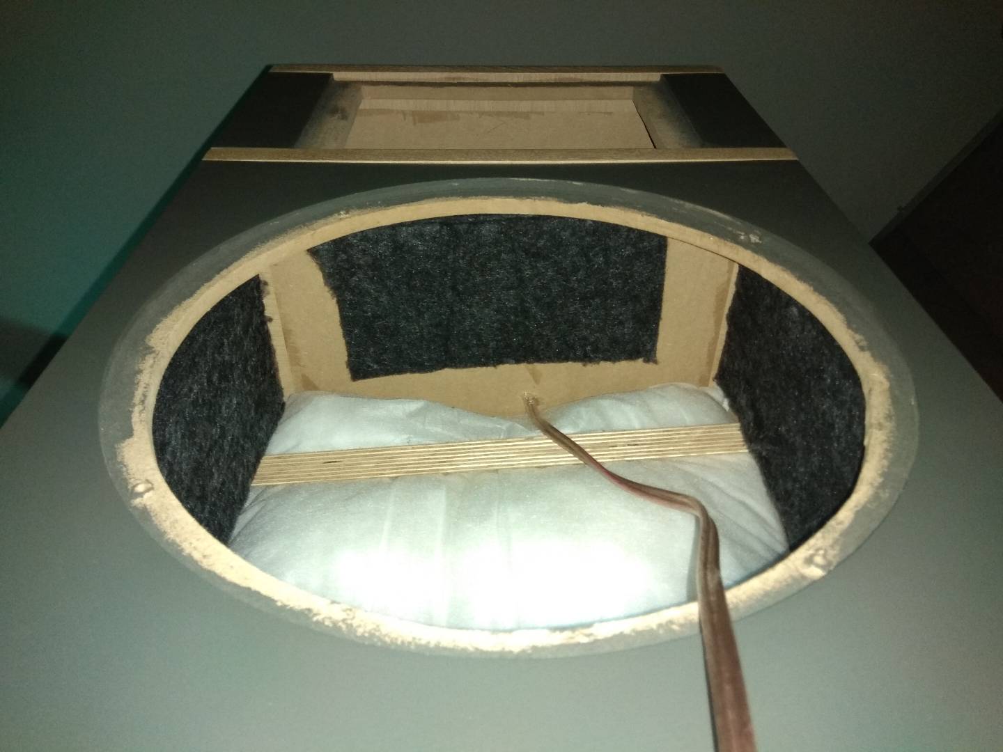

I have found another picture here, how it looks with me:
This is how it looks behind the woofer, below it the cabinet is loosely filled.
You can use your mineral wool if it is not harmful, no problem.

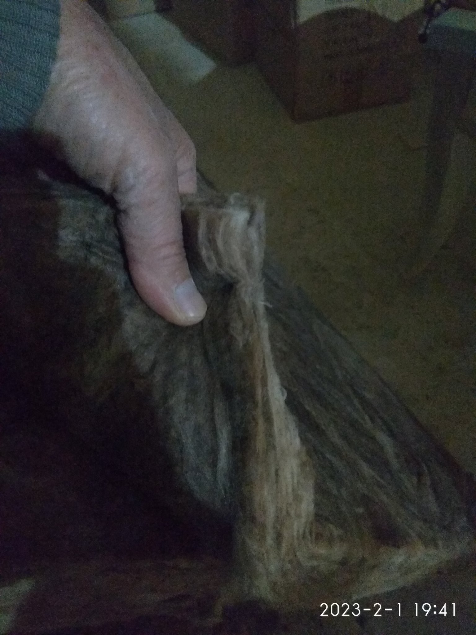

Thanks Resse66,I will try to post some clear photos when I'm ready with damping.Mineral wool isn't harmful according to Knauf specs.
Thickness is about to 50mm.
From what I can see in your photo a thinner material used there?🤔
Please feel free to comment 🙂
I have an minidsp UMIK1 on hand now,but it is the first time that I will use this.
I don't know how this would be helpful for damping process.🤔
