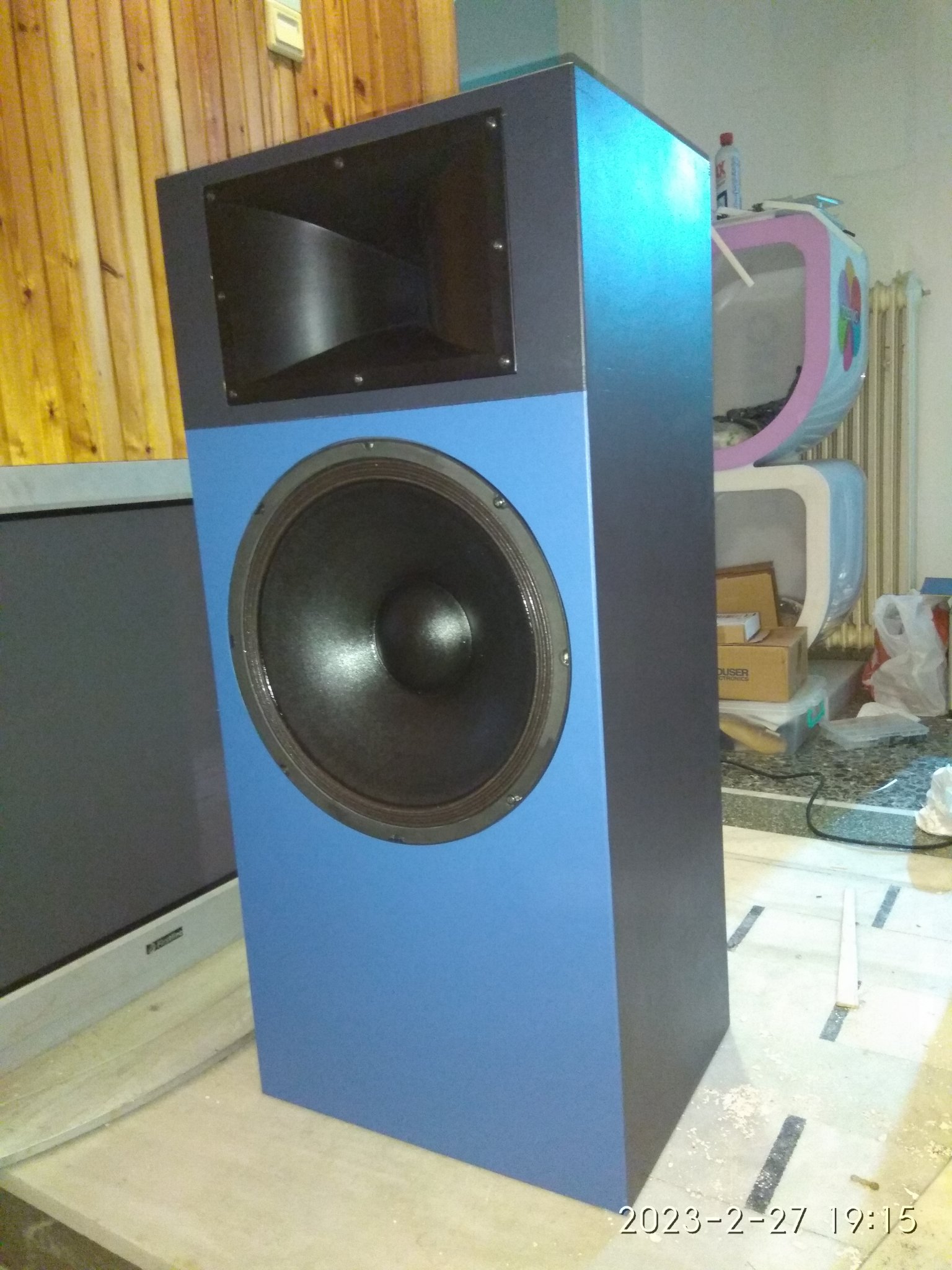

Thank you very much!Rese66 thanks for the confirmation and congratulations for the project. Have you ever evaluated a similar project but in bass reflex with smaller diameter speakers?
I have actually already thought about all possible alternatives in the size. For example, there is a small box with 8" woofer and smaller horn also from LaVoce called Azrael:
https://www.der-akustische-untergru...-projects/azrael-power-hifi-top-mit-pa-genen/
At the moment I'm working on a 12" top that includes a Beyma woofer and an RCF tweeter called Samael:
![1672331444607.jpg 1672331444607.jpg](https://www.diyaudio.com/community/data/attachments/1051/1051451-81113dbadefd5b57438b9ad3532560ae.jpg)
But both speakers are designed more as a top in combination with a subwoofer.
However, my good friend Alexander has created a great speaker with two 8" woofers and horn - also from LaVoce - called Alta Voce:
https://www.donhighend.de/?page_id=8971
I can recommend this speaker to anyone who finds the Asathor too big. And you do not even have to make compromises in terms of efficiency and low frequency response. A really great speaker that has no weaknesses and declassifies, for example, a Klipsch RP-8000F.
the alta voce speaker that rese suggested is 95 dB efficient, very much so in other words.@Rese66 . the proposed projects are interesting. thinking about it, however, I am oriented towards your project if only for its efficiency. as I said, I was looking for a high-efficiency speaker to match my tube.
