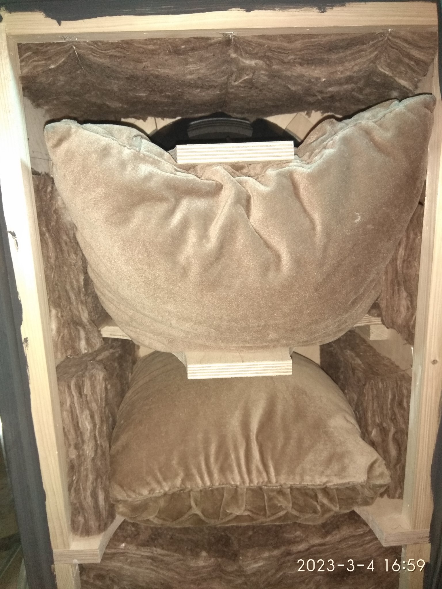

A little more damping can't hurt. I would add a little more material between the lid and the upper strut and on the rear wall.

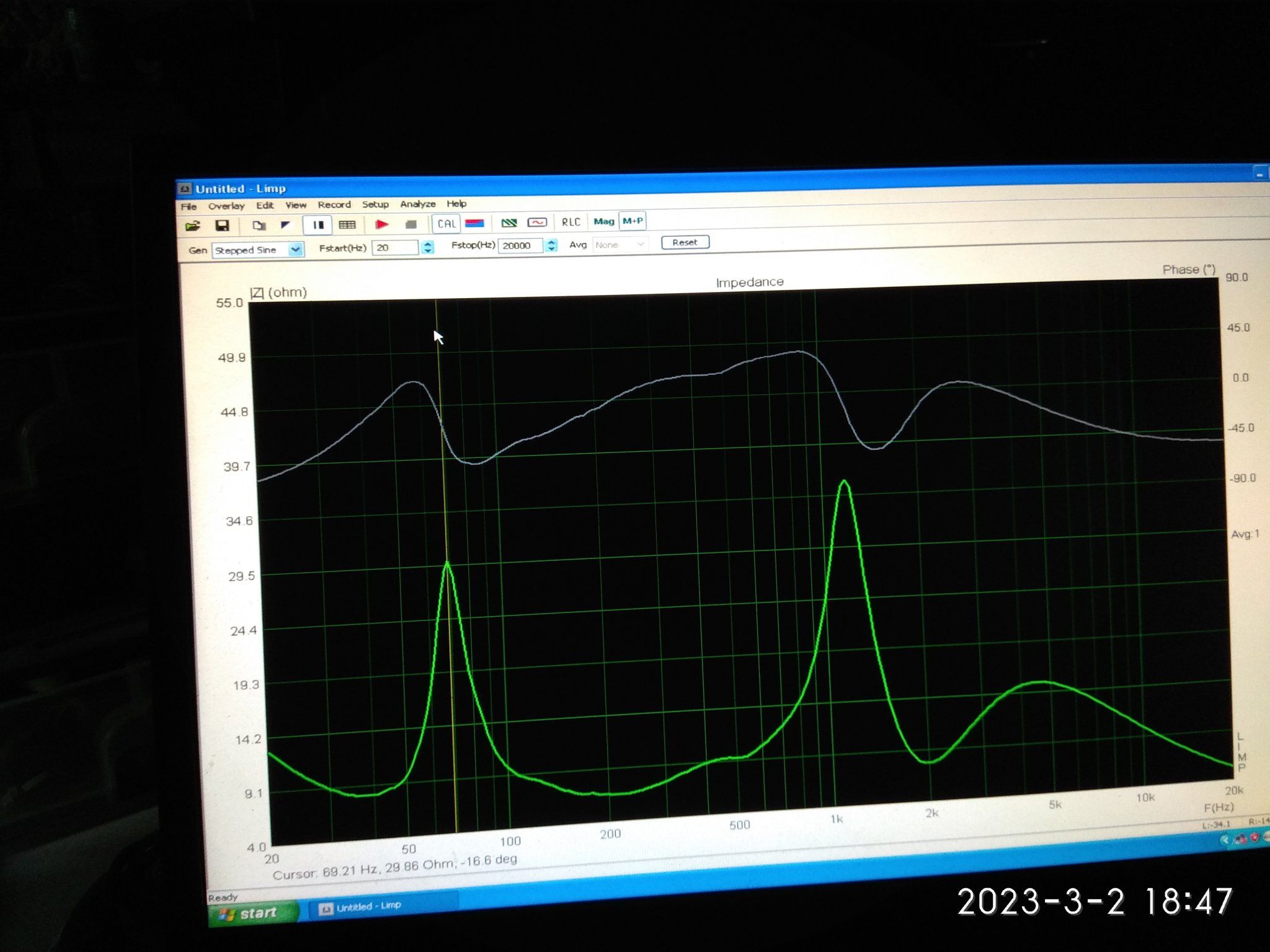

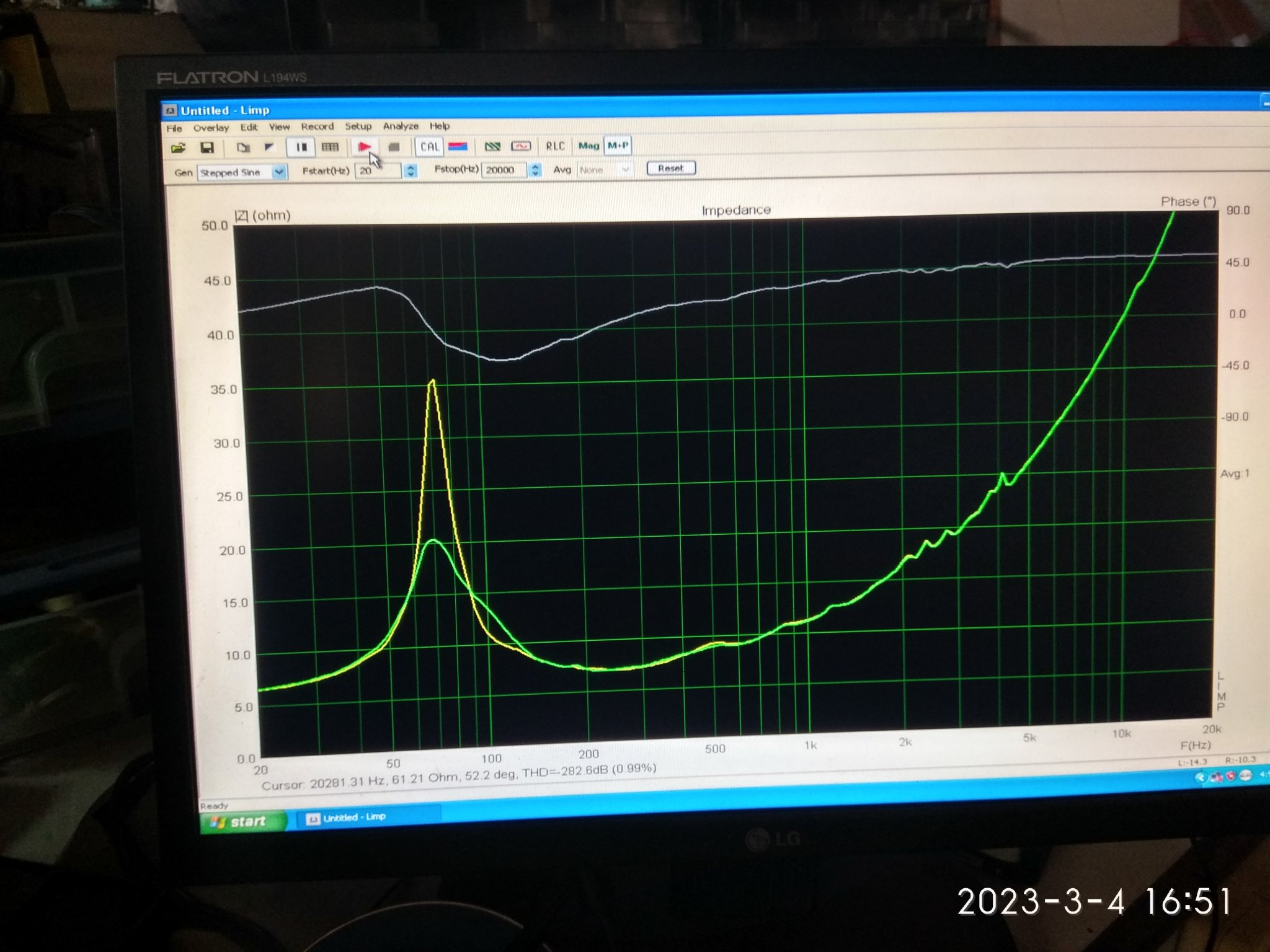

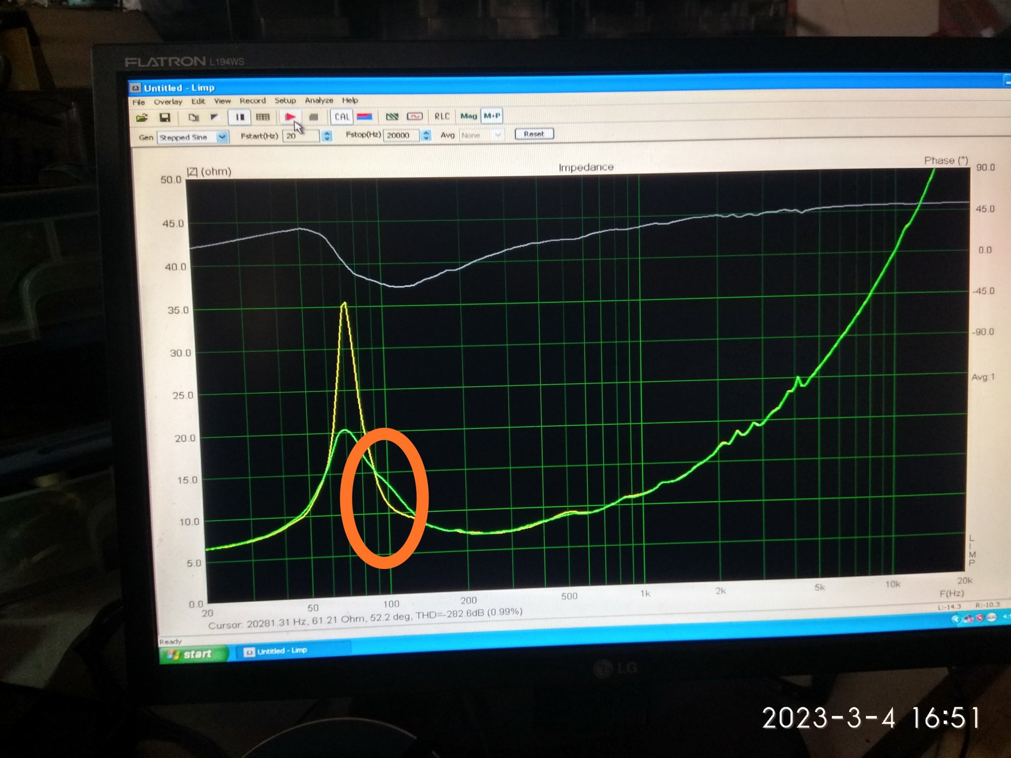

I'm thinking that the woofer impedance still looks a bit 'wobbly'? I think a good way to see what the box resonances do is to measure the woofer impedance in and out of the box and overlay the two to compare.Here is the impedance plots in the cabinet with damping material BUT no crossover connected.
Now I think that is clean ,the second impedance peak at 1.174khz is a crossover result.
EDIT: Sometimes it's even possible to enter the internal box dimensions in some 'room mode calculator' (lazy way) to find what dimension is causing the resonance at a specific frequency. I think usually the longest dimension is the most problematic, especially if the woofer is close to one end of that dimension. Can take a lot of damping to take care of that lowest resonance. Also a lot of damping on the wall behind the woofer is usually good if the woofer is playing up in the midrange.
What I meant is if you use the overlay function in ARTA/LIMP (you see it in the top menu) you can do one measurement out of the box, set it as overlay, and one in the box and easily see the difference, preferably with the woofer measured directly, without XO.
Usually I just have the box laid down on it's back with the woofer up when I play around with stuffing. I don't even screw the woofer in, just hold it down with my hands when I measure, and them lift it up to change the stuffing in the box, and measure again. All the time with the free air impedance as overlay to compare. Makes everything a lot quicker and easier.
Looks like there is some ripples in free air too, so maybe the damping in the box is sufficient in this case.

I will try to add some wool pillows inside the box and measure again

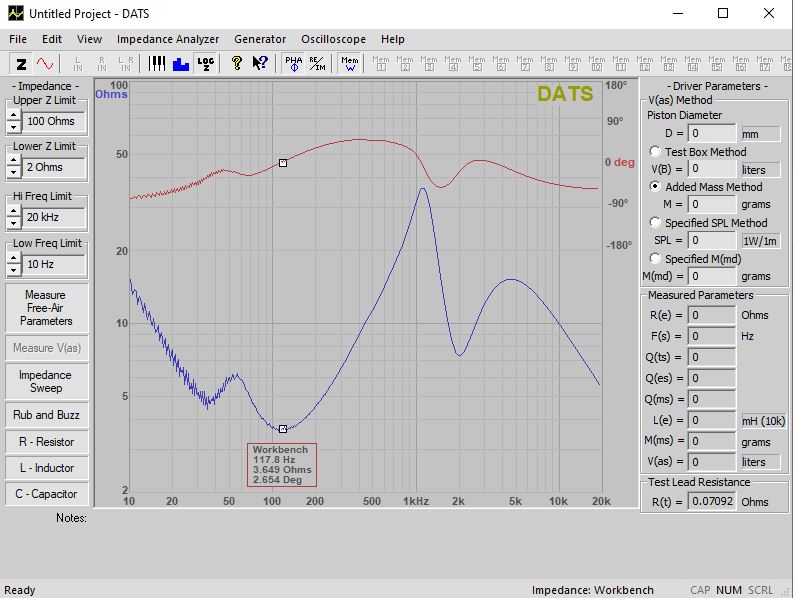

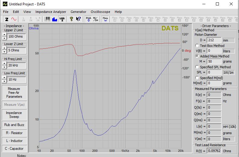

Yes, this is my measurement, but that of the complete speaker.
DATS V3 unfortunately has a problem with the GHP principle, so the measurement in the bass looks strange.
I just measured only the woofer, once with and once without Xover. I have bridged the 560µF cap here, so that DATS does not measure strange things again.
And yes, the woofer should be placed as it will later be mounted in the box.

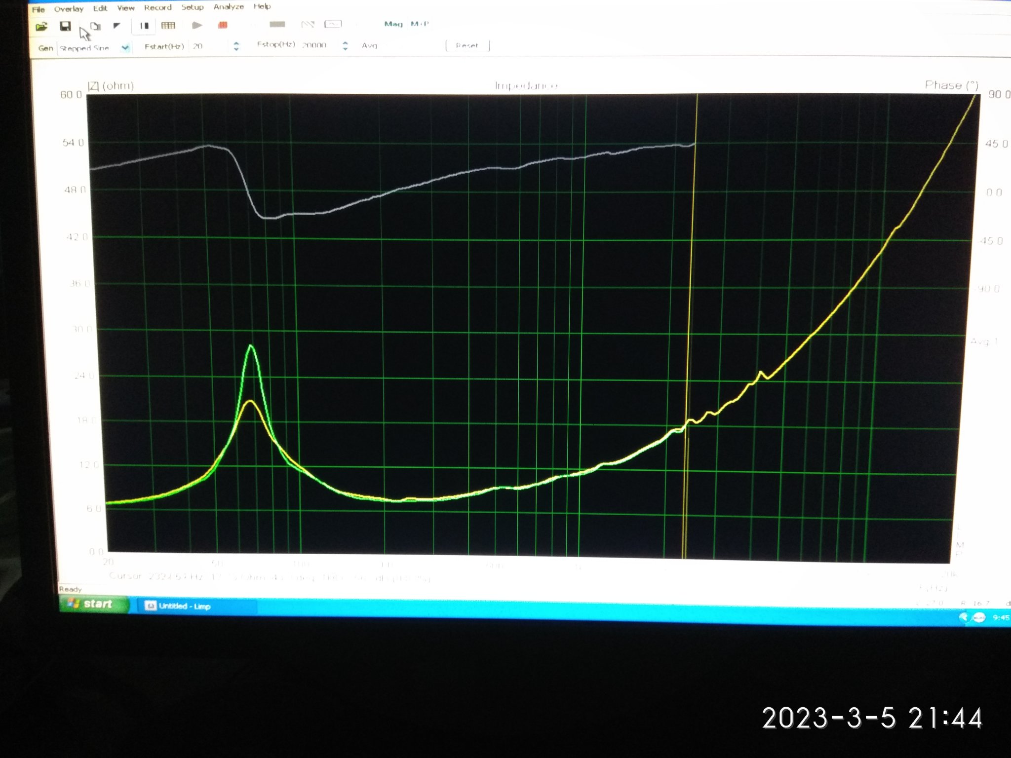

The pillow behind woofer removed.
Yellow plot is before,green is after pillow removing.
I have also run a burn-in 30hz 8v RMS for 12 hours.
I can't see a difference after the burn-in.
Speaking for damping,what you prefer?
The yellow or the green plot?
Any other suggestions acceptable.
It's not as obvious as I hoped. My hypothesis was that the pillows caused separate resonance chambers causing two resonance peaks. With one pillow I hoped it would just be one. Although it lowered the second one, it didn't remove it.
