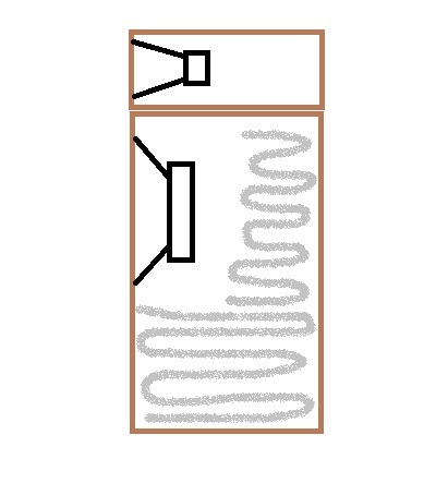

Thimios, don't worry too much. If the area under the woofer is filled and also behind the woofer on the back wall about half the depth of the cabinet, then all is ok. Like in this sketch:
I pasted the bare walls next to and above the woofer with leftover pieces of an insulation material, but you can also just put a layer of the mineral wool here and not have to buy extra new material.

This is exactly what you have to do,You should see resonances in the impedance curve of the empty box and how they disapear if you add damping material. The best point is found if additonal damping does not lower the resonance frequency any more and/or all small resonace peaks are gone. If the resonace of the box rises, you have used too much wool. This is theoretical, in practice a loose, complete fill will be just perfect.Turbowatch2,would be useful if I will provide a free air impedance measurement at first,and another one in an empty (no damping) enclosure?
As a last, use a large square sheet of wool and place it behind the driver. This is to prevents loose pieces of damping material to touch the membrane.
This is not rocket science, don't spent day's on it!

An impedance measurement usually shows the interference better, since the room almost always plays into the SPL measurement. In principle, however, both methods work.If I well understood,no need of impedance curve.
Just an inbox SPL measurement (no damping present) and another one after damping placed inside.
But as I said, you don't really need any measurements if you set up everything as described.
