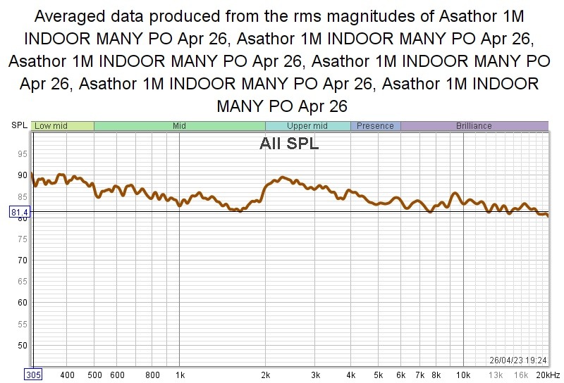

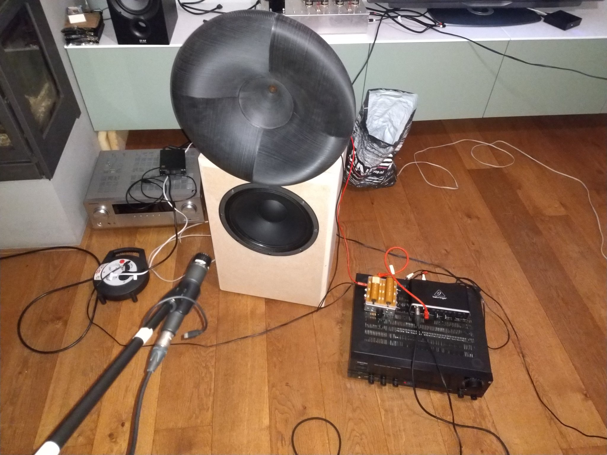

Here is a new indoor average measurement with the UMIK1 at 1m in multy positions on axis & off axis .
Smoothing 1/24.

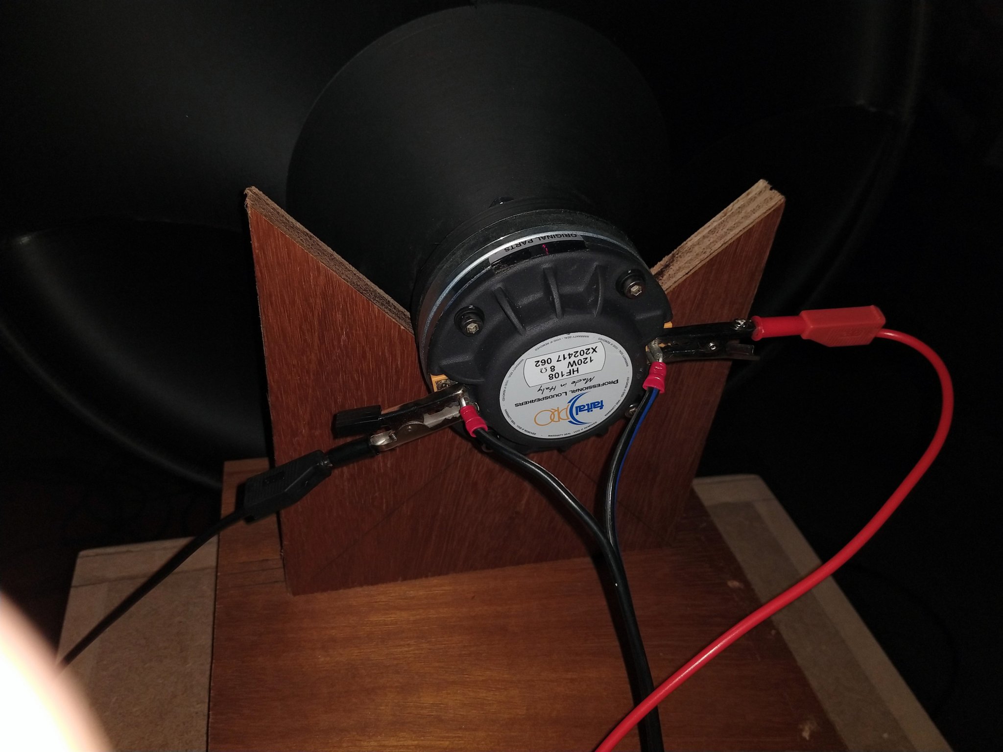

For electrical mesurement as Tom K. suggested, you can leave the speakers connected and wire the ADC (Soundcard in) in parallel with the speaker, so you have the same resistor value at the output. This shows you the voltage at the speaker, which can be quite usefull. Do not turn up the amp too much, most soundcards have a 5V limit. So an input voltage (input of x-over) of 2V RMS should be fine, Measure with a generator frequency around 200 Hz, use the AC setting of your multimeter.
The clamps are attached in parallel to the driver:

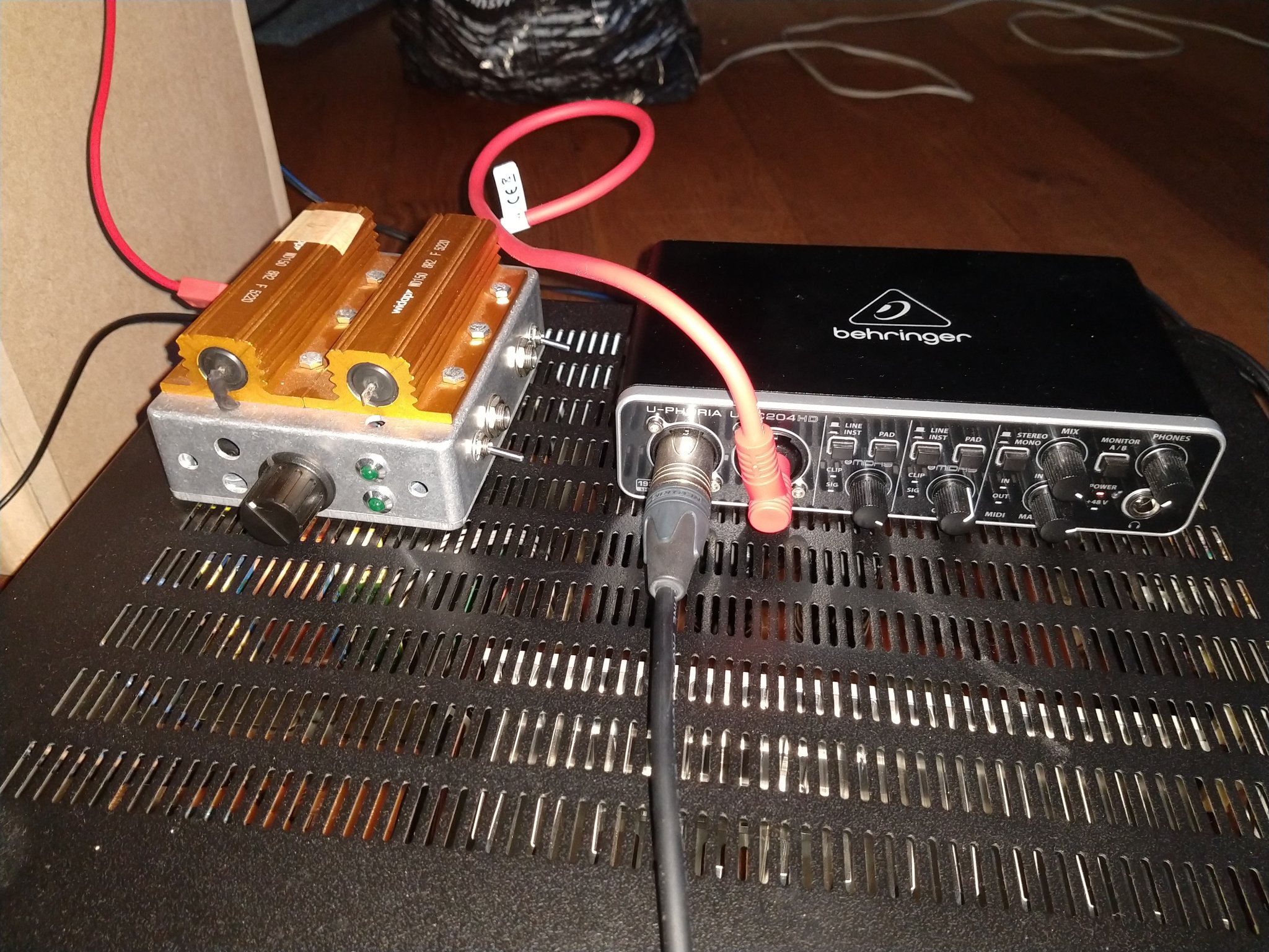

Which is then attenuated and limited in the aluminum box with the large 'gold' resistors (which are out of the circuit). You don't have to have that if you keep the level low enough.
Then the signal is going into the USB audio interface:
Input 1 is an actual microphone, which is not necessary. The second input is the signal across the driver.

It allows measuring the driver only as the driver input is taken as a reference. That is what I was doing when I took the pictures btw.
The software is just REW. It doesn't care if the signal comes from across the driver or from a microphone.

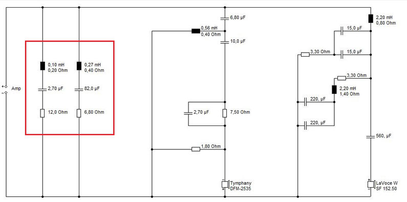

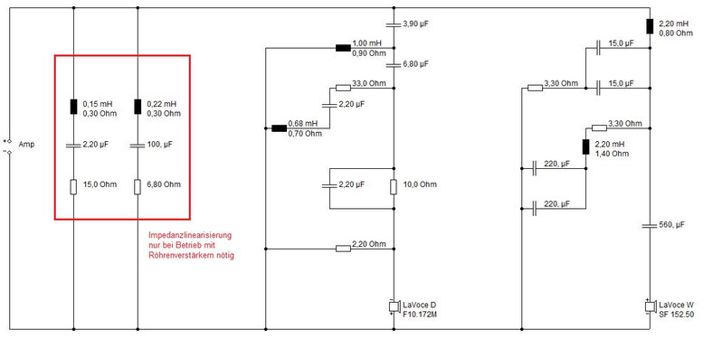

I think that i found the problem....
I have used the LAVOCE DF10.172M horn driver with the wrong values crossover parts!
First picture is crossover parts for the LAVOCE horn driver.
Second picture is crossover parts for the Tymphany.
Of course, that explains a lot.
