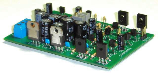

Since I used an existing board some things were fixed, there are two 12V regulators (LM7812/7912) on board and caps are 1000 uF on the input and 470uF on the output decoupled by 47nF.
I never use star ground but only ground plain on both sides of the board, The board is small and fits inside a heat sink pipe. I use a virtual ground and the power supply is remote, 28V switch mode almost identical size to the HP amp box.
I did not want to change the LTP transistors because I favour 2SA970 and output transistors also because I favour BD139/140. The 50 pF (actually 47pF) I used a SMD under the board. My design used diode bias and has been running stable for three years, there is no problem with this config.
I am not absolutely sure how to insert pictures with the new forum but if you tell me I will post some pictures of this amp.

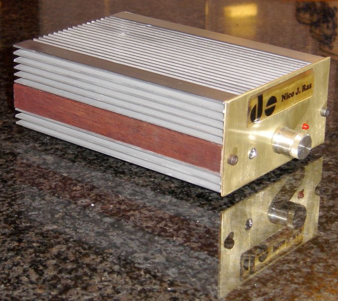

I am trying again, sorry. What a rigmarole to attach pictures!!!!!!
Things that I would have liked when I did this one originally:
1) Pot was PCB mounted instead of wired.
2) HP socket was PCB mounted
3) LED was PCB mounted
4) Input sockets were PCB mounted
5) Power input socket was standard wall wart type and PCB mounted
6) Had a PCB mounted cross-talk pot
7) On/off switch was PCB mounte
Mounting the transformer on the PCB as well would complete the amp and making it a wiz to build. Wiring is a pain in the behind and one should design a DIY boards that are fully functional without having to make a single wire connection.
In my opinion only
Regards
Nico
Nico,
Nothing wrong with your opinion...... quickly, arrange the altar, Nico, you stand on top!!
I thank you for sharing, and yes, you have very nicely attached the photos, very good ones too!!
