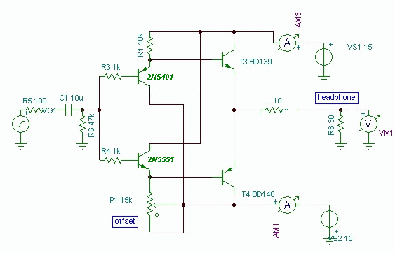

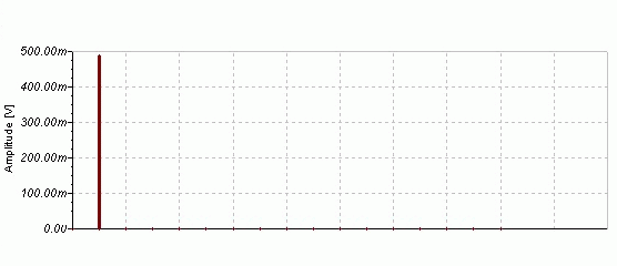

Hello
For those who want to use the crossfeed.
Here is a diamond buffer simulation circuit with its distortion spectrum. I's a simple circuit, so there is place to improve it.
I have choosen BD139 and BD140 for sim purpose but you can use better transistors.
The bias are 40 ma.
Bye
Gaetan
The bias are 40 ma.
Bye
Gaetan

Hello Hugh
All ok, I have done a diamond buffer for those who want an alternative to the opamp buffer from the Jan Meier's design on Headwise.
As input volume control, the one you suggest in your Aspen FAQ web page should work good.
Here it is for those who do not seen the page:
"A linear 100 kOhm pot with a simple 15 kOhm resistor from middle terminal (wiper, or centre; output) to ground. The 47K input impedance of the AKSA combines with this resistor to give around 11K4 from wiper to ground. Signal input is taken to the top terminal, bottom terminal is earthed, and the middle (wiper) terminal is then taken to the AKSA input."
I have others projects runing, but if I can I will try this Aspen headphone amp.
Bye
Gaetan
