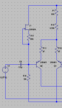

There is one thing I want to make note of. A Jfet current source has somewhat poor PSRR, but it adds plenty of H2. Recall the input bias configuration I used. It actually increases H2 in the simulator. Should we try it?
- keantoken
I have played with some simulations (my Harry 77 thread) using a JFET in various locations to purposely increase H2 and/or to emulate triode-like distortion effects. It's a nice method and the JFET is a very interesting device, having a different characteristic than all other active devices. My favourite trick in the Harry 77 amp was putting the JFET into the nfb loop.
What I found in the sims was that adding H2 in a multi-stage NFB amp is quite difficult - because it invariably results in increased risk of IM distortion at higher signal levels. I did some real DIY experiments with my TGM1 amplifier (another thread) although not with the use of a JFET for this. The higher H2 gives a nice sound, but when I crank up the volume it gets muddy pretty quickly.
It would be risky to include it in this headphone amp without prior experiments simply because it's a one-shot chance at the pcb. If Hugh prefers to keep it clean all is not lost since you and I can butcher the pcb with fly-wires and try out something along the lines you have suggested

The Jfet is not at all in the feedback loop. I think it is perfectly safe here.
- keantoken
sorry, I didn't explain. I was saying that in general, I like JFETs and I like the application of them to controlling H2. And that I had tried it in a NFB loop, I realize you weren't suggesting that here.
I think your suggestion for the bootstrap take-off point is the better approach. It might be worth playing with the relative values of the bootstrap divider resistors to see if we have them optimized, I haven't looked at that at all yet.

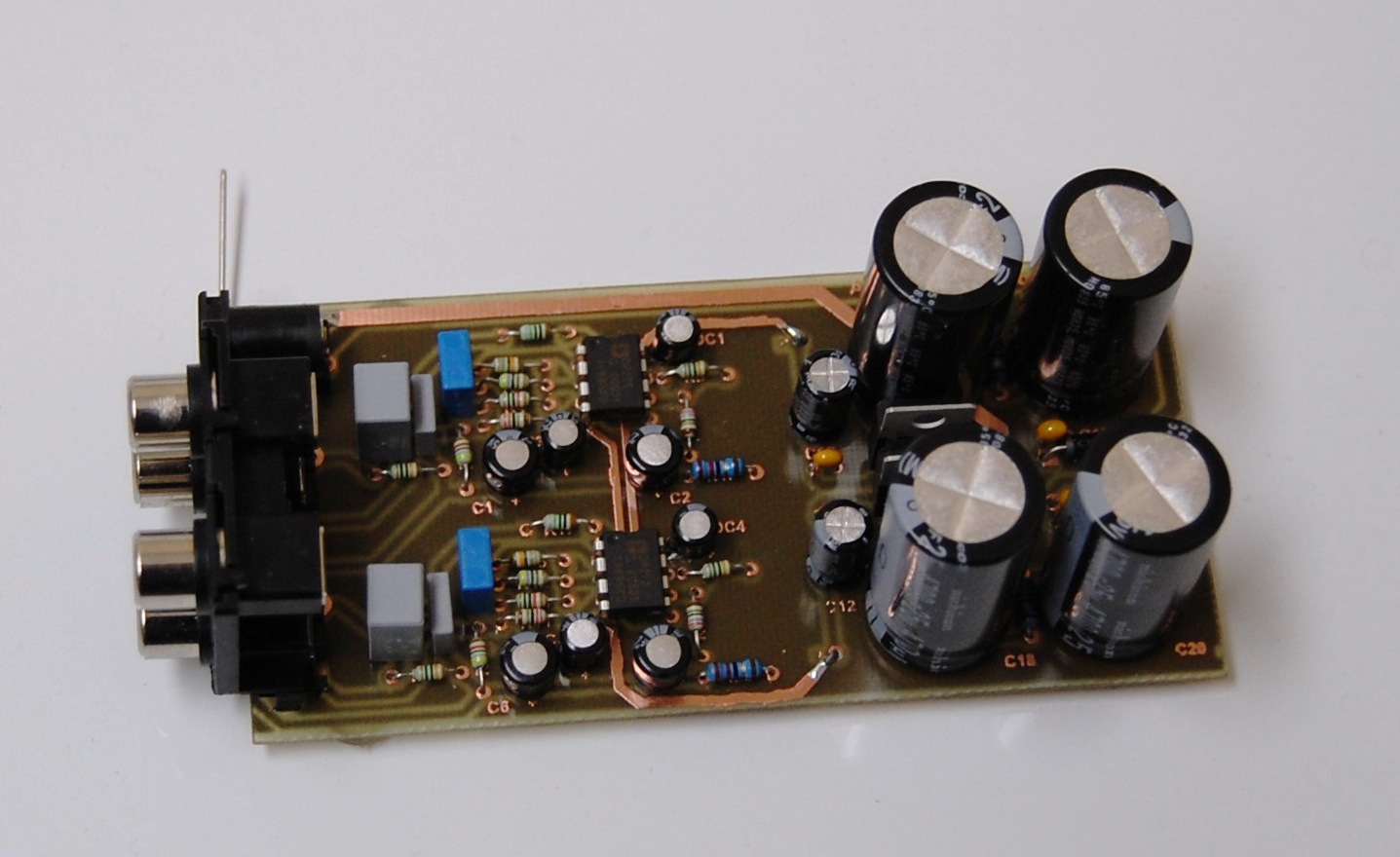

Edit: here's a nice all-on-one pcb headamp to give us some ideas about construction...
http://4.bp.blogspot.com/_ZVgJtItVg..._WnQ/s1600-h/High-End-Headphone-Amplifier.jpg

In my current simulation I have the modified bootstrap point and the Jfet in place. With this combination, H3 is about 25db below H2. I was suggesting this in addition to the bootstrap.

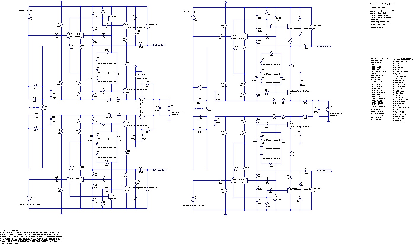

I have updated the model to show both channels. I doesn't show the optional NFB take-off point yet but I have added the cross-feed. It also needs an LED power-on indicator.
I've got two versions, one with cap multiplier and one with CLC. To get similar performance from the CLC I had to use 330mH on each rail. I could use larger caps.
The CLC is a bit cleaner. BUT my sims show something strange going on sub-10Hz, some kind of oscillation due to those inductors.
Model is attached...
Keantoken - I agree, nice to have H2 higher than H3, but even with the model I have attached, this seems to hold true. I really don't know how important the relative heights of H2 vs H3 are. Potentially this needs some prototyping to find out as the sims only go so far...

You should include Hugh's input bias decoupling in the schematic. (I'm sure we're all agreed on this?)
