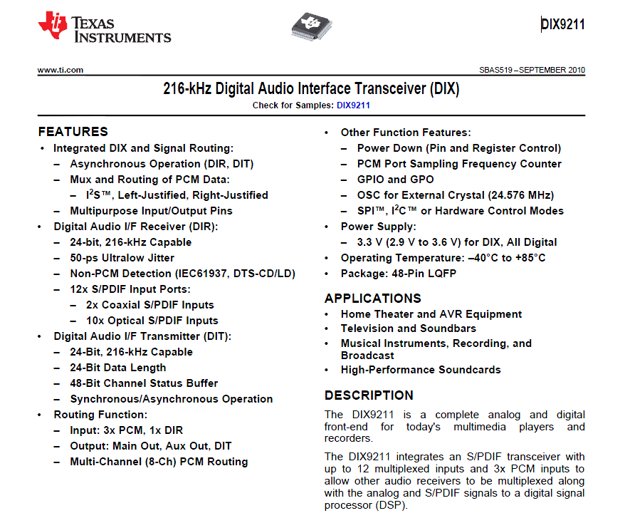

DIX9211 is a dedicate digital audio interface,
PCM9211 comes with stereo DAC integrated

the DIX shows 92khz not 192 and the pcm shows 209
DIX9211 is a 216KHz digital audio interface with internal DIR and DIT independent from each other.
One of the best performance I can find. But a bit difficult for DIY. Because it needs software control by SPI.

Shouldn't be a problem with HifiDuino
Shouldn't be a problem with HifiDuino![]()
It needs to be controlled by the FIFO otherwise the FIFO needs to tell the hifiduino to tell the SPI port what to send to the DIX ...
In other words the hifiduino needs to know the datastream parameters before hand so that it knows what settings to apply.
You've missunderstood.
Ian's already got SPI working from the FIFO FPGA as I understand it. He's saying its a good performing chip but just less well known to DIYers because of the extra requirements.
My point was simply that hifiduino is unnecessary when the FIFO can send the SPI directly to the DIX.
