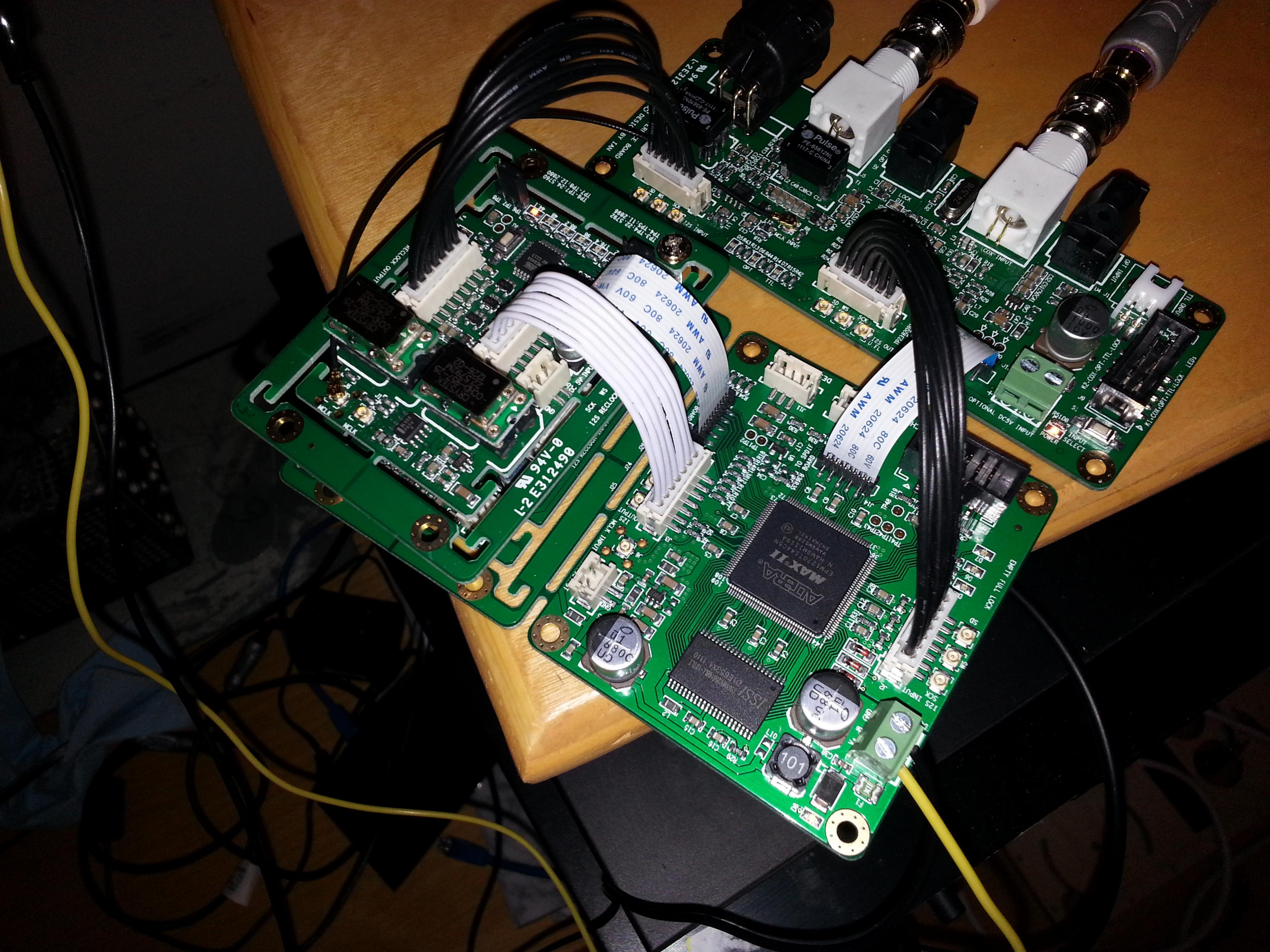

Attached are the pics

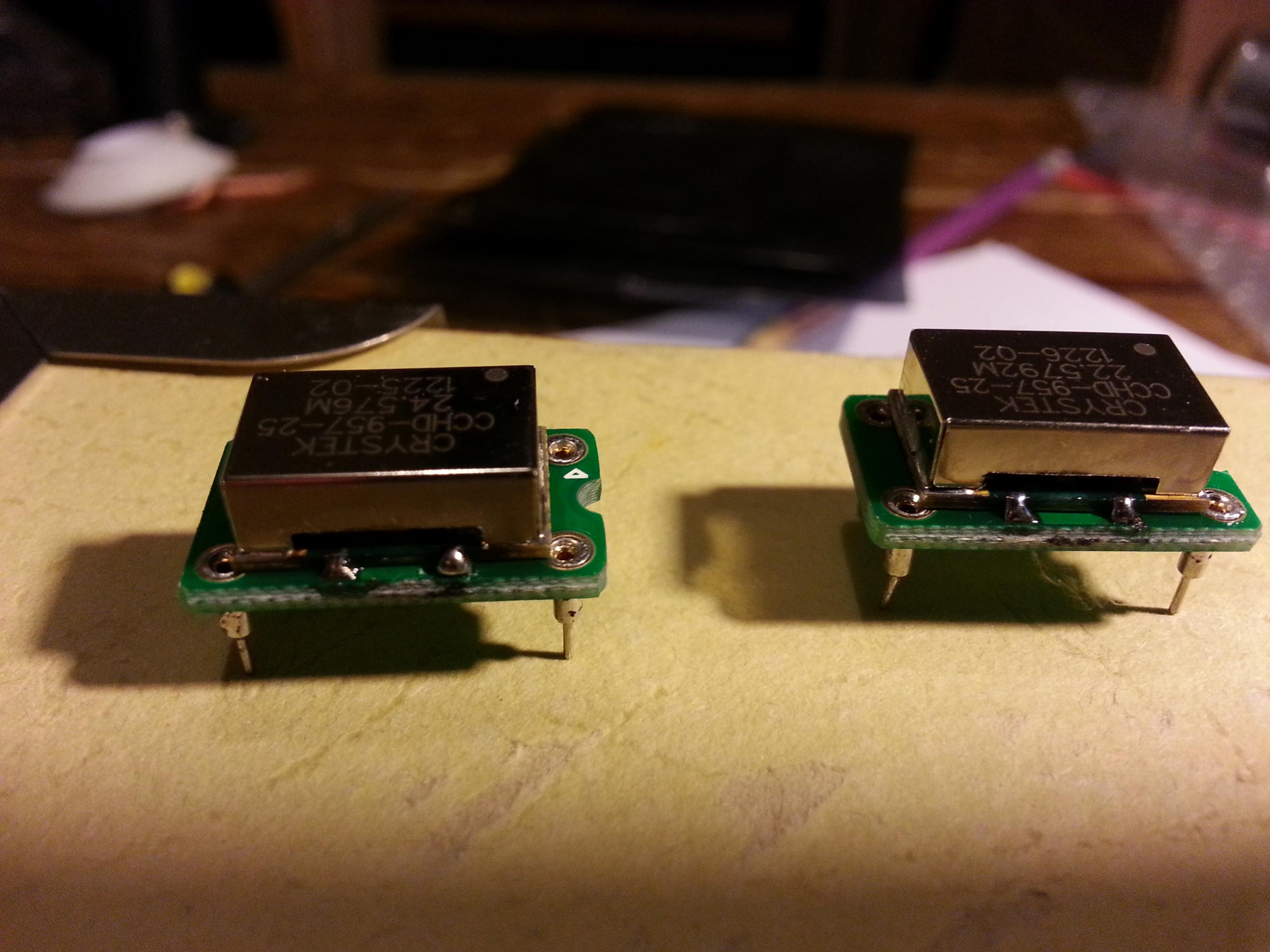

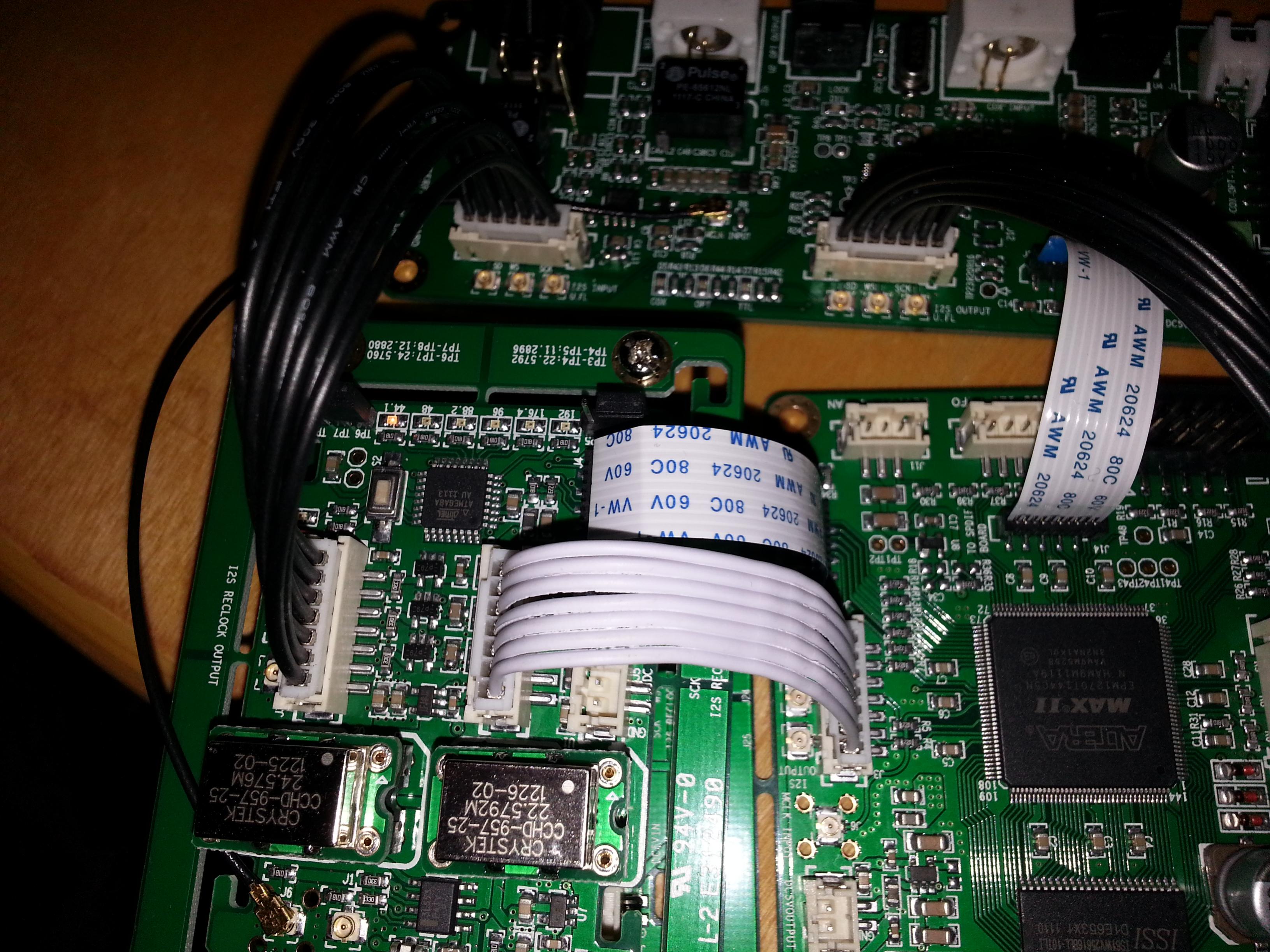

Attached are the pics for the crystek..
Pls help..
Thanks guys
You mean the original XOs work but the CCHD957 don't work? Usually it's soldering problem on the adapters. Please check if there is any dry solder, or some left flux on the pin.
Or, if there is any short on the adapter, please measure resistance between Vcc and GND of the adapters.
Vcc located at top left corner, GND on the right bottom.

Hi guys,
Thanks very much for all the help..ive put back the generics and enjoyed my music. Ill have a friend whose good with smt soldering take a look at them. Im not really skilled with soldering. I judt did a really bad job in soldering these xo. I thought i could do it.
