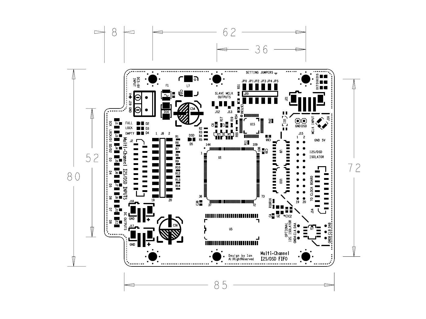

This is the MC FIFO finial version V6.0
MC isolator has already been integrated on board.
Ian
Ian
Great design! It's better design that the output buffer is on MC Clock board because the isolator board between MC FIFO and MC clock will generates jitter, so you need to re-align the data again by the buffer on MC clock for controlling tolerances between clocks.
Great design! It's better design that the output buffer is on MC Clock board because isolator itself will generates jitter, so you need to re-align the data again by the buffer on MC Clock before re-clock.
Needless to say, all signals will be relocked on MC clock board.
Yes, you are right. Finial output buffer will be on the MC clock board.
Ian

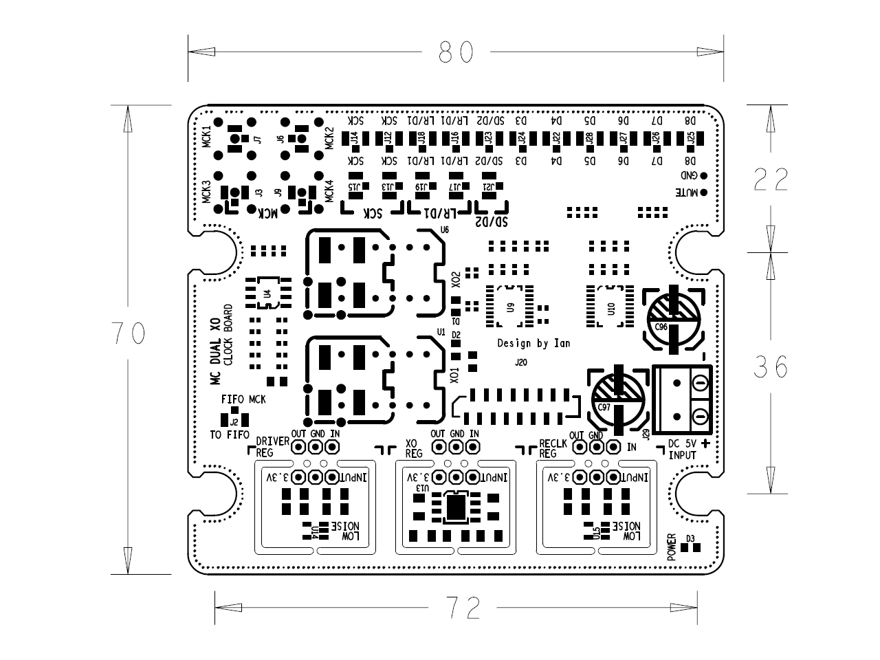

MC Dual XO update
Layout of finial version V6.0
4 MCLK outputs
4 SCK outputs
4 LRCK/D1 outputs
2 SD/D2 outputs
D3-D8 outputs
All outputs are in u.fl coaxial cable sockets only for better SI quality
Can support 4 separate DACs working at same time
Capable for 14 channels for I2S and 8 channels for DSD
0.9uV RMS/90dB PSRR/600mA ultra low noise RF LDO equipped on board for OCXO and XO
It's coming.

Hi Ian,
I confirm it sounds good at home !
Btw, assuming there is always a little jitter left outputing the Master Clock, did you have measured that one with the Crysteq 957 XO at the output of the clock board II ? What is the last source of residual jitter (I mean on the clean side) ? Flip/Flop chip? length of uf-l wires ?
How-much pico second jitter on the uf-l outputt plug (if possible to measure with your Tools) ?
Always wanted to ask as I have no idea of how it works : is it all the I2S signals (Bitclock, etc) which is re-clocked after the FIFO or the MCLK only (I ask because I use old PCM chips like TDA1541A...) (and sorry if the question has no sense as my understanding is low - no home work , I would even don't know where I could beginn, lol)
cheers Ian & thanks for all the amazing job
Edit : Has the MC Clock uf-l inputs plugs for the inputt side or flat cable only from the FIFO board ?
Hi Ian,
If you input I2S, the output will be I2S. If you input DSD, the output will be DSD.
All re-clocking will be after FIFO at finial stage. The finial jitter level is now lower than the noise floor of my LC584AXL which is 3ps. So I would like to follow the specification of the XO oscillators for phase noise preference.
