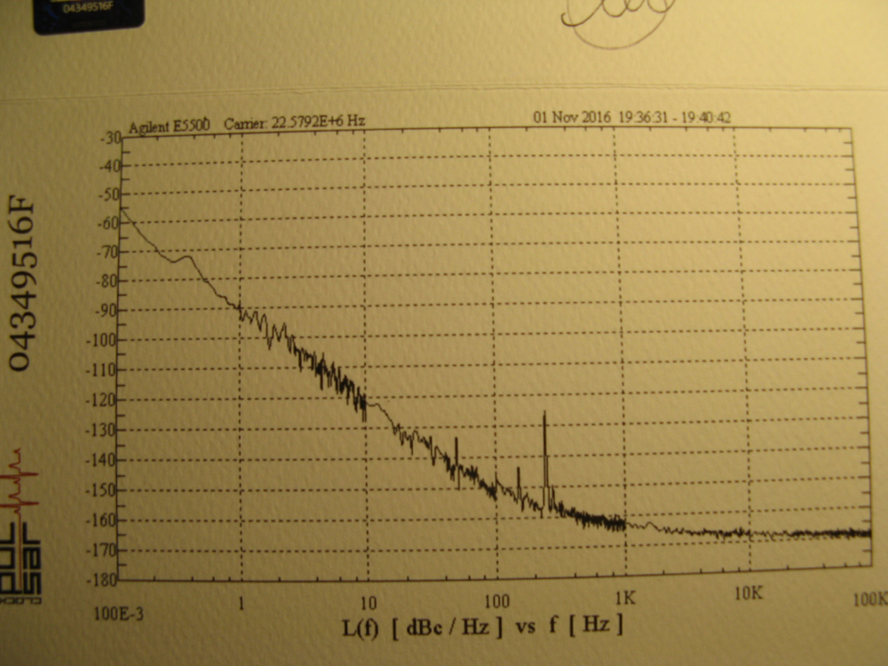

I can certainly recommend the professional service and very well packed and sorted product from Pulsar, arrived today - time to get busy.
Shane
Oh, my god! That's the real beauty
Yeah, Ian.. .you know he said he select me a 22.xxx close to 11.xxx performance.. has a few in stock. Good time to buy, costs a bit ... but in context, maybe the best value.
I know, PN looks superb. Mr. Ian can you please share with us the PN charts for your Pulsars Clocks
Thanks to Mauro at Pulsar - great guy to deal with.
Pulsar Clock & Power
Nounouchet, hello <1Hz is key, but you need to find your own bait to catch the fish!. OK, look 0.1Hz to 1Hz, naturally follows to 10Hz. Compare?.. what - nah these just sit on the shelf.
Shane.
Shane.
