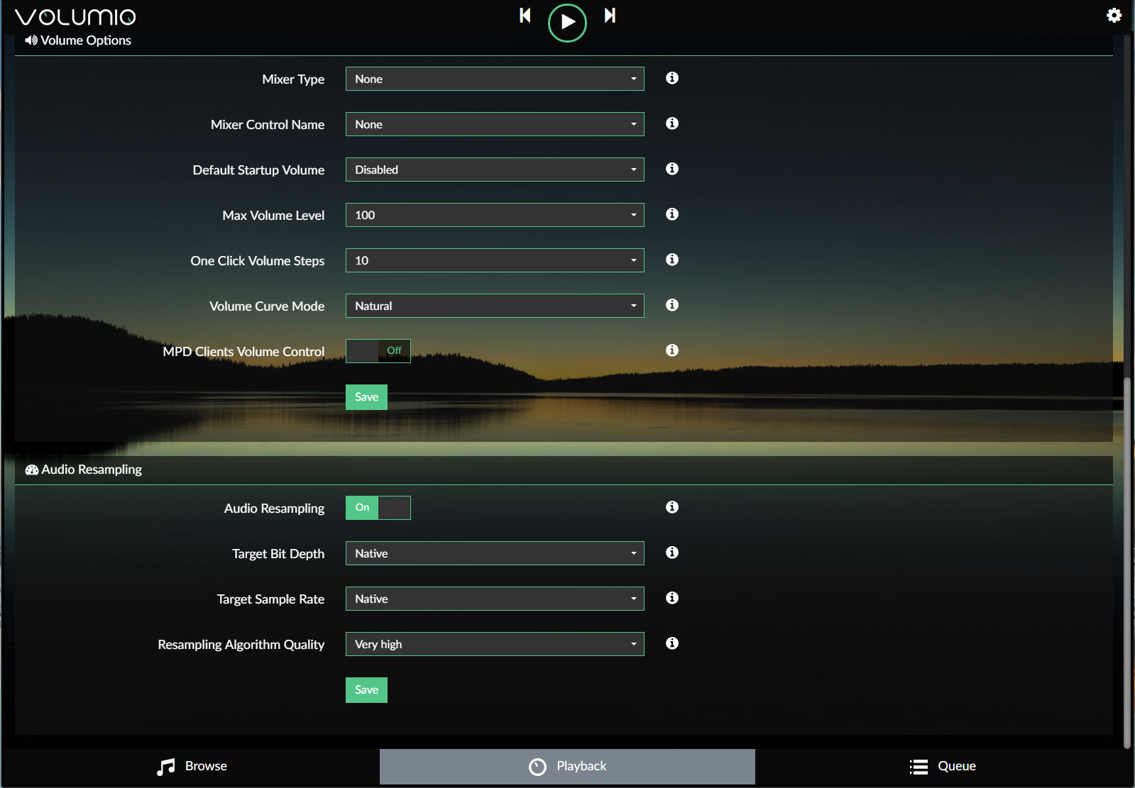

I'm running Volumio2 and I have this menu:
It looks like it's exactly what is needed to upsample everything to 24 or 32 bits.
But bear in mind that I'm running a somewhat customized version of Volumio2 (it says "System Version: 2.203") built to support the Allo DigiOne so I'm not sure that the "mainstream" builds also support this functionality.

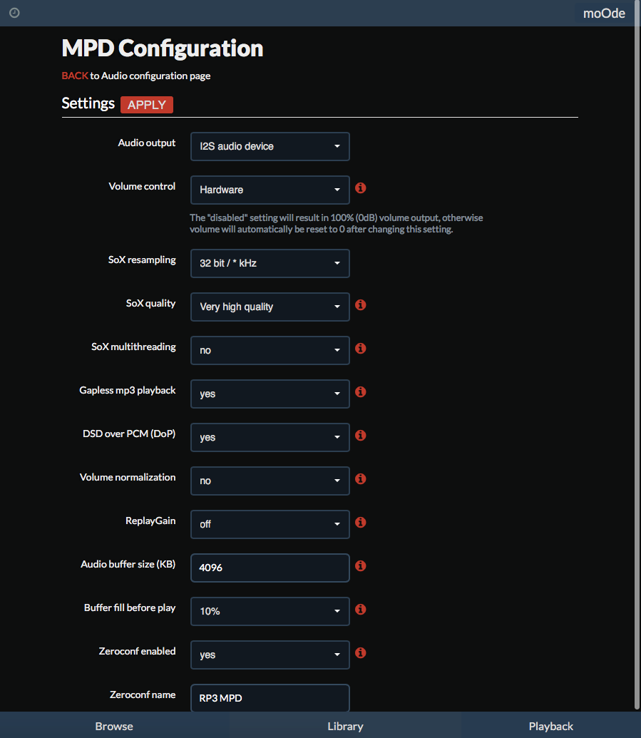

Hi Ian,
Interesting about ES9018 and 16/44. Didn't know that.
moOde supports wildcard sample rate setting. Only the bit depth is changed.
-Tim
