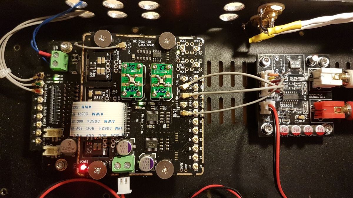

Hello,
I am implementing the McFIFO and McDualXO boards and I have a problem with the McDualXO's u. fl I2S outputs.
In fact, I obtain behaviours that are not reproducible.
As I couldn't get the jlsounds AK4490 DAC to work so I supplied a simpler ES9023 DAC without MCLK.
Depending on the LR and SD outputs used, I get:
· No sound
· A sizzling sound
· Correct sound.
But in the vast majority of cases: no sound.
If I turn off a working configuration, when restarting it no longer works.
The contacts are good (point-to-point tests).
Oscillators are good (tested on another configuration with the FIFO II and DualXO boards).
Depending on the frequency of the music played the oscillators tilt well.
The DAC ES9023 is good (used with FIFO II and DualXO cards without problems).
The McFIFO board is powered by the Raspberry Pi 3 Model B.
The McDualXO card is powered by a SilentSwitcher from Jan Didden.
-> the power supply LED is red: is it normal ? (see picture)
The DAC ES9023 is powered by a SilentSwitcher.
I don't understand what the problem is apart from a malfunction in the outputs of the MCDualXO board.
attachment.php
attachment.php
Thank you for your help.

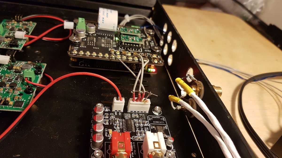

Those u.fl cables going to the DAC connector look very suspicious, have you measured the resistance between the signal and ground for each cable? Maybe there is some contact happening there under certain angles so it sometimes works and most times doesn't and FIFO II handles that better.
Some news.
In order to determine where the problem is coming from, I have replaced the FIFO II/isolator/DualXO boards of my current digital preamplifier with McFIFO/McDualXO boards (same cables and power supplies): it works.
I've tried 2 I2S DAC, both work without any problems with their respective u. fl cables et connections.
But if I change the power supply of the McFIFO card: it doesn't work anymore
Current preamp power supplies: FIFO: SMPS CONDOR; DualXO: SALAS reflektor-D mini (even 0V)
Power supplies tested for McFIFO with no success:
- RPI 3 (source)
- SilentSwitcher
with and without common 0V
I put McFIFO and McDualXO back in their case with 1 SilentSwitcher for McFIFO and 1 SilentSwitcher for McDualXO: it works on first startup and then not after restart.
Very strange...
PS: When it doesn't work led are ok on McFIFO (empty, lock) and McDualXO (XO1, XO2)
Ian do you have any idea ?
Seems like the SilentSwitcher can't provide the necessary voltage/current. How do you power the SilentSwitcher?
Also, if your source is an PRI 3 and you have connected the McFIFO power source to it (via the GPIO header) then the McFIFO will be powering the RPI 3 (even if you have it connected to USB) which requires a lot more than the 500mA the SilentSwitcher can provide.
I suspect that if you power the McFIFO from the RPI 3 it doesn't work because the RPI 3 probably provides less than 5 V under load.

Some news.
- RPI 3 (source)
- SilentSwitcher
Very strange...
