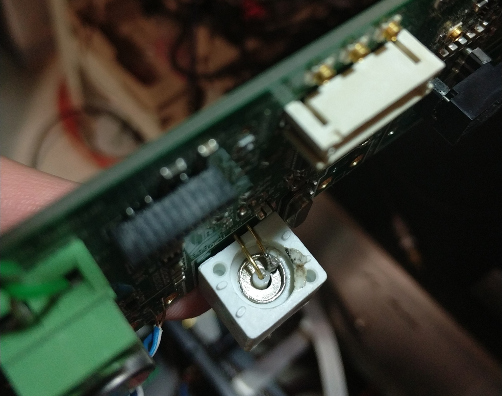

I just want to report a long time problem of Ian's SPDIF interface board. It could be your problem, too. My copy has a faulty BNC connector from the very beginning. It's not easy to get SPDIF locked by DIR. I have to plug and unplug many times to get it locked. In addition, the locked signal will lose when any electronic devices are switched on & off near by. The following picture shows what I did to the BNC connector. I soldered the ground wire with the metal shield. They should be connected, but they are not in my case. If you have similar problem, you should measure the resistance between them as I got several mega ohm reading on my copy!

Did you fixed this issue after you soldered the ground pin?
I'v never have this problem. Thank you for figuring it out.
I can send a new connector to you. Please let me know.

Hi Ian,
Yes, the issue was fixed immediately. It would be great to have a replacement parts from you. Thanks.

Please PM your shipping address. I'll ship a new BNC connector to you.
Sorry about the issue.

This can be verified by simply using a DMM. Please let us know your result. I was always suspecting the SPDIF source and trying to mod it without success. (Who would thought it would be the BNC?)
