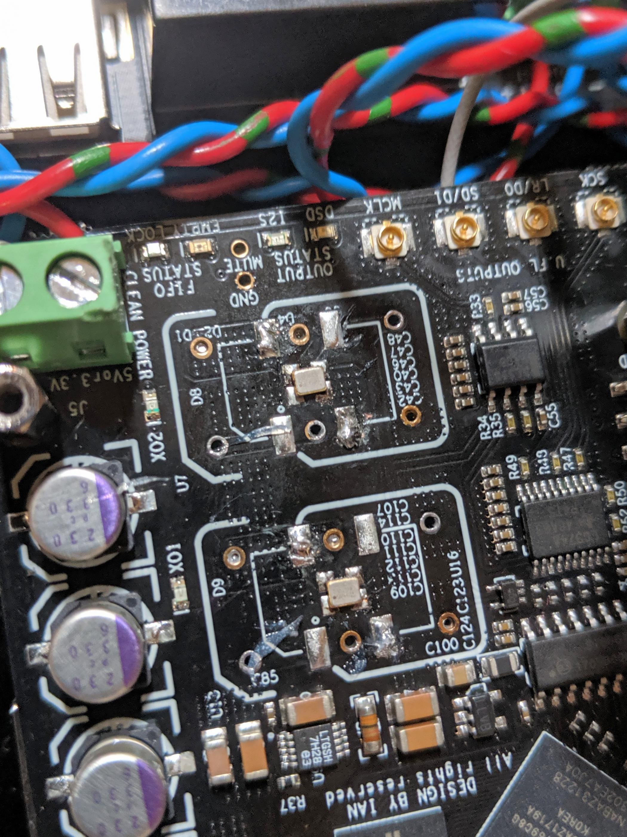

I'd need some advise. I am in the process of tweaking the FifoPi.
A friend of mine sent me a pair of these tiny NDKs for the FifoPI.
Do I recall it correctly that somebody somehow installed these tiny NDKs without using the socket plus adapter?
If so, how would that be done?
If that wouldn't work, I guess I'd need the socket and adapter.

I'm sure you know this but for clarity... the socket is already on the FIFO pcb. So I imagine that step 1 is removing the socket from FIFO. step 2 is to solder the NDK chip directly to the FIFO PCB.
I honestly cannot imagine doing all that without messing up the FIFO or losing the NDK. While there no doubt will be some last % of performance possible by removing the socket, is it worth the risk and effort? Having done this with the acko s03 I must say I really value having the socket available on the FIFO. It is so much easier to remove the adapter and solder away from the full pcb. And as soon as you get comfortable with the NDK, you will want to try something else. The socket makes this a breeze.
I hear you. I probably better get me a pair of adapters to begin with.
Do you have a pic how you've done it?
As I said, you need to be comfortable with SMD and have some magnification to do this. I broke up the adaptor socket with side cutters and took it out one pin at a time. It's just a DIL footprint so no problem reinstating it if need be.
It looks a bit gungy because I removed the electrical grade silicone I'd put on the top for damping to take the image. Don't use ordinary silicone, it will eat the components!

Ian already provided local bypass caps for the 3.3V on each clock on the underside of the board. Likely it is worthwhile to experiment with them, though @simon dart's experiments suggested it may be hard to improve on them.
BUT be warned that he has an array of what I believe are 0402 sized caps there which are difficult to un-solder/solder even if one is VERY GOOD at SMD rework.
Greg in Mississippi
Let's hope that the heatgun treatment won't lift off the caps down under.
Maybe less risk of board damage it one were to cut away the plastic frame of the socket with small diagonal cutters, leaving only the pins. Any pins that need removing could be heated from the bottom with an iron and pulled out from the top with some needle nose or similar. Or, pins could be clipped off almost flush without removing them.
