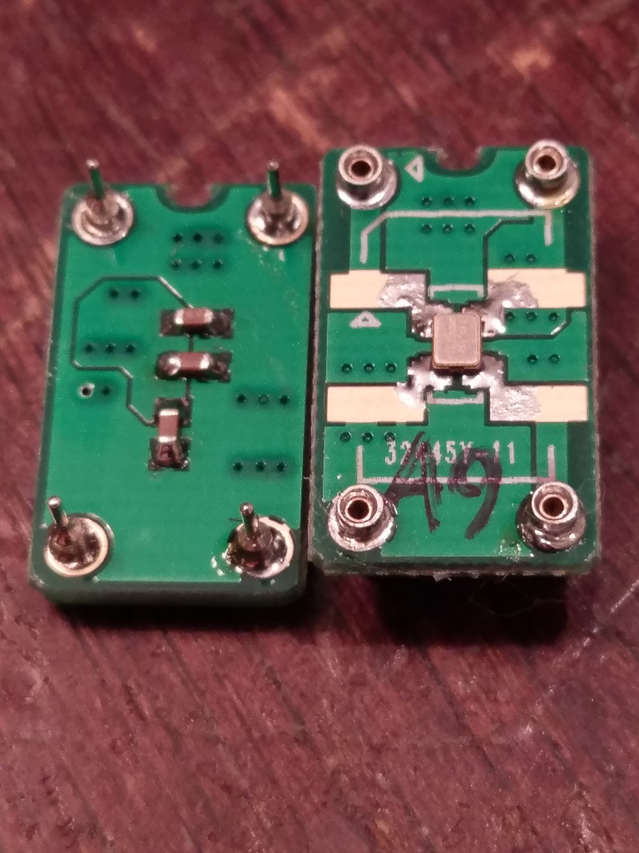

Nope, I can't point you to one. BUT I can pull a couple of clock adapters and shoot a picture for you.
I will be experimenting with various SMD film caps here in the future. BUT this is what I have now.

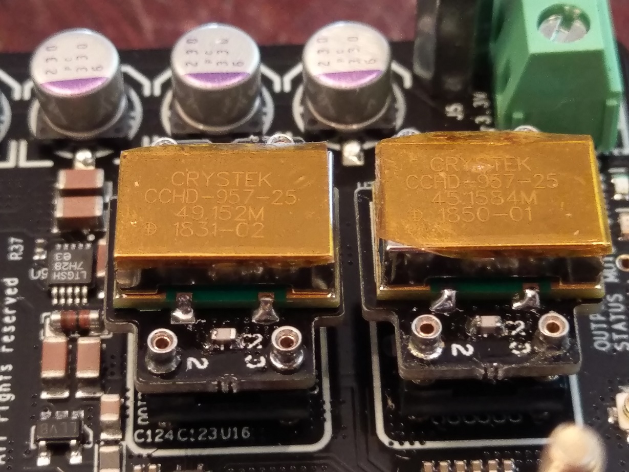

P.S. Bonus shot of a pair of Crysteks on Ian's new adapters on a FiFoPi with Kapton tape on the top to prevent them from shorting out. There is not a lot of space between the top of those clocks and the bottom of the DAC boards... and with the ES9028 prototype board I have from Ian, there were touching before I snipped off some lead ends.

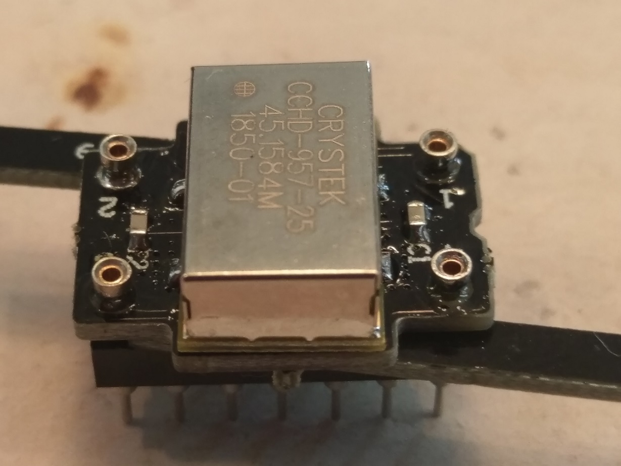

Walter,
The trick I use with soldering the NDK's is to use a means of magnifying them (I use my cellphone's camera and magnify it as much as possible) and identify the pin 1 registration dot. Then I use a fine-tipped permanent magic marker (Sharpie brand here in the US) to mark that corner. The dot rubs off quickly with handling and using rubbing alcohol to de-flux the solder joints almost always removes it entirely... that is why you don't see it in the picture.
Greg in Mississippi
P.S. Bonus picture here shows how I use the pieces of circuit board material that you snip off Ian's new adapters as spacers when soldering the connection pins. They are about the thickest spacers you can use and still get the Cryteks to fit under the DAC board above. I'll post some pix later on how I shorten the connection pins when using Ian's original adapters with Crysteks so they will fit on the FiFoPi with sufficient headroom for the DAC board.
Greg in Mississippi

Thanks Greg. I actually do the same trick with the dot. I use a 30x jeweler's loupe to read the etching. Great minds think alike.
Your pic is most useful, as I solder one of these things once every few years, and would have been sweating over proper orientation.
I don't plan to use the Crystek but the pic will help someone. I find the NDK SDA similar in spec and much better price performance.
