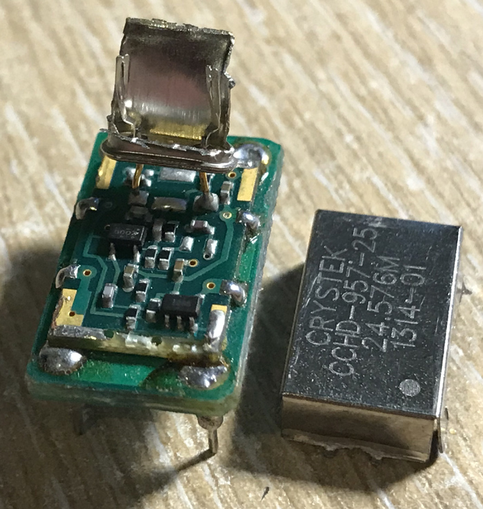

It's off topic and I appologize but has anyone removed the CCHD-957 casing to have acess to the Pierce oscillator board around its XO ? IanCanada answered me he has a much better Dil-14 adaptator board for this Crysteq board than before : 6 x 100 nF X7R + 2x 10 pF C0G decoupling areas. But what about the embeded caps of the Pierce board itself below the casing?
It's pretty sure to be X7R as well and I bet a swap with C0G might improve something ? But I assume IanCanada designed his CCHD-957 adaptator to avoid any oscillations because the distance with the FiFoPi local caps.
I don't know, maybe just a waste of time. Crystek CCHD-957 | H i F i D U I N O

up to you... could be the photograph of the Year.
Everyone would like to know about the caps and if they can be swapped by better NPO for instance Well if the X7R we can see from Hifiduino are as low capacitance than the NPO range/casing size.
Think they did their job at Crystek, but sometimes financial winns against engineers (always in fact...)
Did you have performed scope tests as well ? I'm a little worried by the capacitance value of the NPO cap of the new CCHD-957 black adaptator (in the pico range) from IanCanada : what happen if the Crystek in board X7R (i saw ther eis an oap as well) are from a superior capacitance value ?
Does it mean whatever the FiFoPi or MC board, the capacitance of the adaptator board was measured for both boards ? For instance the Supraclock board has also its embeded oscillator and there is no need of a further board when stacked on the FiFo II/MC/Pi boards ????
Sorry, questions have no sense perhaps on a technical side... On a hifi-porn side, sure everybody would like to lurk without the top!

Here's the pic old mate.
I'm not sure if the questions were for me, but just in case; I didn't test anything just plugged and played. I think measurements would require some special equipment for phase noise below 1Hz, and I don't know how consistent the measurements would be across Crystek samples.
Pulsar was a good improvement but I don't think that means the CCHD957 is not good, IMO it is perhaps the better balance for price and performance, at least with the sample that I had, and I think that might be important - sample variation; what is their test criteria for pass/fail at Crystek QC dept?.
FWIW the clock was non-functional so no CCHD's were harmed in this experiment, the crystal might have been okay, but I wanted to see inside that too - was anti-climax of the week 🙂

Thanks to have removed the roof of this Crysteq fun house.
Sure it's not bad I have two and it sounds even better with a close energy decoupling cap : 1 uF Panasonic PPS or even better (subjective listening) with a Cornel Dublier acrylic cap. All the guys saying it has a bad sound have imho a bad design or do not know how to measure and power it or design things around. At least I'm not a tech and I had just luck with this decoupling cause the improvement was big... maybe just because of that I will try the SMD/CCHD-957 adaptator kit of IanCanada just cause it has one 0807 area for bigger platic smd cap I'm talking about (seems it was for a 1 uF 0807 X7R cap in the IanCanada kit). I certainly going to test the black adaptator side to side, would have liked it has 0807 decoupling area as well, but inductance seems important as said by Markw4 and small foot print might be important. Well at 0402 size I can't solder it : too small for my hands., it's good IanCanada stayed with 0605 size case. I understand people like choice but it should be better to solder the Crystek on the pcb directly with these high frequencies/speed...

Well the Crysteq has both Class I NPO/C0G and Class II ceramics on the pcb... better to leave as it is .
Or could be fun to remove the crystal destroyed case and put an Andrea Mori's Laptech at-cut or low frequency sc-cut (no need perhaps of an oven for this last at low frequency : 5.xx K Hz)
Superb photograph, thanks again, think it's the first time one can see it on the www.
