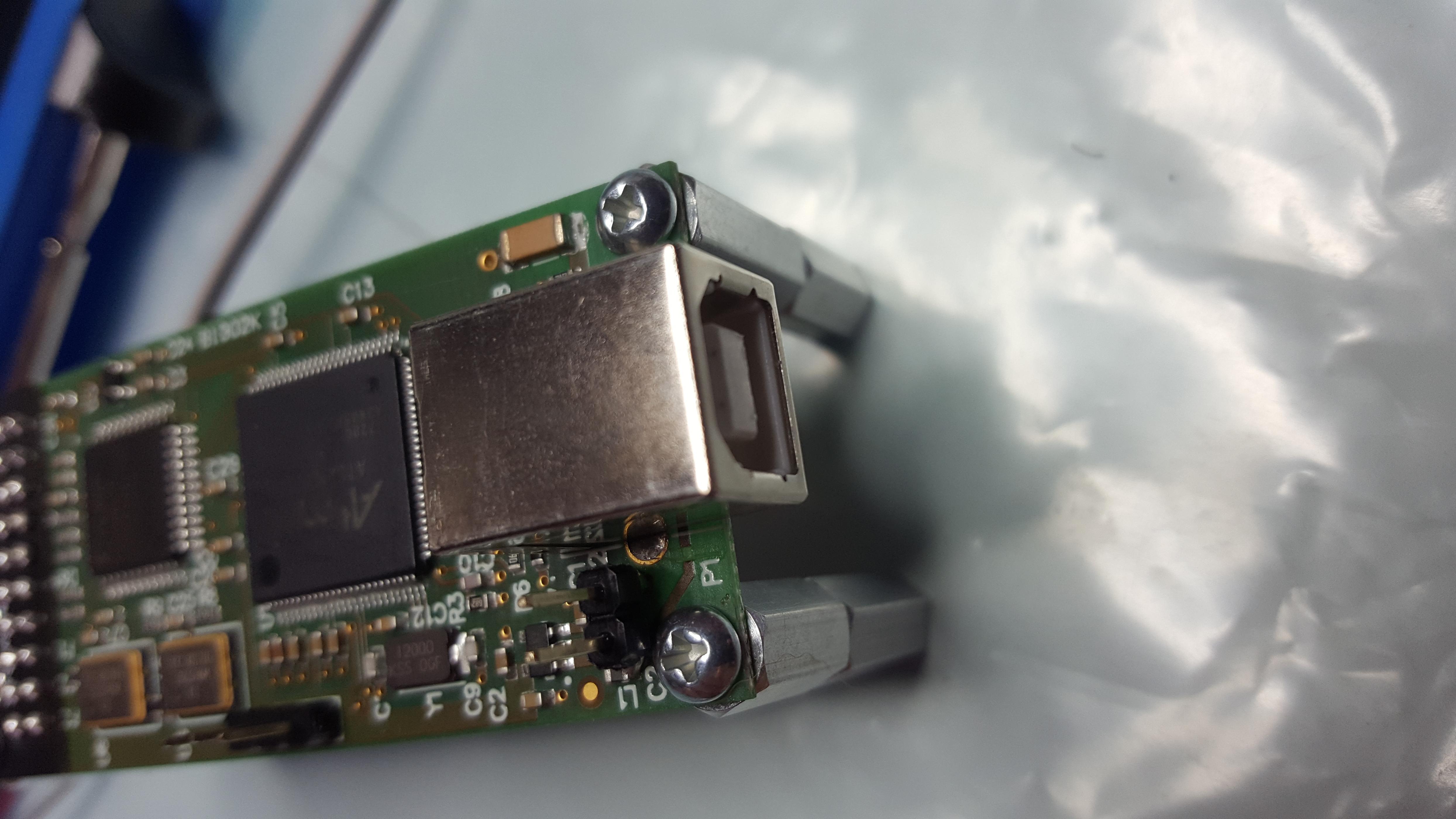

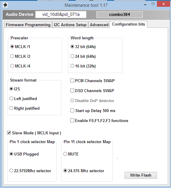

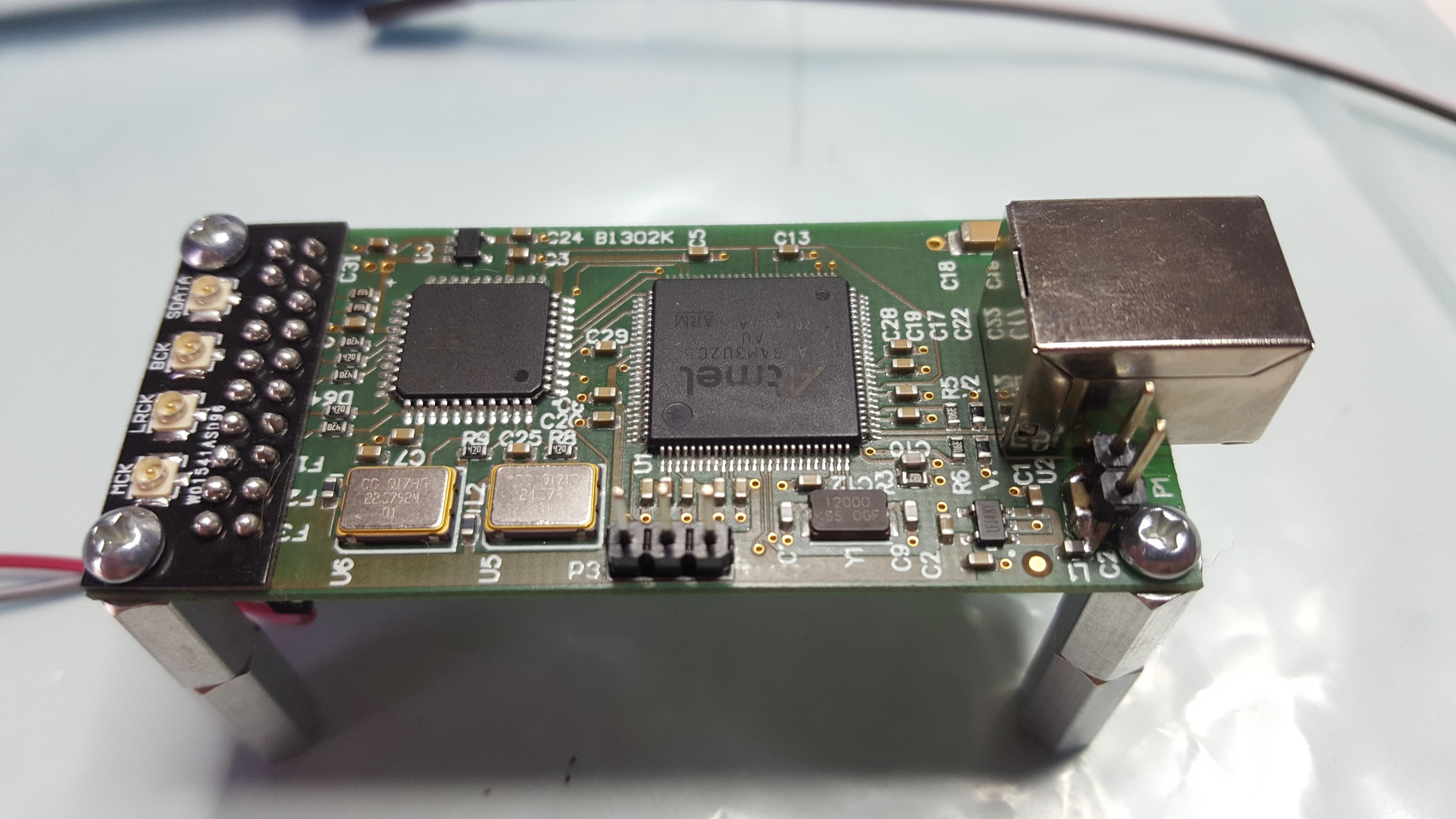

Amanero slave mod configeration
After some tinkering around I managed to connect Amanero to McFifo in slave MCLK mode.
Basics:
1. Flash Amanero with Slave_for_1080 for CPLD and firmware_1099c for CPU (or any other that suits your needs, e.g. DSD ones);
2. Set config bits: tick "Slave mode" and Pin 11 - 24.576 selector;
3. Put 49 MHz XO in XO2 socket of McFifo;
4. Connect 3.3V power from Amanero (pin 9 on Amanero) with 1K resistor to SLEN (pin 19 on J8 on McFifo);
5. Connect pin 11 on Amanero to XOSEL (pin 20 on J8 on McFifo);
6. Connect MLCK to one of SLAVE MCLK OUTPUT of McFIFO with u.fl cable;
7. Connect three I2S/DSD signals to McFIFO;
8. Set jumpers SLMCLKDIV0/2 (JP3 Open, JP4 Short) to divide McDual XO board XO frequencies to Amanero frequencies, if using 45/49 XOs. Please refer to McFifo manual for jumper settings in case you use another XO frequencies, Amanero accepts 22/24 only.
Also attaching some mods made to Amanero board:
1. USB power trace is cut next to USB connector;
2. External power connector is soldered directly on C2 before onboard reg;
3. External 5v power is fed from McFifo board;
4. Excellent uFL adapter made by Acko is soldered onto connector pin;
Attaching configuration bits and HW mod photos for your reference.
Music coming from this setup is simply great, no pops or clicks or whatsoever.
Forgot to mention: with sync USB-Fifo set-up sound coming from 9038 dacs is a bit cleaner than async one, although difference is marginal. All in all I would say that it is worth the effort of connecting 2 cables.
