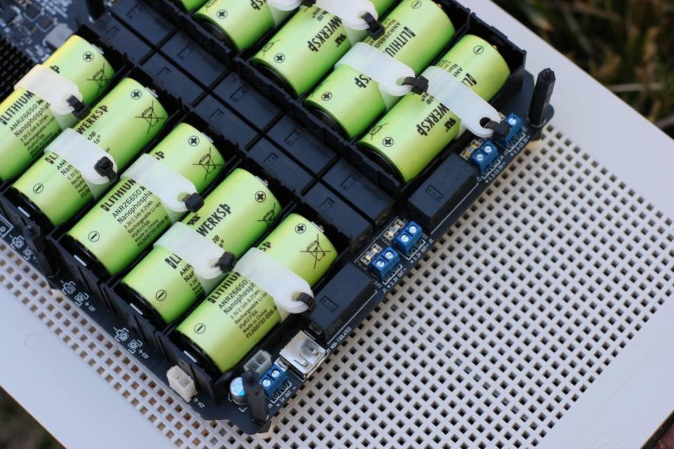

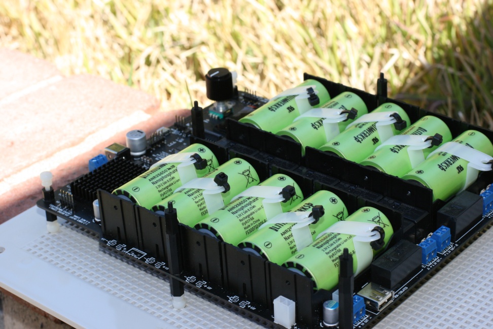

Project Update
After my initial learning curve early 2021, I decided to just focus on desktop going forward. I'm giving up indefinitely any portable or transportable projects. I'm also giving up on the RPi / StationPi on the desktop and moving towards a PC-based SPDIF-OUT (No WIFI) via 13.2V rail from the MKIII solution to feed a ReceiverPi (3.3V).
This allows me not only to be off 5V, but also to focus exclusively on the Andrea Mori clock. I had wanted MagicXtal because if MOQ is 5 and if I have 3-5 FiFoPi systems, that makes sense. But now since I put behind any portable or transportable, I can focus all my attention on Andrea Mori clock.
The lessons learned comes at cost. I fried a FiFoPi Q3, a A123 18650 battery, a A123 26650 and 3 BMS. I can't even calculate all unplanned Mouser / Digikey parts I went through, but I chalk it up to just paying for DIY lessons and gaining good experience in this hobby.
I'm happy to report I finished assembling the MKIII and that went smoothly and rock solid.
During the process to try to make the Q3 portable, I had to remove the power terminals to make it fit the case. After many iterations of soldering on the Q3 PCB, it finally gave out and shorted. I realised now the problem was the Q3 short all along. I had soldered my BMS properly, but for some reason it always fried. It was frustrating and confused me. But now I understand I shorted the Q3 so no matter how careful I was soldering the BMS, there was no chance for everything to work because I didn't recognise the Q3 short at that time.
Well, moving on... After some more Mouser parts, will tackle the Ultra Caps on top of the MKIII end of the month,
Desktop is pretty straightforward. Experimenting with portable is a challenge, but it helps by gaining experience for the Desktop build. I'm feeling more confident to tackle the Andrea Mori clocks down the road. Finished board only of course...

With portable and transportable projects in rear-view mirror, I can focus solely on desktop.
So it begins...

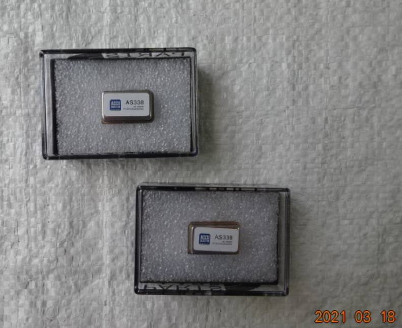

Accusilicon AS338 x 2 on the way
Since there seems to have been interest in the Accusilicon AS338 on this thread, here's an update so we stay ahead-
Taobao Focus has them on this page Loading.. Please wait. #637951115161 Taobao FOCUS
AS confirmed vendor status at an earlier stage.
With shipping etc, the fee per each grew...
...to a total of close to $200 for 2.
They sent me this pic of my goodies today.
And I paid for shipping, they'll be on the way.
I hope DHS gets them to my door before too late.
I'll stick 'em on FIfoPi and see if they sound great.
Regardless, I'll let you know how they sound as soon as the little buggers are around.
