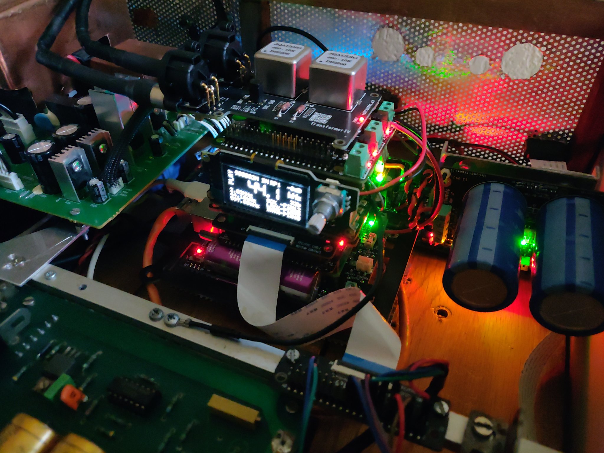

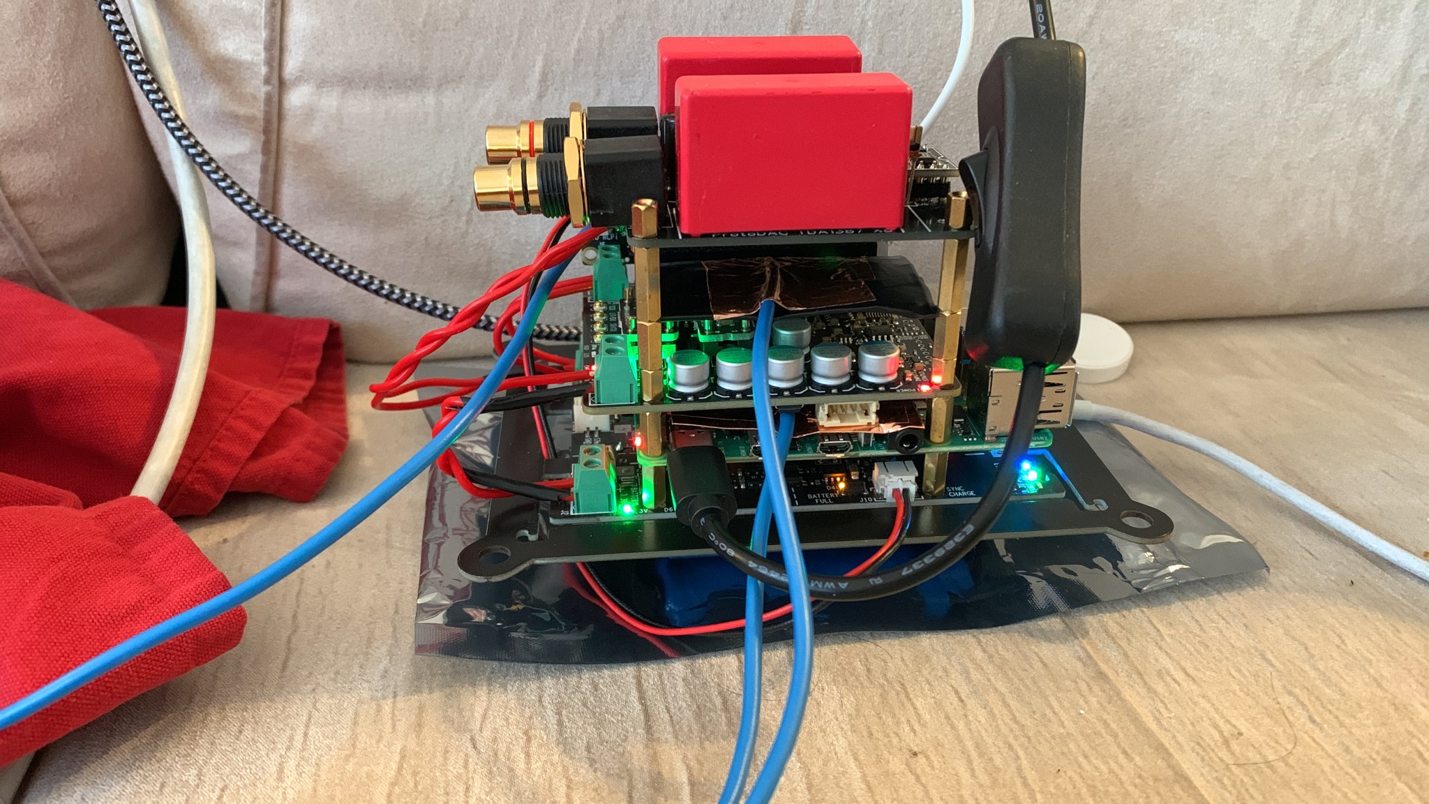

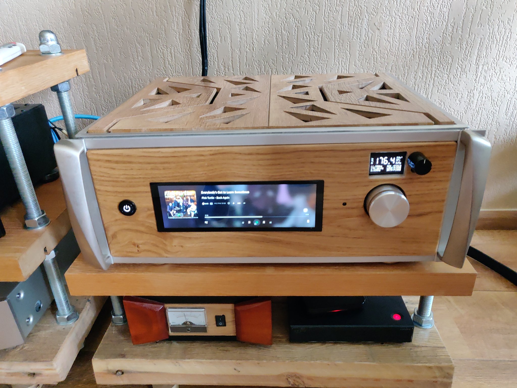

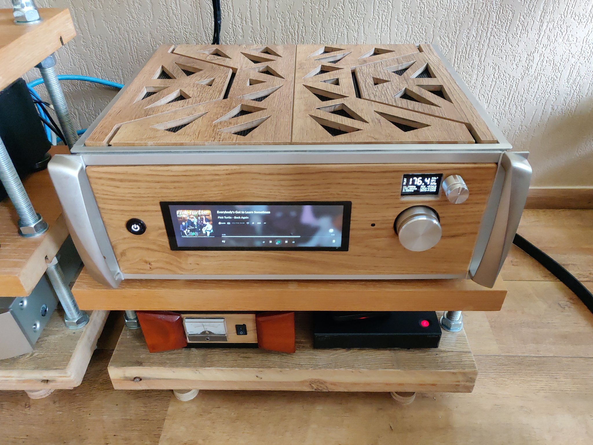

I exchanged the PCM 1794 for an Ian Canada Ess MkII DAC plus IV passive transformers. quickly connected to hear if sound comes out.
the PurePi I has also been replaced by the PurePi II.
an isolator II and FifoMa 1.5 underneath.
Tomorrow I will connect everything better plus the right power supplies and transformers. happy with it for now.

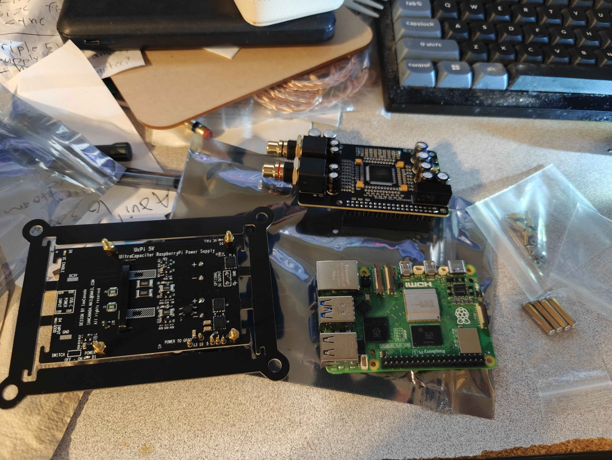

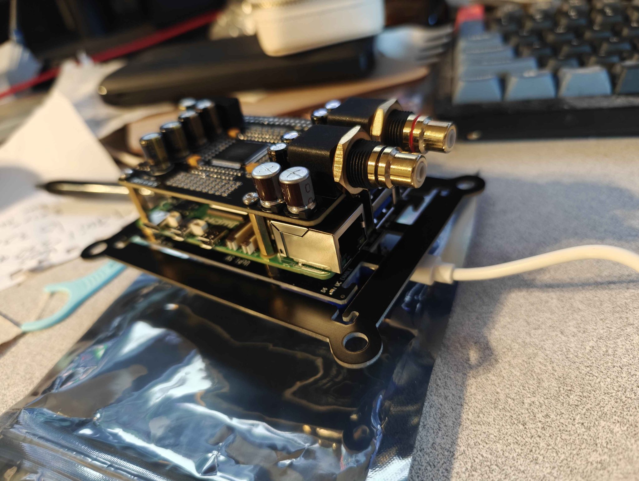

Hey guys.. just put together my UcPi, rpi5 and the audiophilediyer r2r nos hat dac.. using a jay's audio 5v 3 Amp linear power supply.. when I plugged in power to the UcPi the LEDs on the UcPi didn't light up.. the manual says on first charge it might take two hours.. is that actually right? Or should I start trying different power supplies and cables? I swapped to a known good usb-c cable, the one I use with my phone and the led didn't light up either so I went back to the other cable.. I'm leaving the UcPi power switch to off until the it fully charges and the LED comes on.. hopefully soon
Did you see this?
"Note: To working with RaspberryPi 5, have to buy the 6mm M2.5 standoffs. The supplied default standoffs are the 7mm M2.5. "
Yes, it may really take a couple hours for the capacitors to charge.
And, please ensure your power adapter has enough current.
thanks for the help, ghostship! Yes I had ian ship me the shorter standoffs with my order. I think I figured out the problem. The Jay's Audio linear power supply doesn't seem to work with either the rpi5 or the UcPi. Weird, because I swear it worked with the rpi4 and the audiophilediyer ad1865 hat dac.
I switched to my ipad charger and it worked. I also verified it works with my oneplus phone charger as a power source, too.

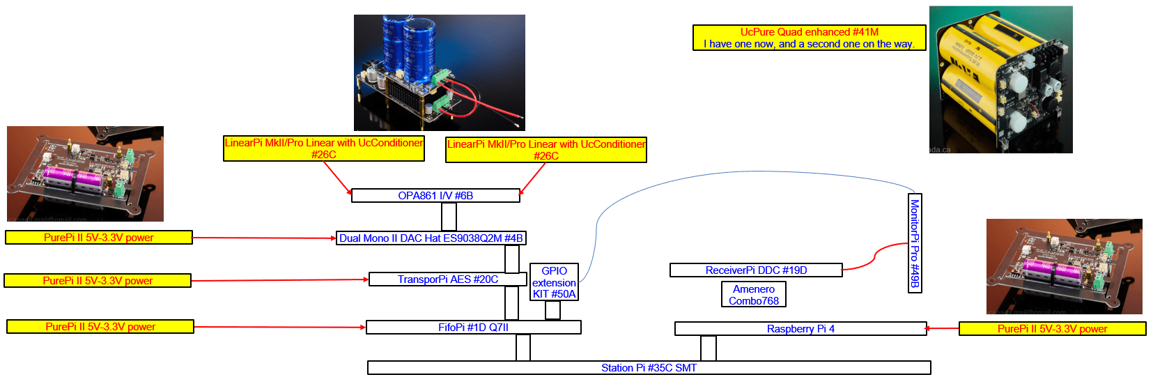

Power advice for OPA861 I/V #6B,
and
Dual Mono II DAC Hat ES9038Q2M #4B
If I will have
2) UcPure Quad enhanced #41M
and
2) LinearPi MkII/Pro Linear with UcConditioner #26C
Is it better to use
the 2) UcPure Quads on the OPA861
and
the LinearPi MkII/Pro Linear with UcConditioner #26C on the Dual Mono II DAC Hat ES9038Q2M #4B
or vice versa?
