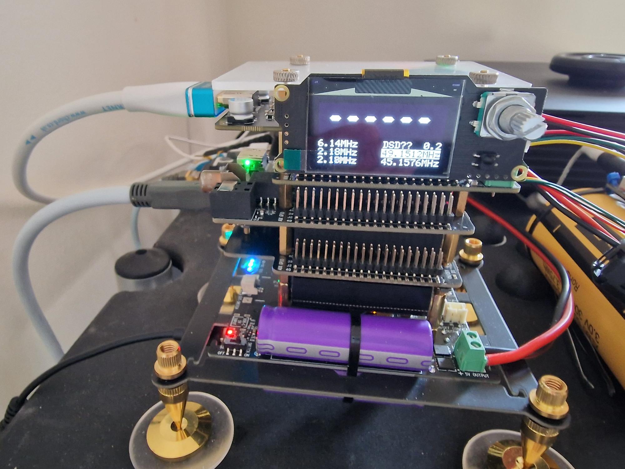

Hello Everyone
Hope everyone is having a great Sunday.
I could use some help to resolve a DSD-related problem I am having with my Ian Canada stack.
My stack is RPi4 USB output into a ReceiverPi DDC (Amanero768 USB input) -> FIFoPIQ7 -> HDMIPiPro. The HDMIPiPro is feeding the II2S input of a Gustard R26 DAC
I am using HQPlayer to "feed" the RPi4.
Everything works OK when I use the PCM output of HQPLayer
However, when I try to use the SDM (DSD) output of HQPlayer, then the FiFoPiQ7 doesn't seem to recognise the DSD stream - see the screenshot of what my MonitorPiPro is showing in the photo below
Anybody come across the problem or seen this displayed on the MonitorPiPro before, please?
Many thanks
