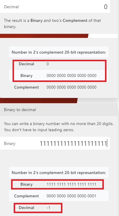

After thinking about it for a while.
I believe the alleged glitch issue could come from the two's complement DAC implementation.
At zero crossing all the switches of the DAC change theirs state (eg. from 00000000000000000000 to 11111111111111111111), this could cause the glitch.
I wonder why your former fellows have not implemented the sign magnitude DAC operation which could solve the glitch issue.
Maybe I'm wrong, but seems like a pride issue.
Since BB (TI) implemented it before us then we can't follow this way because we wouldn't be the first to do it.
Pride aside, I believe the best way to solve the alleged issue is to get the AD5791 to work as a sign magnitude DAC.
This means that a couple of DAC have to be used for each channel, for a total of 4 DACs to get a stereo device.
This way all the switches of the DACs never change their state at the same time because the first DAC will cover the positive rail and the second DAC the negative one.
In other words the MSB of each DAC will operate as the sign, so for the first DAC the MSB always is set to 0 and for the second DAC the MSB always is set to 1.
This way needs a custom driver for the DAC and a voltage summing amplifier at the output of the two DACs
