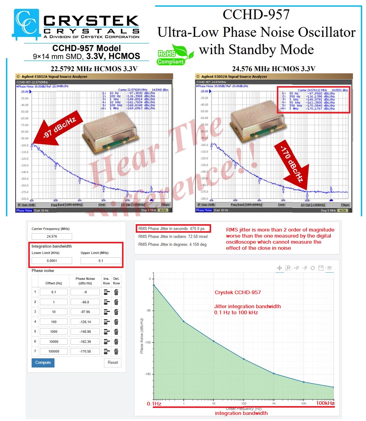

Ian,
"The relationship between time jitter and phase jitter is just an approach, not really equal or precise."
WRONG
The matematical relationship is just perfect, but at this point I assume you have not understood that the jitter result depends on the integration bandwidth, as I have explained sevral times.
You can find a lot of literature online or you can just use the online phase noise to jitter converter tool you have already used to understand.
"My LC584ALX is equipped with a JTA jitter testing package. The jitter noise floor is just 2ps. I attached the JTA specifications for you to reference. Please don’t mislead others with wrong specifications to degrade testing equipment other than yours. Can you explain where the 7ps wrong noise floor number came from?"
I have read somewhere that the jitter floor of your oscilloscope varies from 2 to 7 ps, I don't remember where but I will search again.
Maybe 2 ps is the lower limit but it could change according to the quality of the timebase (the internal reference oscillator).
However the problem does not change, YOU CANNOT MEASURE fs clocks with a jitter floor of 2 ps.

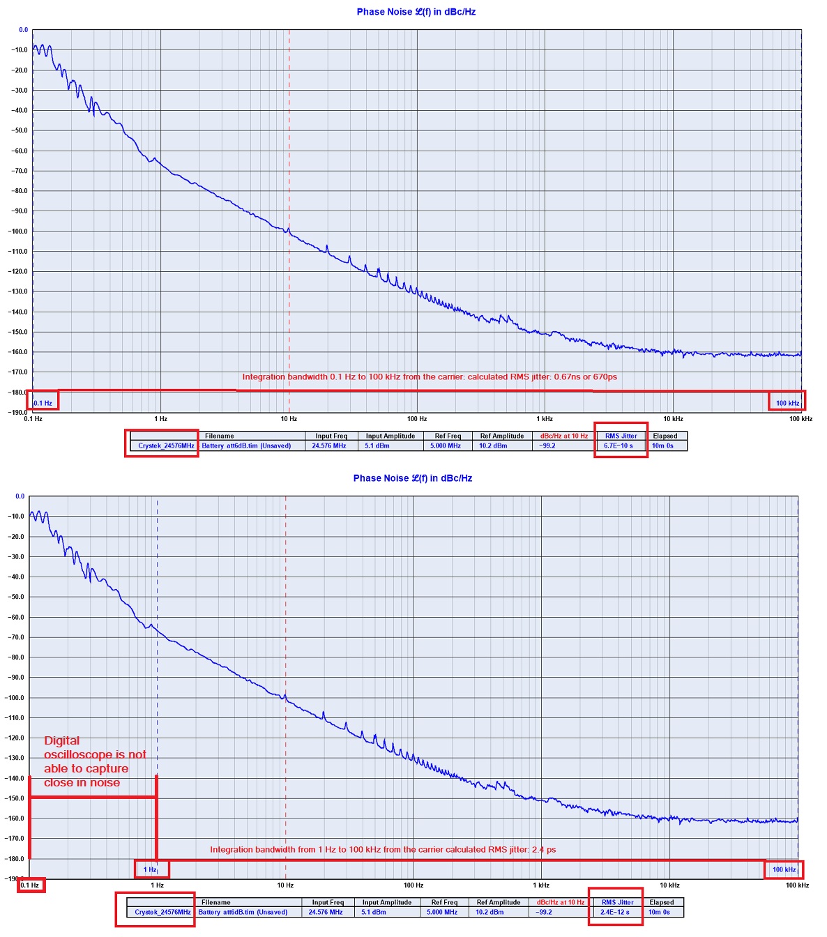

"CCHD 957 RMS time jitter was tested directly in the time domain of 2.71ps. However the phase jitter calculated by your TimePod was 0.67ns (0.1Hz to 100KHz). By comparison with the time domain measurement, I think your TimePod phase jitter calculation result is inaccurate."
WRONG
Already demonstrated in post #6970 (third picture) and in post #6997.
Your digital oscilloscope is not capable to capture the close in noise that means jitter below the jitter floor of your tool.
I attach the pictures again, please read carefully and use the online phase noise to jitter converter tool you have already used to calculate the resulting jitter yourself (if you don't trust the picture I have attached).
AND FINALLY, please let me know why in post #6968 you have arbitrarily chosen an integration bandwidth from 0.1Hz to 100kHz from the carrier to calculate the jitter of the DRIXO oscillator, while now you are refuting the same integration bandwitdh you have previously arbitrarily chosen to be applied in order to calculate the jitter of the Crystek.

Agreed, it's pretty much textbook knowledge, but still doesn't answer to what I would think is a fundamental question: what does matter for digital audio? For a (for example) ADC, "phase noise" is an abstraction, what really matters is the jitter, which creates incertitude in the sampling timing, resulting in digital noise at the output, affecting the ADC SNR.
Jitter can be calculated from the phase noise spectra, but obviously not the other way around: there is no way to reconstruct the phase noise spectra from a single number that is the jitter. But, again from an ADC perspective, does it matter what the original phase noise spectra was? It doesn't, of course.
Secondly, it is true that the close in phase noise may have a significant contribution to the overall jitter (which, once again, it's what ultimately matters). But if we want to estimate an oscillator jitter from a phase noise plot, how can we do that? From the just posted Crystek example, if we integrate from 1Hz we get 2.4pS RMS of jitter, if we integrate from 0.1Hz we get 670pS, so what is the jitter? It appears to depend violently on an arbitrary constant that is the lower limit of integration. Why not integrating from 0.001Hz, since the phase noise will increase fast, then we are going to get an even larger jitter? What is the "true" value of jitter?
The answer is in the attached chart, from the Analog Devices application note; the relative jitter contribution of the close in phase noise decreases faster than the phase noise increase per the Leeson model. So there is a frequency point from which the close in phase noise contribution to the jitter becomes insignificant. Where is that point, that is a good question; so from a jitter perspective, the phase noise profile is much more relevant than ultra low phase noise values at 0.1Hz.
There is another thing here: the close in phase noise affects the spectral resolution of the system output, while the broadband noise (the "flat" part) affects the ADC SNR. One has to answer the question of what matters most for digital audio, something we have nothing but anecdote level evidence about, stories from usually self appointed Golden Ears uncontrolled, sighted listening tests. Based only on the current body of evidence, I would think SNR is the right metric (which does not mean we can hear a difference between 110dB and 120dB of SNR). Except, of course, for specialty applications like radars or space guidance systems, where the spectral resolution is of course critical.
Well, if the integration bandwidth have to start at 10kHz from the carrier, please let me know what is the purpose of this thread.
You are integrating the noise floor only, and any 30 cent oscillator has a noise floor below -150 or even -160dBc.
Just as an example the Crystek CCHD-957 is -130dBC at 100 Hz from the carrier.

Just in the picture you have attached, integration bandwidth starts at 10kHz from the carrier.
I didn't insist at all, I'm not the one who has arbitrarily chosen an integration bandwidth starting from from 0.1Hz, please read carefully post #6968 and look at the first picture
