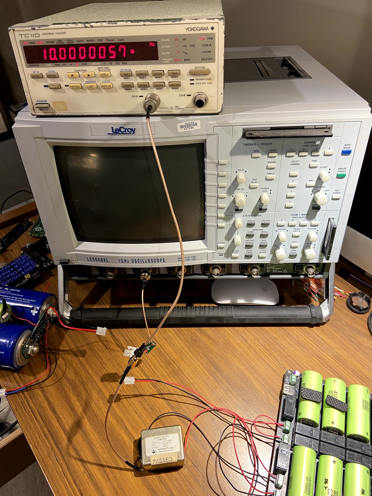

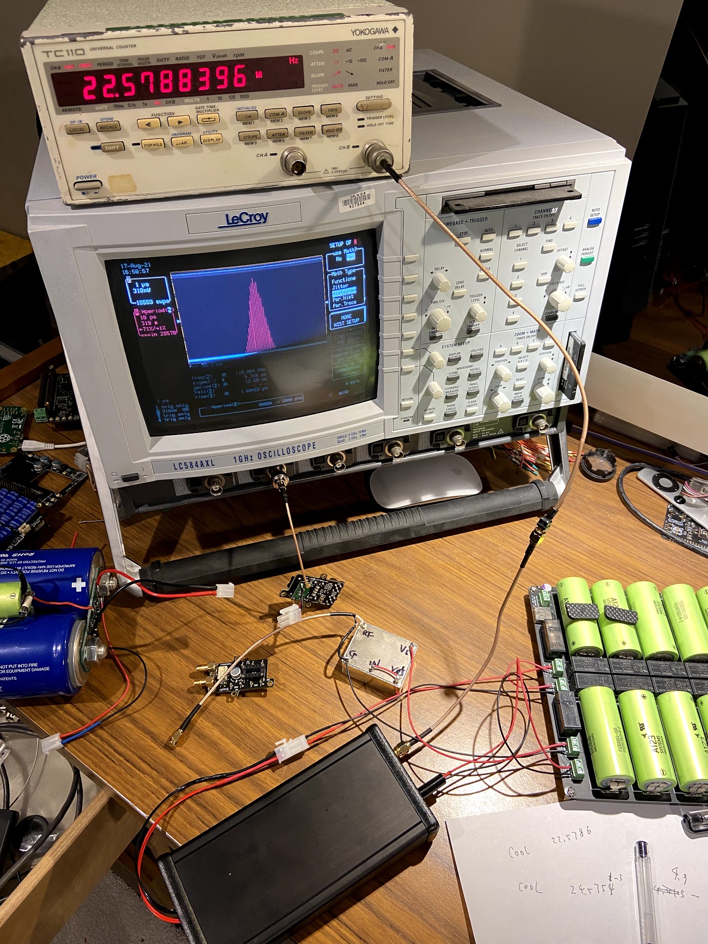

DRIXO 22.5792MHz frequency stability test with/without an oven
A.Testing conditions
YOKOGAWA TC110 precision frequency counter warm up one hour before test
Gate time: 10s
Frequency resolution: 0.1Hz @ 100Mhz range
Morion MV201 precision 10MHz OCXO as calibration reference
13.2V LifePO4 power supply as DRIXO power
DUT: DRIXO with 22.5792MHz Laptech 3rd over ton SC-CUT crystal
B. Testing process
DUT started at room temperature without an oven
0 minutes: 22.5783892MHz
30 minutes: 22.5784683MHz
60 minutes: 22.5784740MHz
90 minutes: 22.5784757MHz
After 120 minutes
Stay between 22.5784771MHz to 22.5784778MHz
Frequency changed less than 0.3Hz for every 10 seconds
But very sensitive to environment temperature
When the AC of my house started (temperature changed less than 0.3°C), the frequency can drop to 22.5784766MHz
Then apply dual 80°C oven heating elements, after next 60 minutes
Stay between 22.5788402MHz to 22.5788407MHz
Frequency changed less than 0.1Hz for every 10 seconds
Doesn’t sensitive to AC start and stop or the ambient temperature
C: Calibration
DUT is the Morion MV201 precision 10MHz OCXO
After 10 minutes of start
Stay at exactly 10.0000057MHz
After another 30 minutes
Increased only 0.1Hz to 10.0000058MHz
Really stable
D: Conclusions
1. DRIXO needs at least a couple of hours to reach a stable frequency at room temperature after start. But still very sensitive to the changing of the ambient temperature. Change in 0.3°C can make the frequency immediately shift more than 1Hz.
2. With a dual 80°C oven installed, the frequency becomes more stable and doesn’t sensitive that much to the room temperature. The relationship between long term frequency stability and the short term phase noise is still not very clear, however, with the ovens attached to the SC-CUT crystal, the changes to the sound quality are pretty positive. And I believe the more than 1Hz frequency shift should be shown on the phase noise plot if that change is within the measurement time.
3. The Frequency Tolerance of DUT was measured -32ppm/-15ppm without/with an oven.The Frequency tolerance of the reference commercial OCXO was measured only 0.57ppm under the same testing condition.
Some notes about the oven installation
Ovens may introduce EMI noise into the DRIXO if the circuits are floating. One terminal of each PTC heating element must be connected to the PCB ground to avoid degrading to the low jitter performance.
And I’m still not sure if the aluminum case needs to be connected to the PCB ground.
