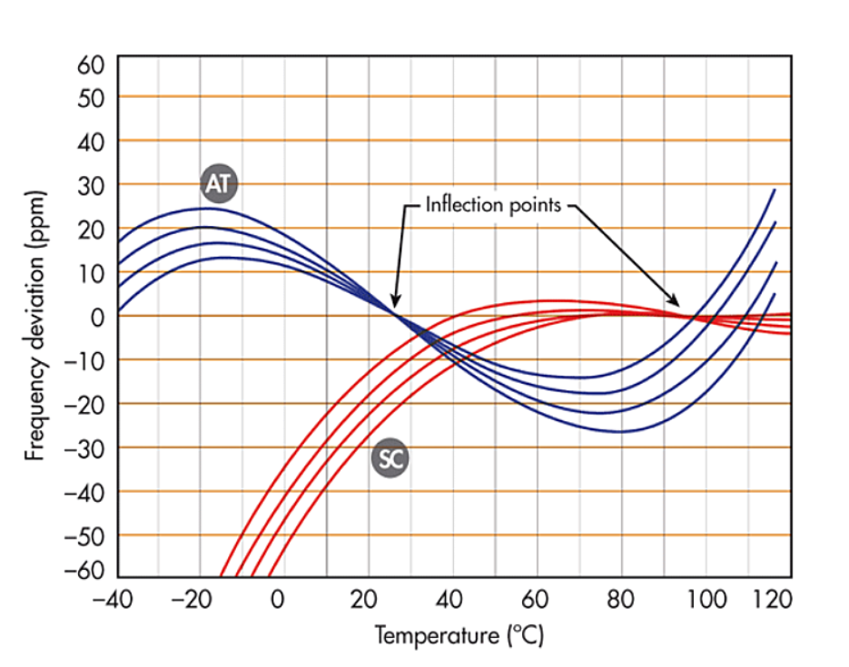

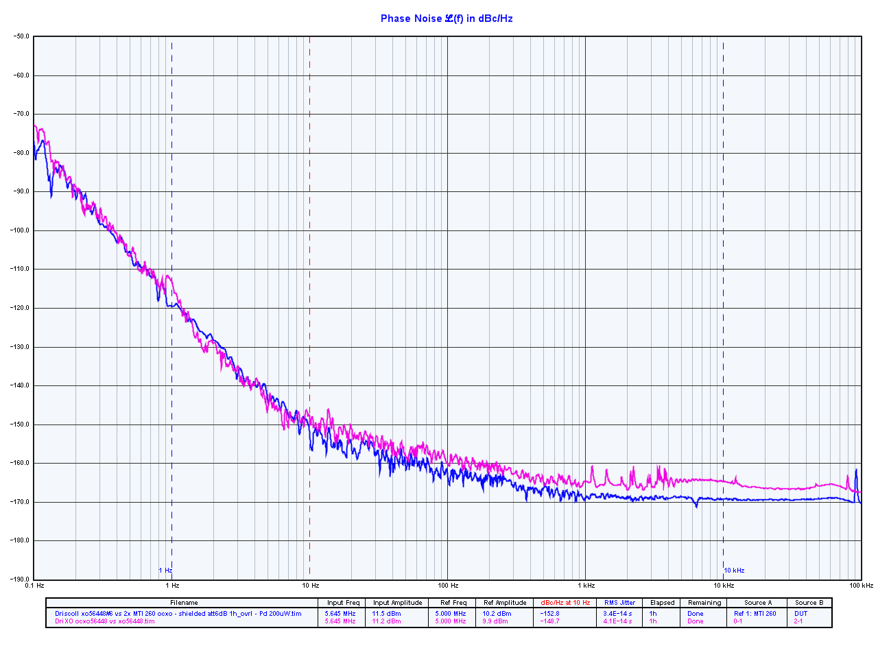

DRIXO 22.5792MHz frequency stability test with/without an oven
2. With a dual 80°C oven installed, the frequency becomes more stable and doesn’t sensitive that much to the room temperature. The relationship between long term frequency stability and the short term phase noise is still not very clear, however, with the ovens attached to the SC-CUT crystal, the changes to the sound quality are pretty positive. And I believe the more than 1Hz frequency shift should be shown on the phase noise plot if that change is within the measurement time.
Short term and long term stability are different things just like phase noise and Allan Deviation.
The long term stability does not affect the phase noise.
This is the DRIXO oscillator with a PID controlled oven we have built some times ago to compare the phase noise.
There was no phase noise difference between the oscillator with (pink curve) and without (blue curve) the oven.
Just in case the noise floor is a little worse with the oven.

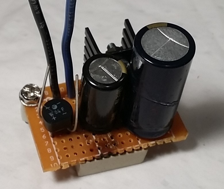

I installed a 80C PTC under the 5MHz crystal to be an oven for the WTMC. My clock stays powered constantly. It is mounted inside a wood box fitted with foam and covered in sand. So over time it will stay a constant temperature somewhere approaching 80C.
I concur with Ian regarding a nice little improvement in sound quality. It is not a big change, just a little more of what we see with clock improvements. Natural timbre and less congestion. I could not claim with certainty I could pick it out of an A B test or that I do not imagine it. To my ear its pretty clear and it will stay.
I made a nice little linear 12V ps. It got it's own transformer winding separate with a L7812CV reg.
D: Conclusions
1. DRIXO needs at least a couple of hours to reach a stable frequency at room temperature after start. But still very sensitive to the changing of the ambient temperature. Change in 0.3°C can make the frequency immediately shift more than 1Hz.
3. The Frequency Tolerance of DUT was measured -32ppm/-15ppm without/with an oven.The Frequency tolerance of the reference commercial OCXO was measured only 0.57ppm under the same testing condition.

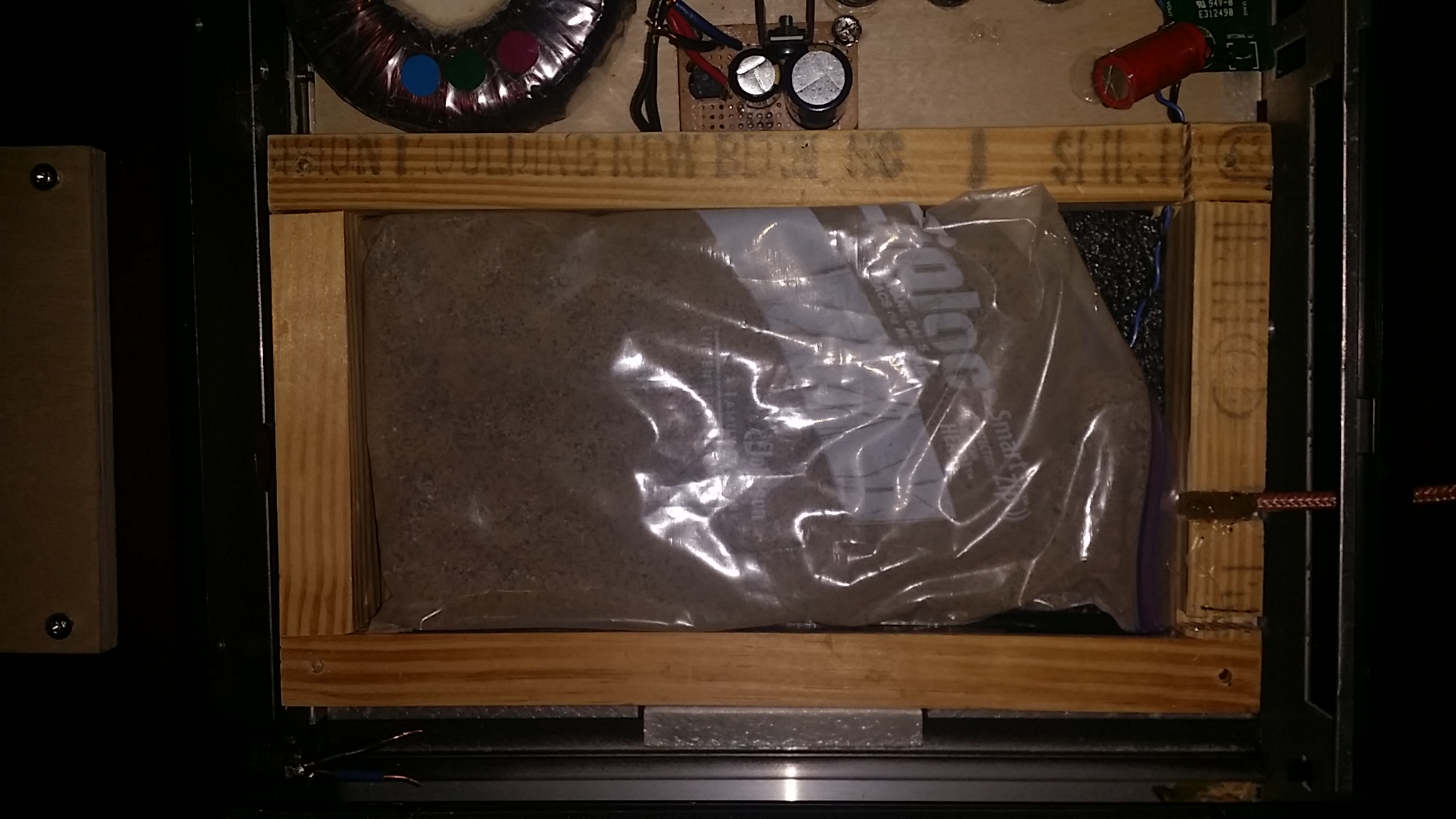

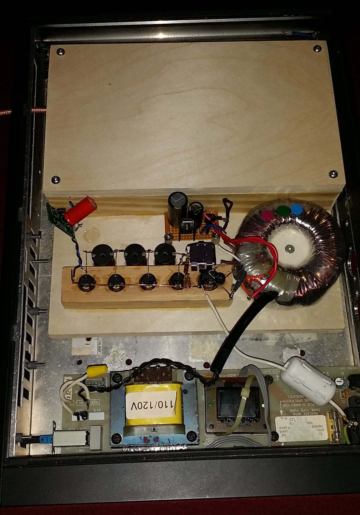

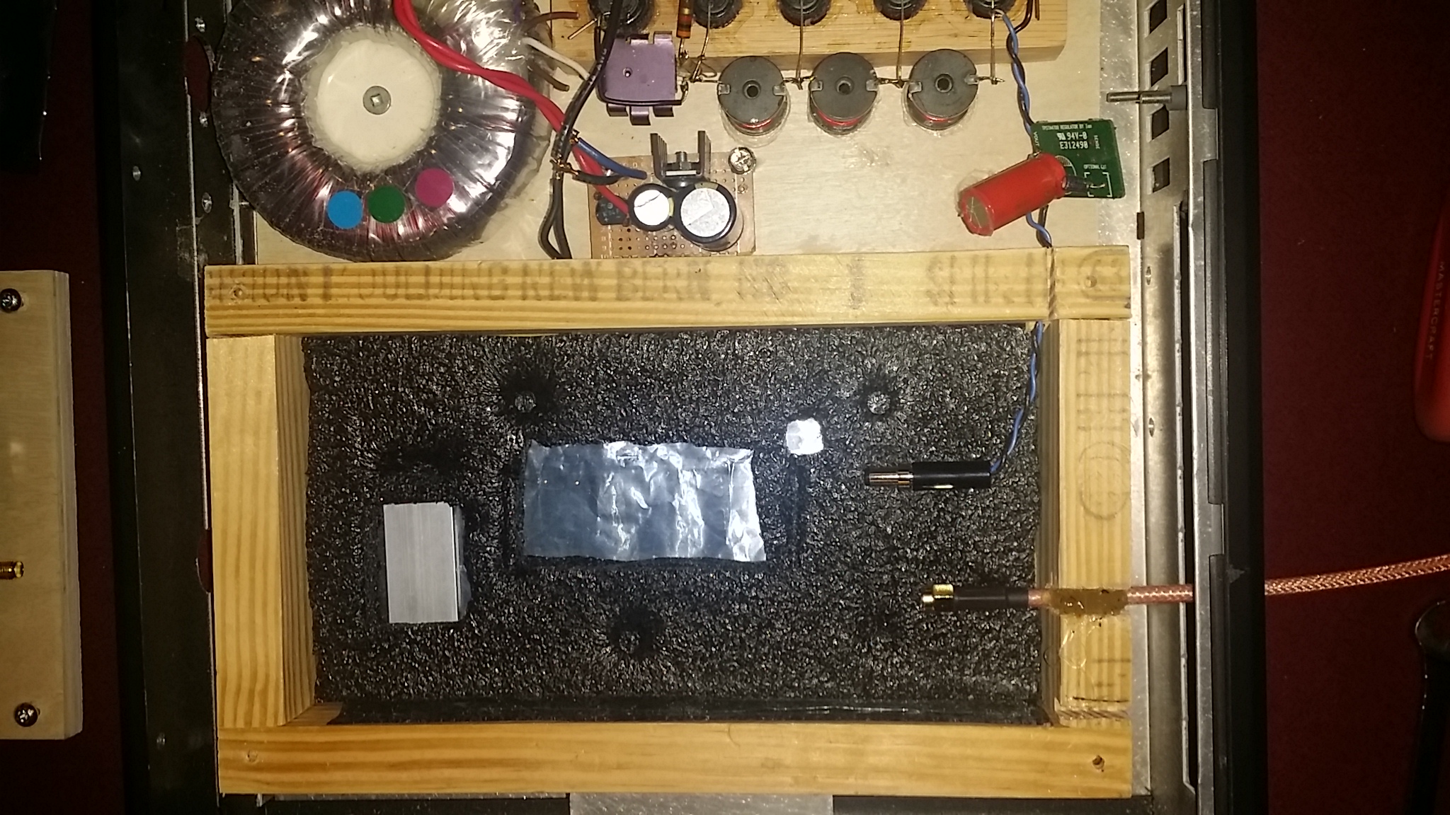

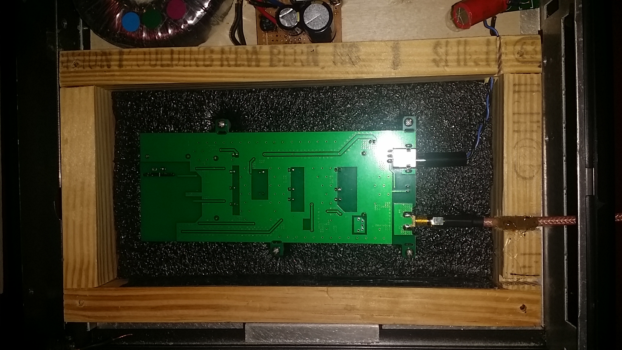

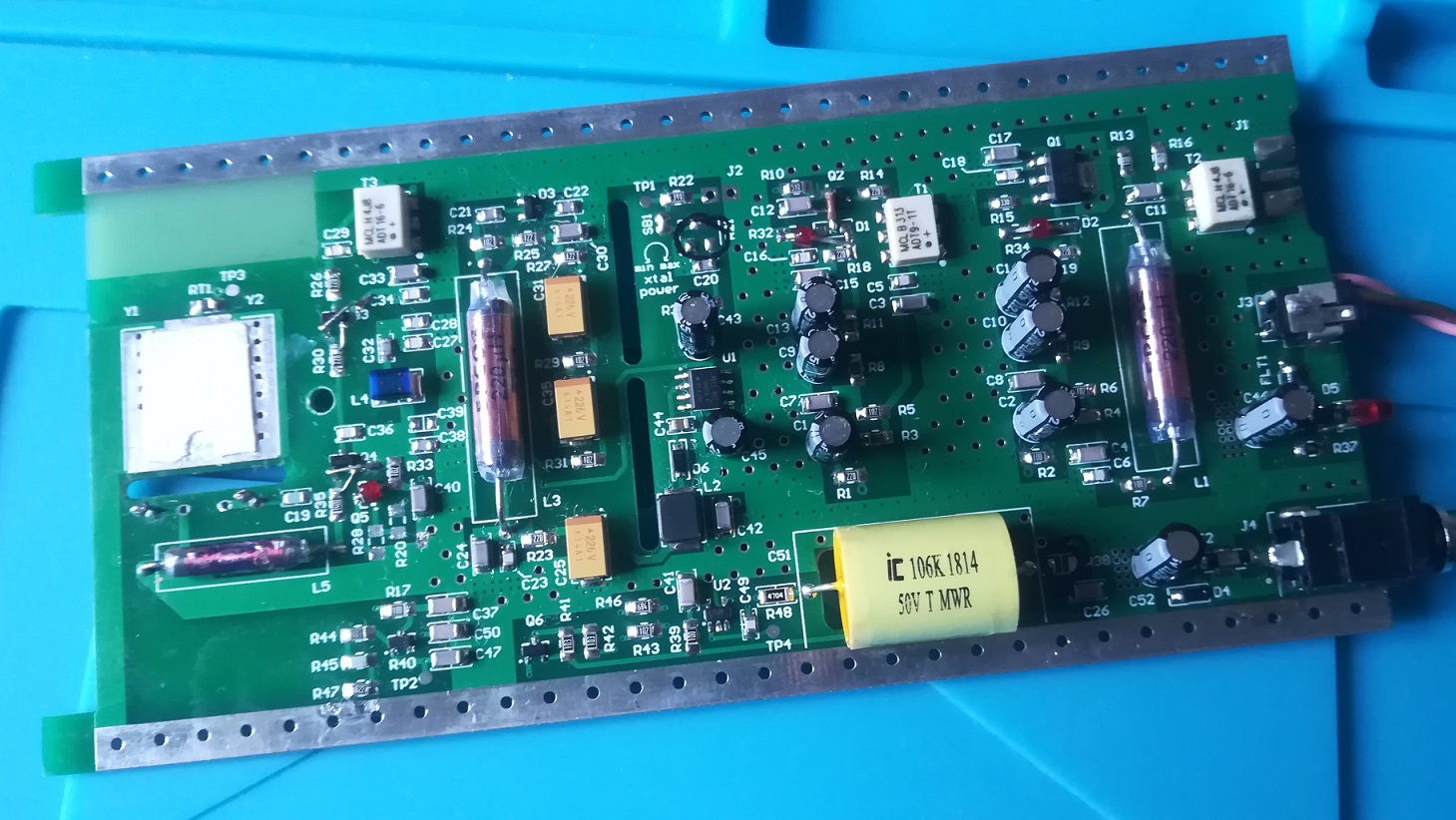

Getting the most out of WTMC - Oven complete
Ian, thanks for pushing on the ground recommendation. With that completed I believe the impact of oven is more substantial. With PTC grounded listening was a little startling. Less congestion or lots of air would be my impression. In all well recorded cuts but even more impactful on complex classical music.
I took a short cut. Did not follow your approach to ground directly to WTMC ground plane. Instead just created a star ground between the two power supplies. The aluminum case of the chassis is also grounded and all connects to the safety ground that all system is tied into.
Pics of oven approach.
A simple one PTC deal taking advantage of the basic layout. The clock lies face down in a sheet of packing foam with a cutout that the crystal fits into. I put the PTC in the well below the crystal. Then pcb face down, then sheet of emi insulation, then a zip bag of sand and then the wood top to the box. So the clock is sandwiched in a sealed box covered with some mass and the oven directly below. Whole thing is in an Al chassis. So no exposure to external environment, and good vibration/emi insulation. Powered up all the time, the crystal has to get heat soaked. IMHO
Hope that makes sense. I prefer your approach, but this fits my needs. Thanks for a great recommendation.

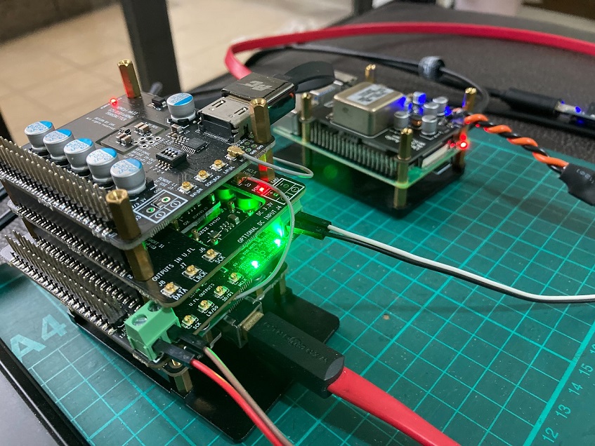

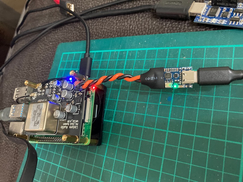

Hi ! To change the clock on the rpi4 board you can refer to this circuit
??? Raspberry Pi 4B ??? ??? OCXO ???? ????-???
https://www.aliexpress.com/item/1005002991527135.html?spm=a2g0o.detail.1000060.1.4e301d9aNJR0f7&gps-id=pcDetailBottomMoreThisSeller&scm=1007.13339.169870.0&scm_id=1007.13339.169870.0&scm-url=1007.13339.169870.0&pvid=039c6b60-7d9d-4038-8971-c72429dd53b0&_t=gps-id
![O1CN01fepEIG1tyJCrP319b_!!201755970.jpg](https://img.alicdn.com/imgextra/i3/201755970/O1CN01fepEIG1tyJCrP319b_!!201755970.jpg)
![H4709d51e9a0b4f248b160f983d52d890T.jpg](https://ae01.alicdn.com/kf/H4709d51e9a0b4f248b160f983d52d890T.jpg)

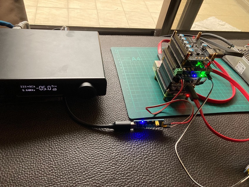

My OCXO thermostatic clock board successfully turned on!
The sound is great!
This is my other set: Ian Canada FIFOPi
Bridge Pi + XingCore U30 + FIFO Q3 + Reclock Pi + HDMI Pi

I don’t see any such claim in #7144 where you quoted. I see only an unsubstantiated claim on SQ, very common in this thread.
You should read carefully:
"And I believe the more than 1Hz frequency shift should be shown on the phase noise plot if that change is within the measurement time."
That's not true by measurement.
1 hour measurement and frequency drift much more than 5Hz, no phase noise difference.
You are confusing phase noise with Allan deviation.
