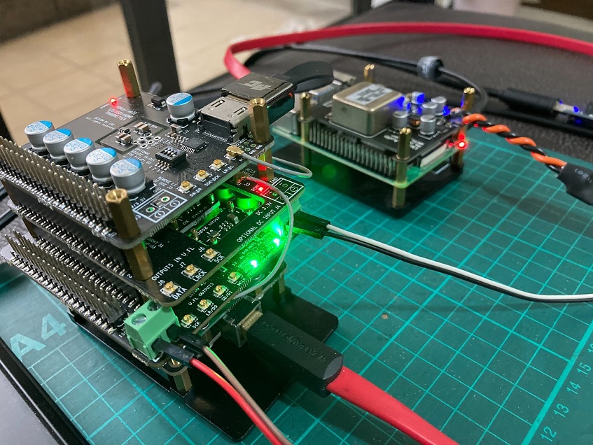

If I'm not wrong, it should be a PLL board with a 10MHz OCXO as reference clock input. It has two outputs, 25MHz and 54MHz.
What I'm concerned about are:
1. OCXO has lower phase noise and higher frequency stability than normal XOs, that's for sure. But after the PLL, are those 25MHz and 54MHz clocks really better than the original XO crystal oscillators on the RPi? If yes, better for what? Close-in phase noise? phase noise floor? or both?
2. Both 25MHz and 54MHz are not the finial audio clocks of a RPi, the real audio clocks are generated by another digital PLL inside the RPi SoC. So the audio clocks from RPi always have very big systematical jitter (more than 600ps, please see the measurement result below). With this solution, can the finial audio clocks of a RPi really benefit from?
3. What are the other possible benefits for the sound quality?
Thanks again, just hope I can buy one to make some measurements.
Ian

Hi! Ian,
In fact, this OCXO clock board has three sets of outputs:
54MHz = BCM2711 SoC
25MHz = BCM54213PE Ethernet
25MHz = VL805 USB 3.0
You can find the purchase link on the following page:

what a ridiculous thing. not only is it an OCXO that is promptly ruined by crappy PLL, it appears its PSU is headlined by tps7A4700 and some even more vanilla LDOs. now, while a reasonable regulator, its hardly top shelf for a clock, particularly in this average layout for it. the other thing, not only is it redundant, the UFL connectors and cable termination is dubious, to non-existent. they removed the clocks and just soldered directly to the clock pads and call that an improvement?
