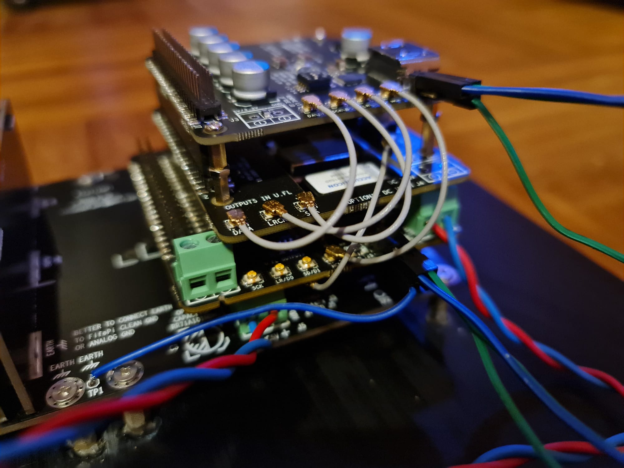

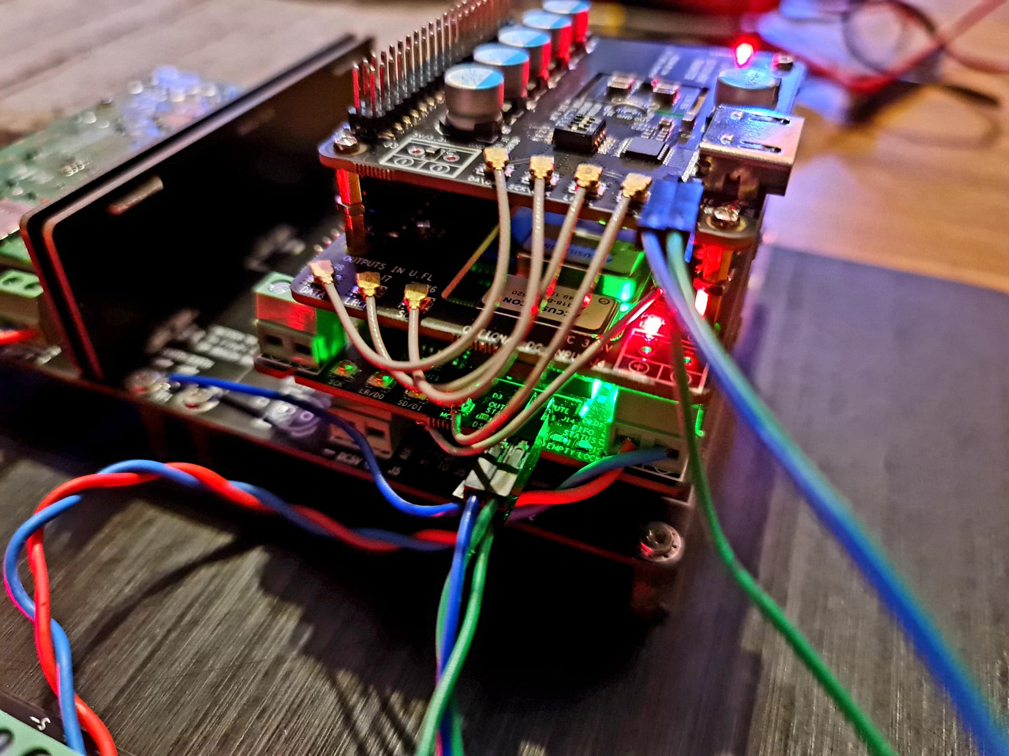

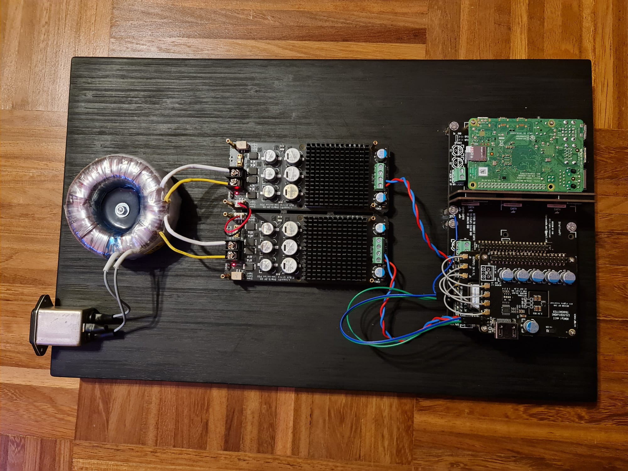

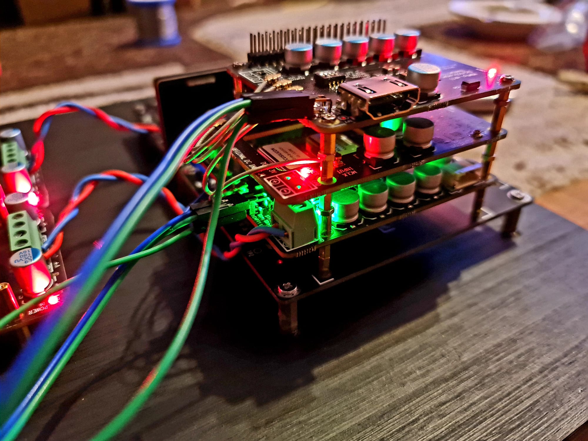

Finished yesterday evening building my Ian Canada stack.
It goes like this: RPI 4 on top of StationPi -> FifoPI Q3 w/Accusilicon AS318 -> ReclockPi -> HDMIPI MKII, signal path is being fed by 2 x LinearPi and the RPI is powered by a Samsung phone charger. In the near future I plan to add 2 x UcConditioner for the LinearPis. OS is symphonic-mpd.
Now comes the question for more experienced folks: is it worth (audio wise) to power RPI using another LinearPi (or other LPSU)?
Here are some pics: 😀

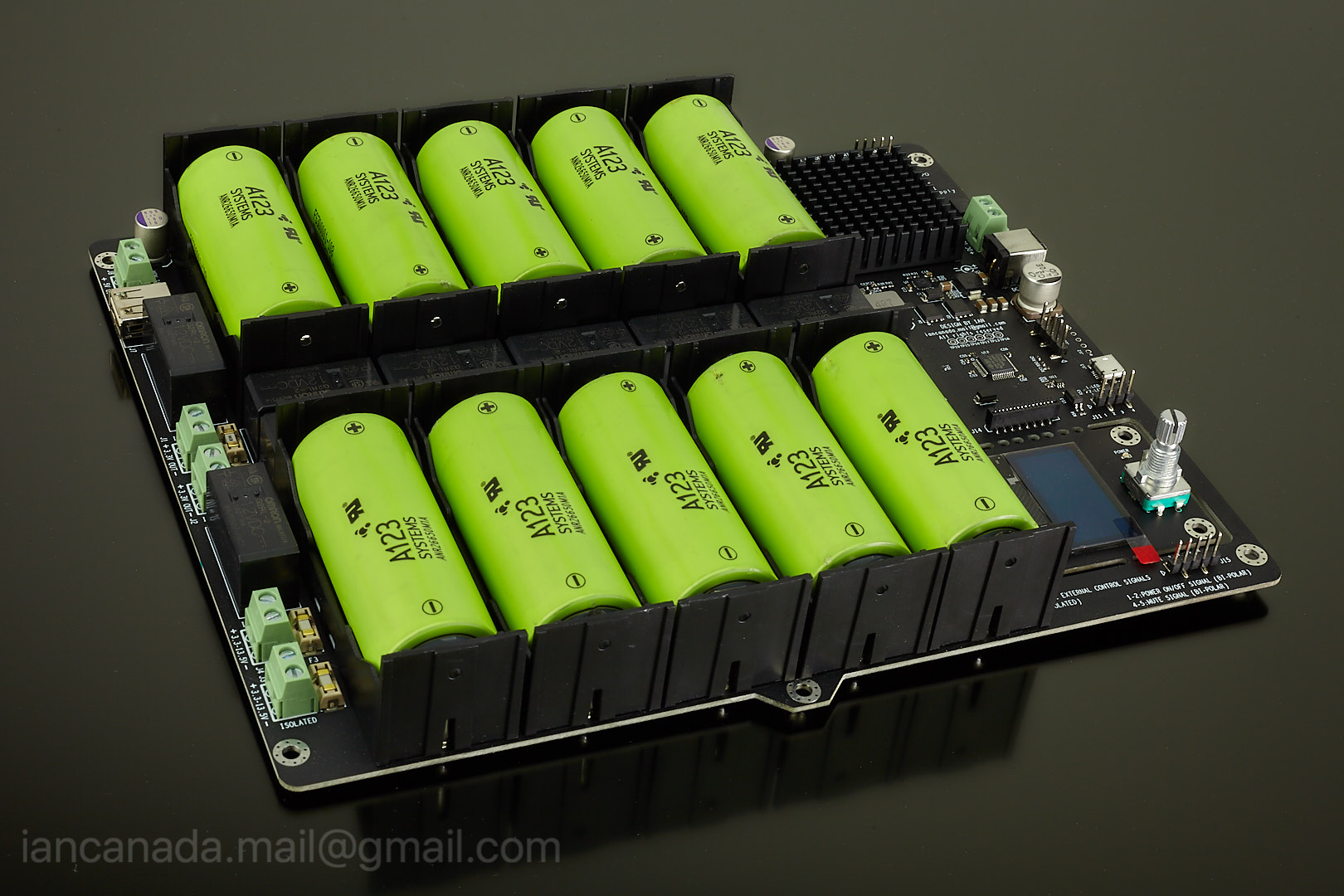

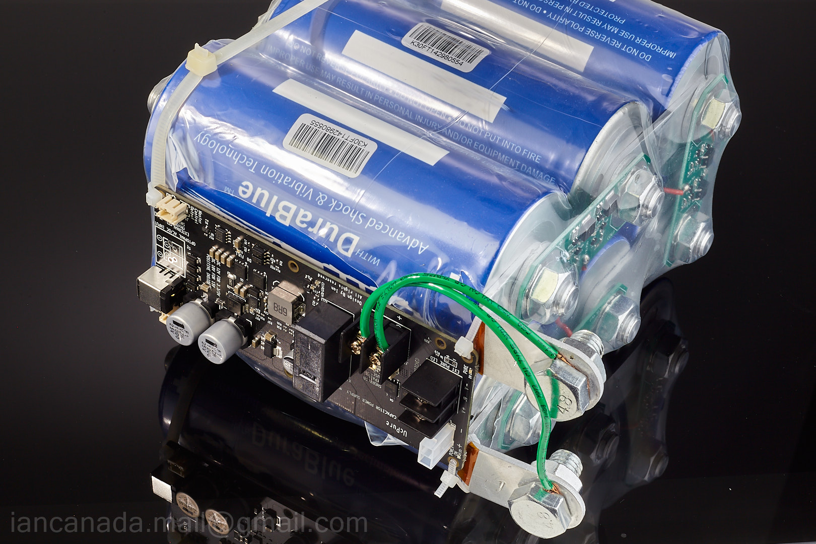

TWTMC DIRXO SC-cut oscillator needs a perfect power supply to achieve the best possible low phase noise performance. Three solutions were tested good by myself.:
1. UcPure 15V in configuration
2. LifePO4 battery power supply 13.2V output
3. Two LifePO4 Mini 6.6V in serial (13.2V in total)
No doubt, the UcPure 15V is the best solution. I’m really happy with the UcPure 15V and use it every day in my system for my DRIXOs. However, an ultracapacitor pack with six 3000F ultracapacitors could be a bit expensive.
LifePO4 power supply and the 2 * LifePO4 Mini 6.6V has no difference in sound quality. But the LifePO4 Mini 6.6V solution could be less expensive.
I do not recommend any active power supply or low noise LDO for DRIXO. Because the performance of clock oscillator circuits are very sensitive to the flicker noise or 1/f noise of the power supplies. Pure passive power supply could be a much better solution for clock oscillators.

...the performance of clock oscillator circuits are very sensitive to the flicker noise or 1/f noise of the power supplies.
Hi Ian,
Very interesting comment, thank you. May I ask how you determined the issue was specifically flicker noise, say, as verses other noise on the AC line coupling through into sensitive circuitry? Was it a process of elimination, or was DC power rail flicker noise found to be directly correlated with oscillator performance?
