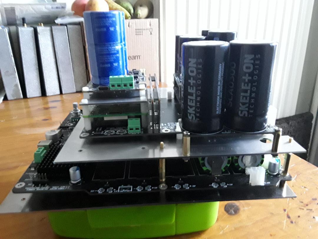

I bought the Skeleton ultra caps for the UcHybrid boards after the ones from Maxwell used by everyone were not available at Mouser for a LONG time.
Skeleton looks like perfect quality to me and being sold by Mouser is enough reason to get a few. If i remember well there is another member using them.
Of course it is up to each of us if they are willing to take a risk and buy something that might be good, perfect or just very bad at some Chinese shop. I wouldnt even use them if i got them for free.
Better be without the ultimate sound quality for 6 months than owning something that
could burn down your house.

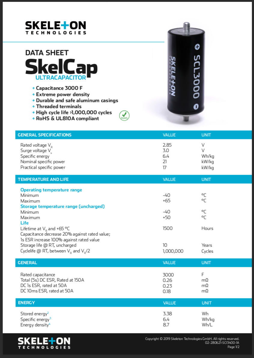

The datasheet looks even better performance than the Maxwell 3000F UC
SCI3400:
ESR: 0.17mOhm
Capacitance: 3400F
Voltage: 2.8V
Will mouser keep them in stock?
Ian
Note: I'm just an end-user, so please take these comments with a grain / pinch of salt. Conduct your own diligence before purchasing any of these mentioned products.
If your in the market now for 3000F, the Eaton that was previously mentioned should work fine:
https://www.mouser.com/ProductDetail/Coiltronics-Eaton/XL60-2R7308T-R?qs=Sd2AGZv2AHmr8s4Arrqy2g%3D%3D
The Skeleton Technologies ultra-capacitor is more looking forward than looking backward at Maxwell ultra-capacitors. The Maxwells are an unknown because you don't know how they are sourced and their business spinoff structure is also an unknown. The Skeleton Technologies control the whole chain within Germany. They are the largest European manufacturer of ultra-capacitors and are funded by the European Investment Bank. So this should pretty much be a known and a known quality.
There are two threaded models that may fit with the UcPure, the SCL3000 and the SCI3400:
SCL3000:
1S ESR (DC): 0.23 mOhm
Capacitance: 3000F
Voltage: 2.85V
SCI3400:
1S ESR (DC): 0.21 mOhm
Capacitance: 3400F
Voltage: 2.85V
Currently on Mouser, there is only the non-threaded 3200F model backordered for January 2022:
