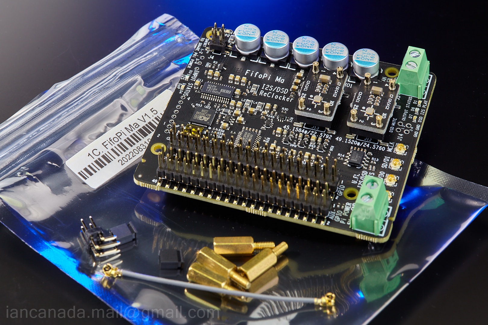

What type of performance difference (if any) is there between the TransportPiDigi and the FifoPiMa + HDMIPiTransmitter mkII? It seems like both options would provide I2S re-clocking (in master mode) and I2S to HDMI LVDS conversion/conditioning.
I'm also looking at galvanic isolation. Is the Isolator II the only option for Raspberry Pi? I recall Ian had an isolated HDMI I2S PI hat in the works few years ago, which does all of the above in a single board. Was it ever released?

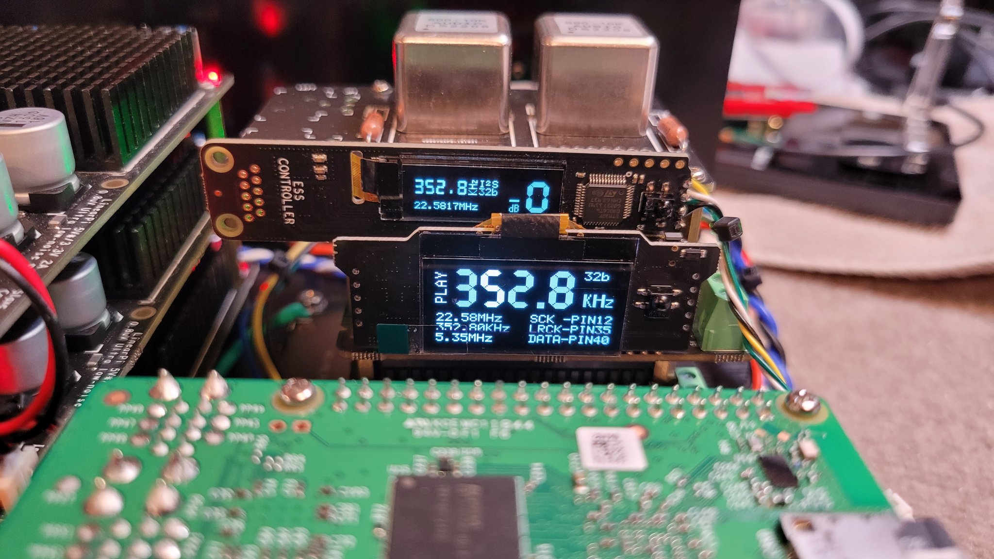

Hi all,
I'm having a particular issue with my current DAC build using some new boards from IanCanada. Specifically, the little OLED display PCB called MonitorPi. When it's attached to my FiFoPiQ3 I can't always get it to display anything because RoPieee (and RoPieeeXL) don't see it as a device. I've tried various other overlays as well. However, when I remove the MonitorPi and replace it with the normal ESS controller display, everything plays fine and works as expected. When I can get the MonitorPi to display real-time frequencies on the screen, I get no music. Odd.
Has anyone else experienced similar anomalies when using the MonitorPi. I'm using the StationPi Pro (SPP) with RPI > ConditionerPI on the RPI side, and ReceiverPi > FiFoPiQ3 > ES9038Q2M Dual DAC > Transformer Output. Ideas.
Hi all,
MonitorPi doesn't need a Linux driver, Please keep everything no change when you use the the MonitorPi.
Another thing is that the your ESS DAC needs the ESS controller to operate, so you have to keep the ESS controller even if you installed the MonitorPi.
Maybe later, I will consider to integrate the ESS controller function into the MonitorPi.
Ian
Ian
Ah ha. I wondered if the old ESS controller needed to still be attached! That's it then. I never noticed any pictures with both shown. Just plugged both in and voila, it works. I should have tried it earlier.
