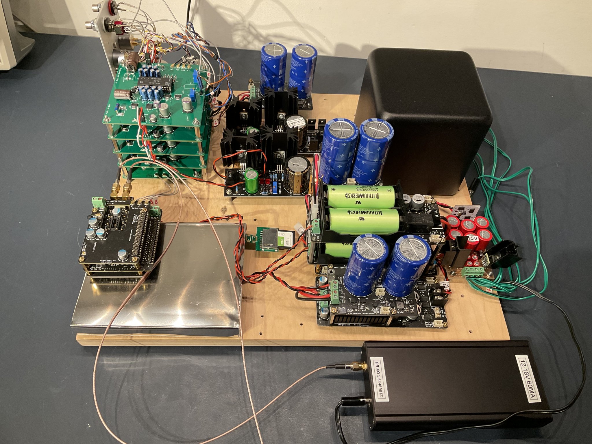

I’m interested in the sound of a NOS R-2R DAC, so I bought a Holo Spring 3 last month. After three weeks break in, I have to say I like the sound more and more.
The output voltages of Spring 3 are RMS 2.9V/RCA and 5.8V/XLR, so the sound levels are a bit higher than standard DAC output levels which are RMS 2V/4V.
Spring 3 is a typical NOS R-2R but with higher accuracy than many others because of the compensation technology.
The sound is very impressive but the style is different from the popular Delta-Sigma DAC, with great transparency, higher density, more details and dynamic, more natural. The 3D image is very solid. The sound is also very clean because of the black background. Those are typical R-2R DAC sound signatures. Spring 3 could be the best R-2R DAC at this price range.
However, when comparing with my well running-in FifoPiQ7/9038Q2M Dual Mono/OPA861I/V DAC system (With 90/98MHz OCXO), What I’m not happy with is that the 3D instrument image of the Spring 3 was pretty big so the whole soundstage was not that pin-point focused and delicate. I will also feel a bit tired after listening to it for a longtime.
Spring 3 uses an internal PLL as the audio MCLK, I believe that could be the reason. Fortunately, Spring 3 has an I2S/DSD over HDMI input option, so I’m wondering if I still have a chance to improve the sound quality of my Spring 3 by feeding better external I2S/DSD signals with higher grade clock to it.
I’m gonna try my new flagship FifoPiQ7 + HdmiPiPro + MonitorPi + PurePi ultra-low jitter network streamer transport solution with my Spring 3.
Somebody said that the R-2R DACs are immune to clock jitter, but it could be not true.

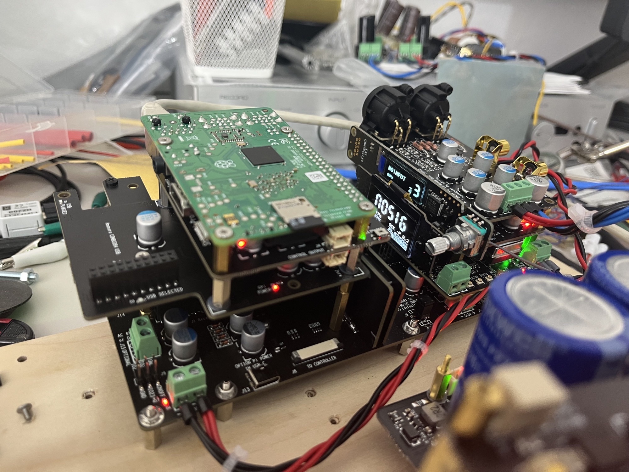

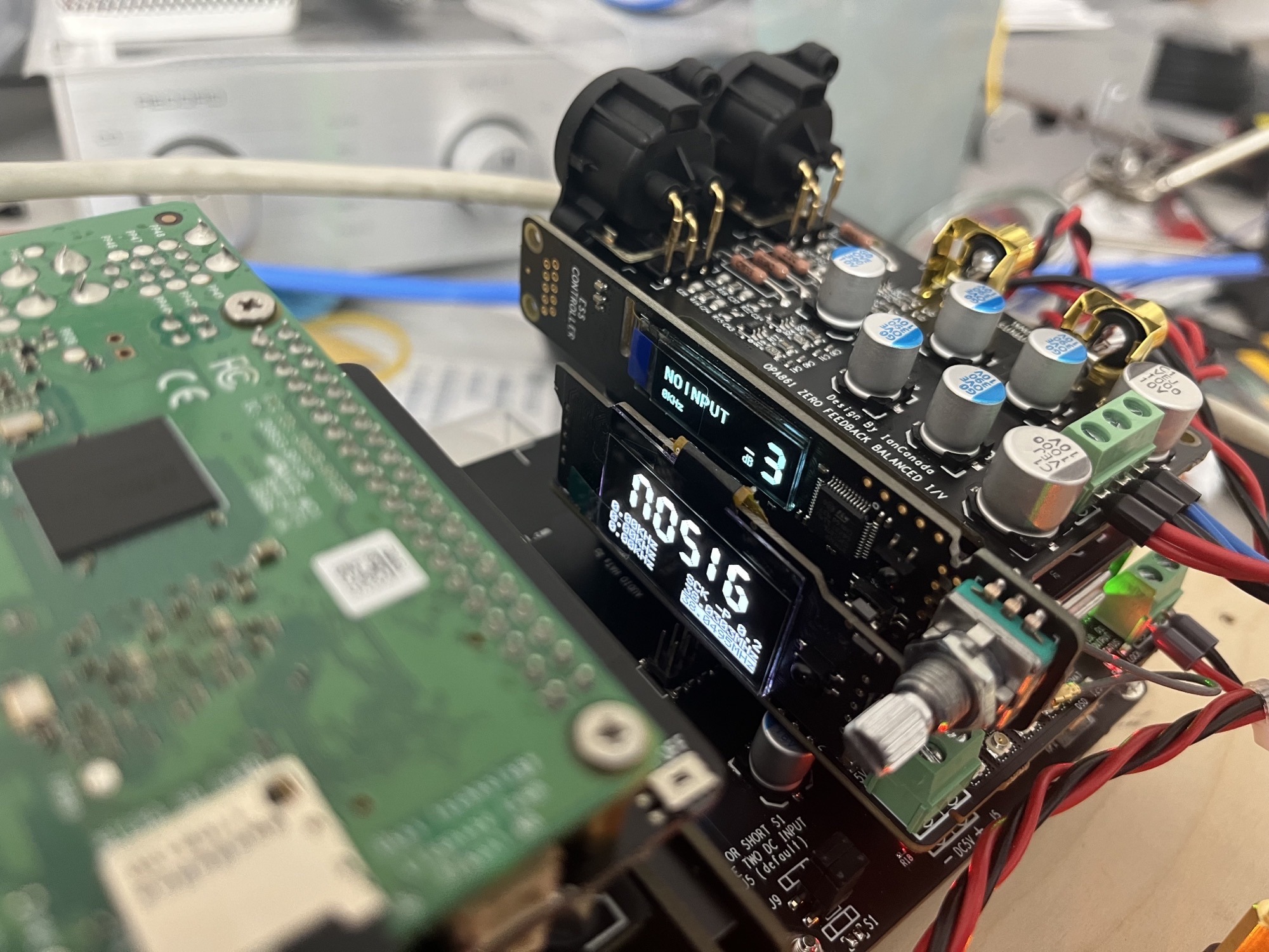

Hello Ian,
Pls could you give me some advice.
I build a Raspberry stack with StationPro, ReceiverPi, Fifo Q7 and some additional boards. I can see the system in Roon and play music. However there is now output/input on de Fifo as you can see on the MonitorPi and ESS controller.
The previous setup with Raspberry and MonoDAC worked fine.
Any idea what could cause the problem?
Thank you!!

From the pictures, MonitorPi shows that FifoPiQ7 got wrong XO frequencies. Please read the user's manual troubleshoot section for the solutionHello Ian,

The Accusilicon pin 1 pull up resistor behaviour caused the problem. Bending this pin solved the problem. You described it in the Fifo-manual.
I'am very impressed by the sound quality!

I'm glad the issue was fixed.
I really like the MonitorPi, it shows all the real status and makes it much easier to debug the system.
