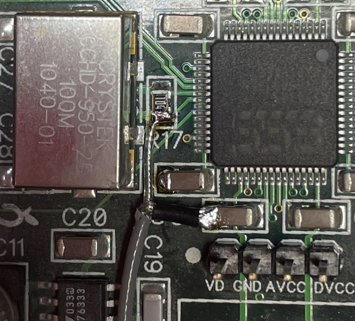

Yes, I know I'm little bit late...Feed MCLK to BII to run the ESS DAC at SYNC mode can make a great improvement to the SQ. That's what we did for many years.
Anyhow I just made the MCK connection to BII DAC. I have to make some more listening but I've noticed a deeper and more detailed soundstage with Synchronous Clocking.
This BII have a TP IVYIII I/V output stage that have OPA1632 and it sound a little bit metallic. I'm curios to try your I/V board with OPA861 but it have only balanced out.

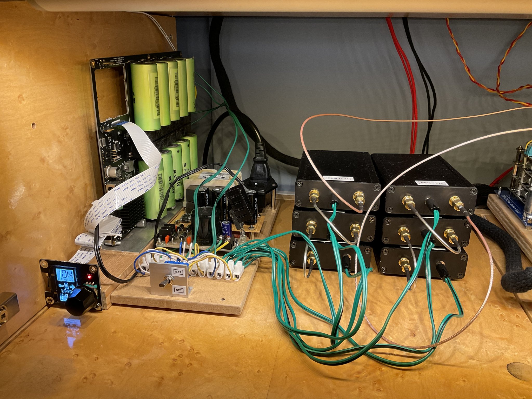

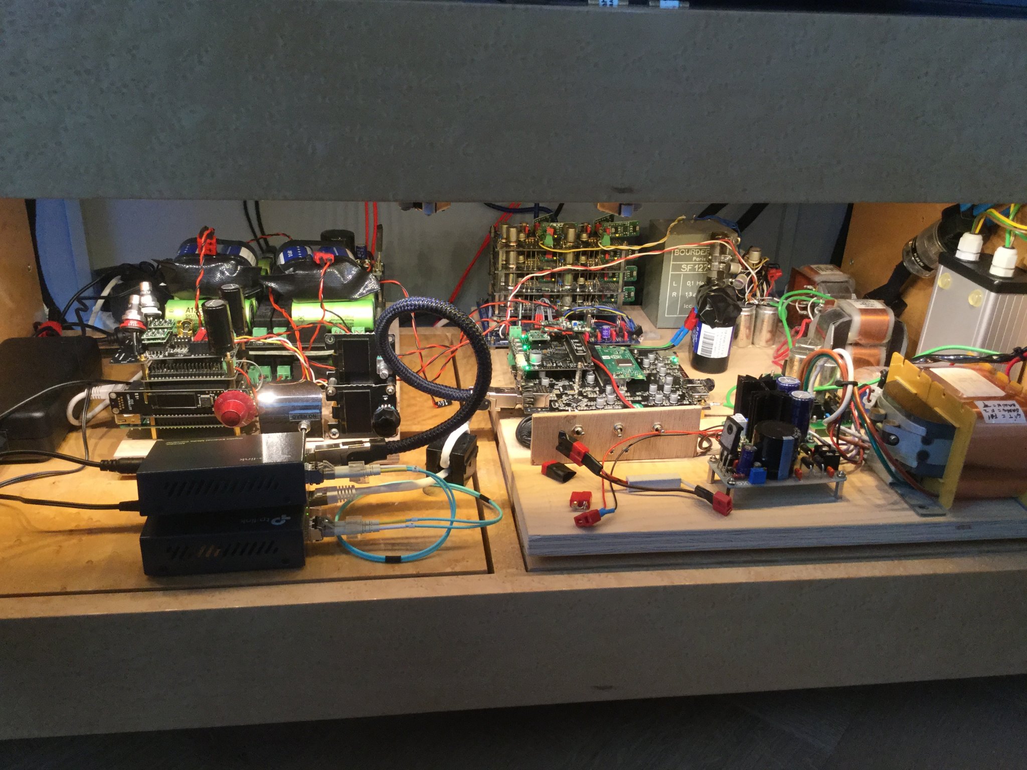

I like Ians products, I own a lot of them and put them to good use as you can see in the pictures. But my experience in dacs is that multibit sounds more natural than delta-sigma. Hopefully Ian will try this route, with his knowledge he would be able to make a nice multibit dac I presume.Hello Supersurfer,
