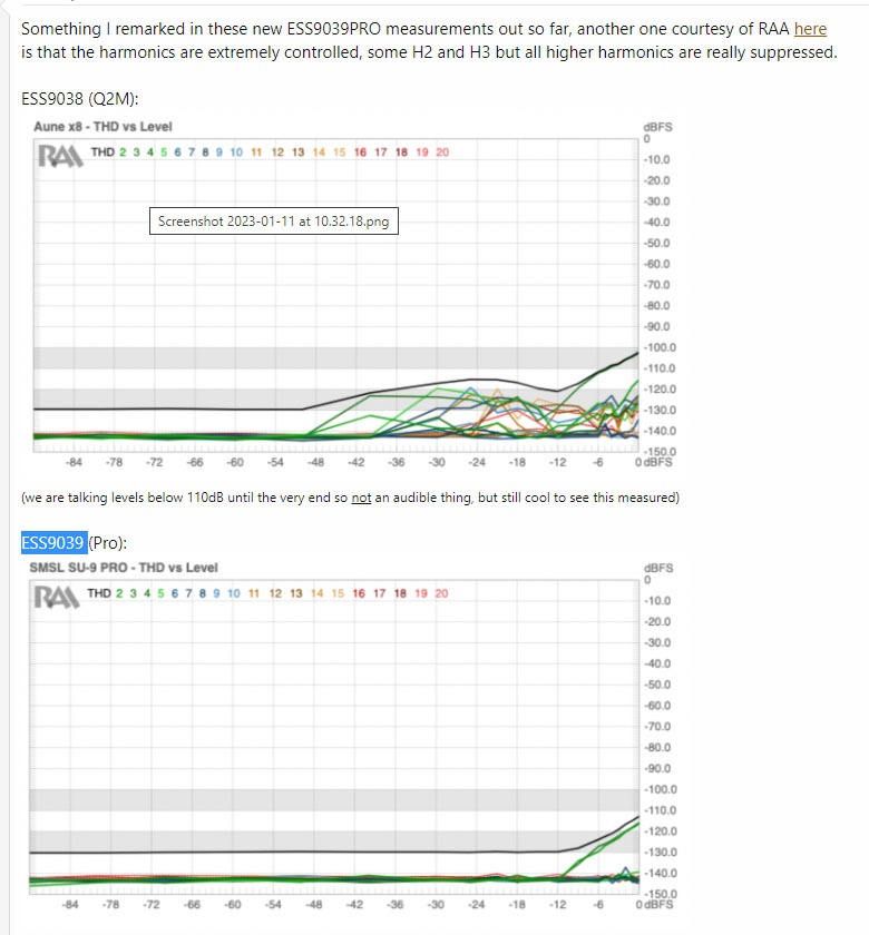

Hi Ian,But if I have time, I'll develop a ES9038 Pro DAC.
That would be a great thing!
Why not a ESS9039PRO Dac?ES9038 DACs are so far the best DIY DS DAC. But has to be run at SYNC mode with decent clocks. ES9038 Pro is basically more ES9038Q2M in parallel. I like my ES9038Q2M Dual mono DAC with OPA861 I/V stage. But if I have time, I'll develop a ES9038 Pro DAC.
https://reference-audio-analyzer.pro/en/report/dac/smsl-su-9-pro-fast.php#gsc.tab=0
ES9038 Pro or ESS9039 Pro, you can count me inESS9039 has built-in MQA decoder. But I'm not sure if it works at SYNC mode, or it has good sound quality. I'll see.

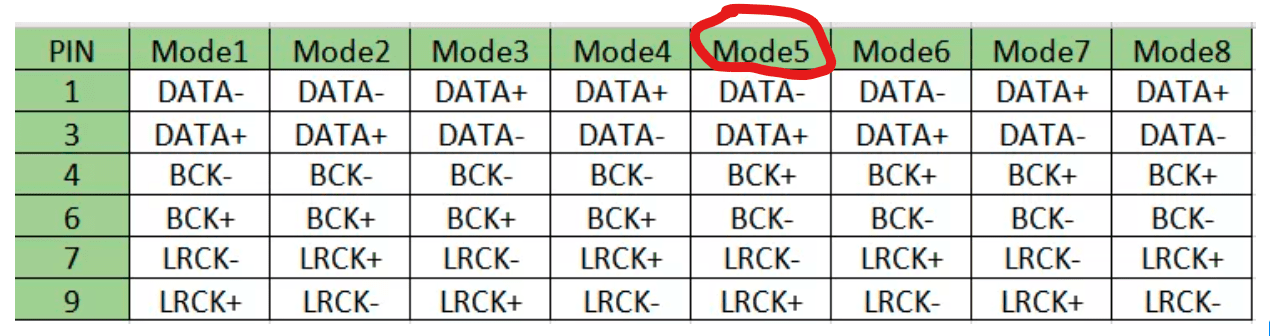

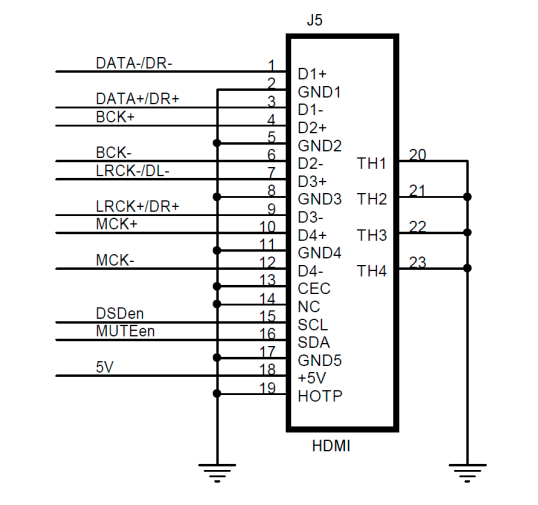

Hello @iancanada , all!
I am using FIFOPi Q7 with HDMIPiPro connected with a straight HDMI cable with Musician Audio Pegasus DAC.
Based on HDMIPiPro output connector pinout and the DAC's manual, I am using MODE5 on DAC settings, but the channels are inverted.
What do you think could be the problem?
Thank you!

Please try Mode6 if channel inversed. The DAC user's manual may not be 100% correct.
Thank you for your answer.Please try Mode6 if channel inversed. The DAC user's manual may not be 100% correct.
I tried all modes and the channels are inverted on MODE 4,5,6,7. On MODE 1,2,3,8 the channels are not inverted. ALL MODES are in phase.
What do you think?
(all tests was done in PCM).
For PCM music, LRCK decides the left and right.
LRCK=0: left channel
LRCK=1: Right channel
https://www.sparkfun.com/datasheets/BreakoutBoards/I2SBUS.pdf
The user's manual of you DAC looks unreasonable, could be something wrong.

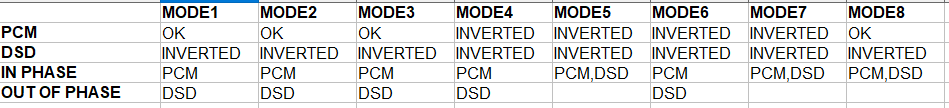

I made tests on all 8 modes of my DAC, using flac and dsd files from "Channel Test Tone By Jeffrey Richards" and this are audible results:
Seems like MODE5 and MODE7 have no "out of phase" neither on PCM or DSD, but the channels are inverted.
Anyone here with this combo HDMIPiPro and Musician Audio Pegasus DAC?
Seems the Mode5 is correct, but the DAC inverses the channel internally somehow.Thank you again!
