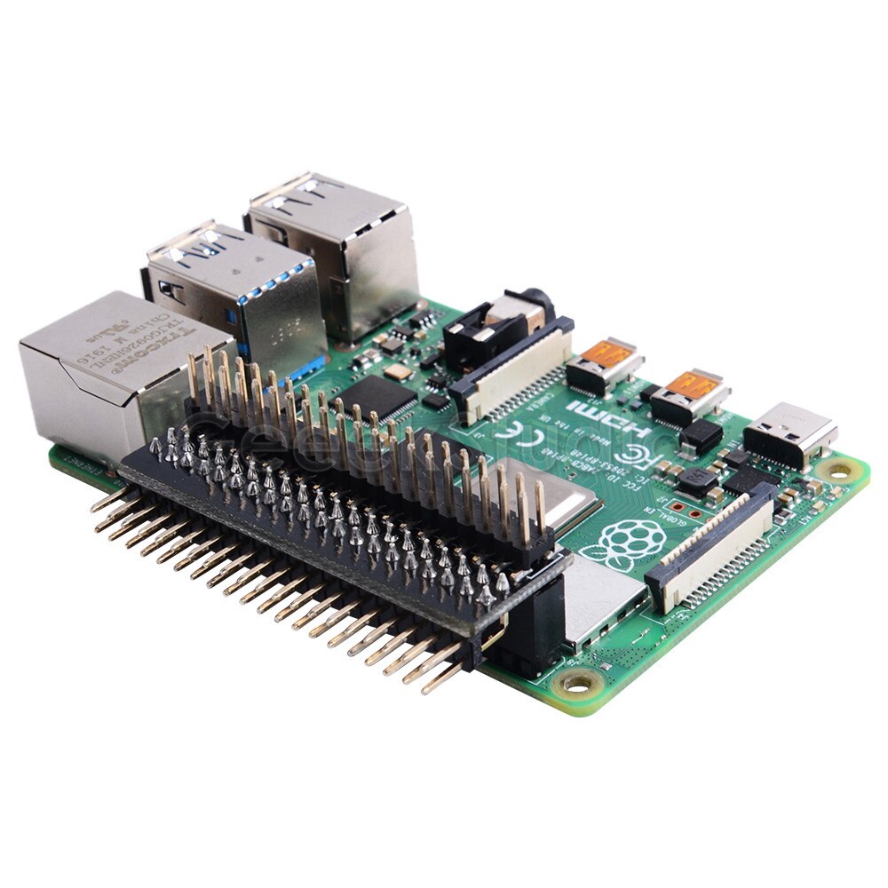

Hello all.
question, I recently got an raspberry pi 4 an IsolatorPi II and a FifoPi Ma v1.5, works and sounds fantastic.
now I would like to connect a rotary encoder, infrared, mpd oled and an audiophonics power module to this, but I run into a problem.
via the gpio aux of the FifoPi Ma it doesn't work, via the gpio aux of the IsolatorPiII I can't get to it, no space to connect plugs.
what is the way to make these things work? because I can't figure it out.
