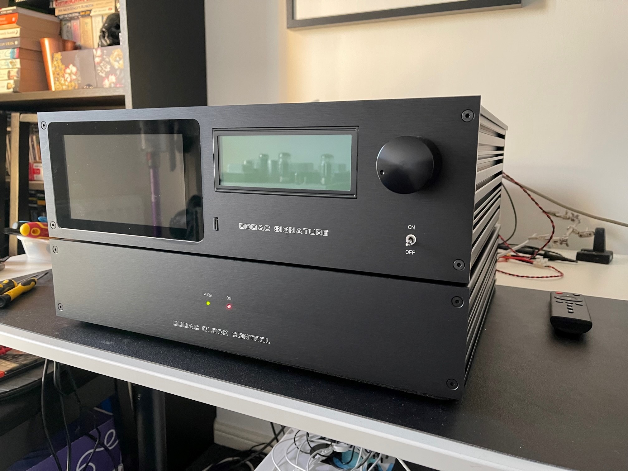

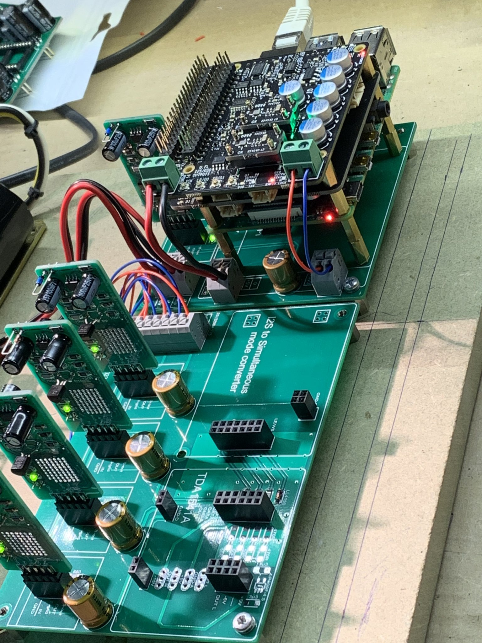

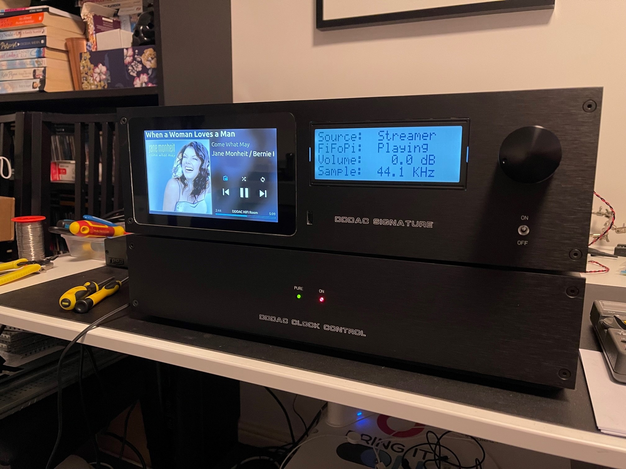

@redjr Thank you for your kind comments
......this project was a very long process which was REALLY enjoyable.
I used an Arduino which is a super system to enable you to build anything you want and a simple programming language, do you know Arduino?
In the last picture I have highlighted below where the Arduino resides.....its actually connected underneath the customer designed PCB. Really fun to build PCBs and to write the code but I must give a shout out to my friend Doede for his great support and assistance when I did this part of the project. FANTASTIC DIY audio community helping each other - the best!
You're welcome. I am aware of Arduino, just never thought of using one along aside an RPi. My programming skills are a bit weak.
I may have to reconsider this idea. Would you share the Arduino code and interface points(GPIO)? I probably have a 4-line display around here someplace.

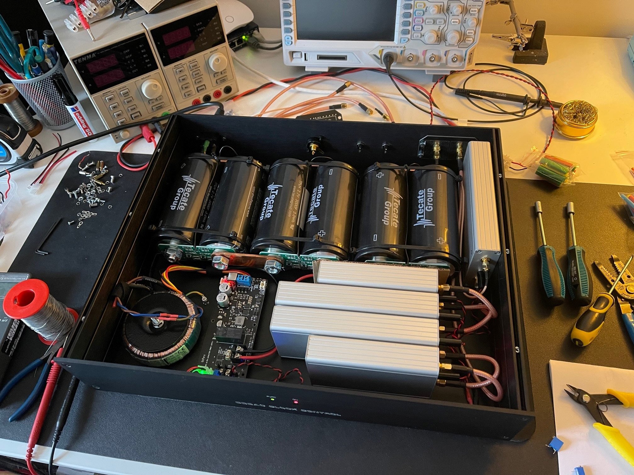

That’s one serious dac, Simon.
For me was the last upgrade with UcPure-Eaton 3000F, feeding the clocks, almost a gamechanger.
I just wonder how much better dddac will be with UcPure/Eaton replacing the rest of the psu’s.
That said, I think clean power to the clocks is very important, and UcPure/Eaton proves it. Hearing is believeing.
Thanks you @smooth dancer and 100% agree with you that the power suppliers make a HUGE difference in the sound. It makes senses as the audio wave form itself cannot exist without the power supplies, the cleaner the PSU (s) are the better the wave form

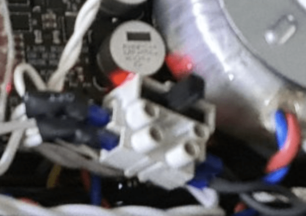

Nice work! in your photos it seems you connected all transformers to this (in pic). What is it called?Today I built all the eaton supercapacitors and modules in a case.
Everything works perfect I also listened to the usbridge signature with the eaton supercapacitors this is also a good combination much beter than the shanti power supply.
But with the ian modules I make a step forward this is a beautiful sound nobody will regret how this sounds, so open and transparant.

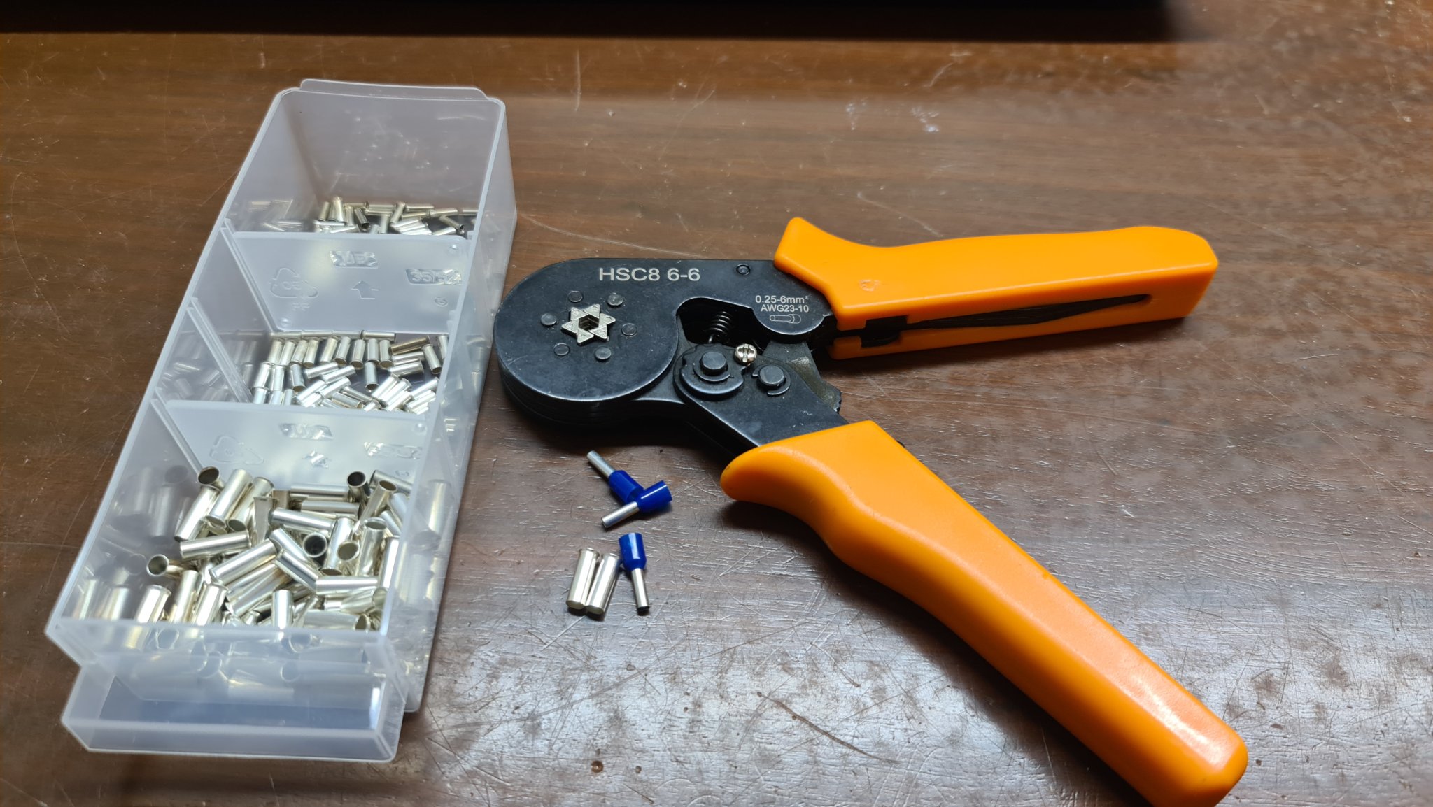

Hello,
Looks like a good one. Most diy folks have one tool that they use for all kind of connectors.
There is a lot of quality difference in the tools.
Most people will think i only need to crimp a few connection let us buy a cheap one and then they end up with 50% of the connections being bad.
Greetings, Eduard

Could you please give the link to "kroonsteen" (i think they are called terminal block here) . I could not find one with fuse in them.The transformers are 50va each so I have no problem with that.
I have a special crimping tool to connect them together 😉
We name it a kroonsteen and there is a fuse inside.
