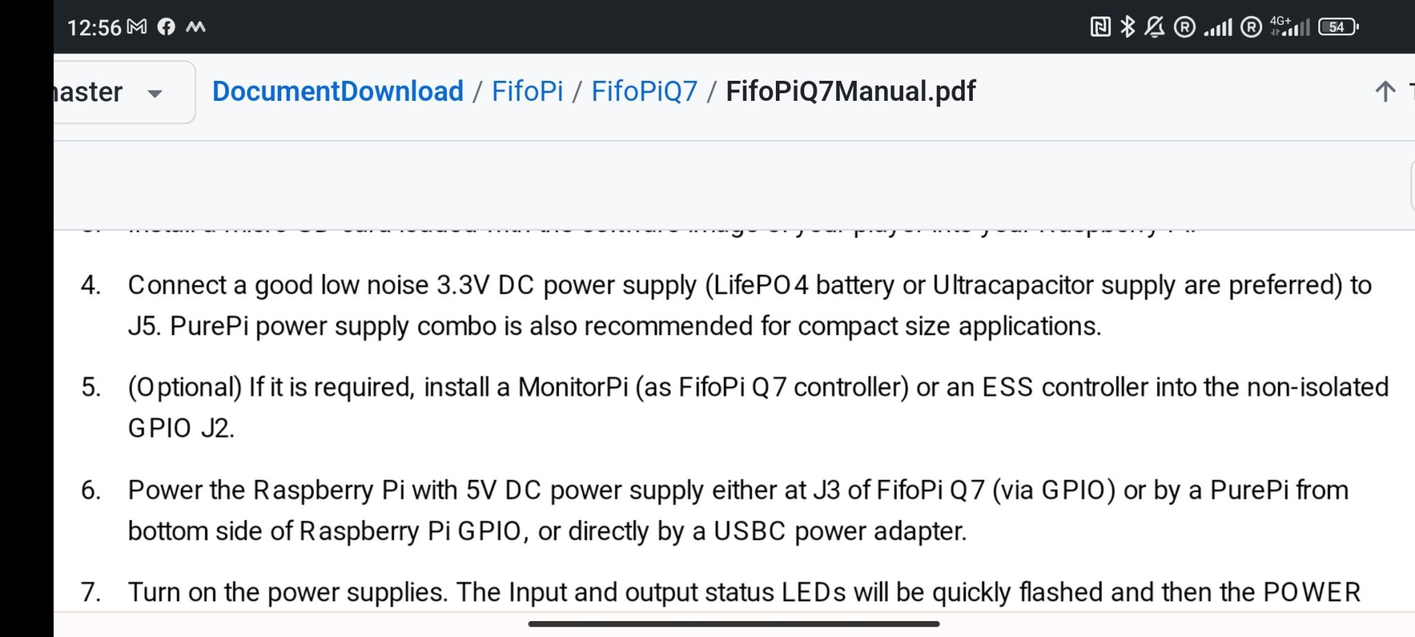

From the same manual
You can power your RaspberryPi via GPIO through J3 to the RPi USB power connection. To do so, connect a 5V 2A DC power supply to J3, MAINTAINING CORRECT POLARITY!!! DO NOT connect power to J3 if you already power your Raspberry Pi by a PurePi to the GPIO at the bottom side, or via another method, such as the Micro-USB port. FifoPi Q7 has much powerful FIFO engine, so it’s need 5V power supply for J3. FifoPi Q7 will not work if you feed 3.3V to J3
Like i suggested before someone with the right knowledge and '' software skills '' should make a few drawings like this where the most used configurations are visualized . Not all members here are used to read English manuals and also not everyone can write a manual that can be understood by people with another native language.
This thread could be a kind of free marketing tool IF the information is clear to grasp for non technical potential customers as well. Potential customers must have the idea this is the right way to go and if i run into trouble there will be help. Right now that is a bit of a mixed bag.
Greetings, eduard

Ok
Thnx for the clarification!. The picture of the Q7 and the word "optional" in the headline is not helping indeed.
Can i assume that the power on J3/rpi/fifo is supposed to be 'dirty side"?
So a bit simpeler power supply will be ok?
And if i think about it...
If you put the FifipiQ7 ontop of a powered rpi... The 5V is also provided via gpio.
So in most cases: rpi powered with 5v and ontop of the rpi a Fifopi powered with 3,3v
= Working setup

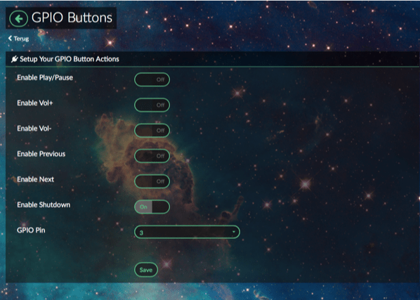

Hello,
Is there any way to safely switch ON and OFF the RPI? I’m using the shieldpi pro, switching off is possible with settings in GPIO buttons according shieldpi pro datasheet. But
How on earth get is back ON, without disconnecting power supply?
i use this code (boot/config.txt) for only safe power of and then gpio pin 13 and ground.
dtoverlay=gpio-shutdown,gpio_pin=13,active_low=1,gpio_pull=up=gpio-shutdown
if you use volumio there is a plugin for it then set to gpio 3 i think you can then shut down and boot.
I use this button for that.
https://www.audiophonics.fr/en/push...th-blue-light-circle-o19mm-black-p-11061.html

Hello
Greetings, eduard
The issue is Ian offers many modules and combinations and that makes it harder to make simple drawings. FifoPi needs 5v and 3.3v and the 5v can come from different places, for example is you use any of the stationPi options you power the 5v to the stationPi and the that powers the 5v on the Fifop.
you then only need to supply the FiFoPi directly with 3.3v……once you understand this it is easier

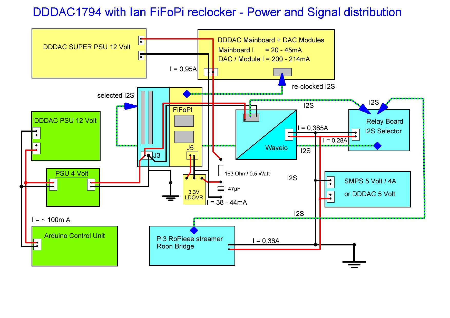

Hello,
It is true there are several combinations that can be made and it is generally accepted that the 3,3 volt for the fifopi should be the one where the money goes.
But with the right software it is a piece of cake to remove one board from a complete set up '' picture '' and replace it by another board.
Yes in the end we could end up with a pile of drawings but we also have a pile of manuals.
In the end you will just have to select the drawing that is applying the boards you bought and laminate it.
