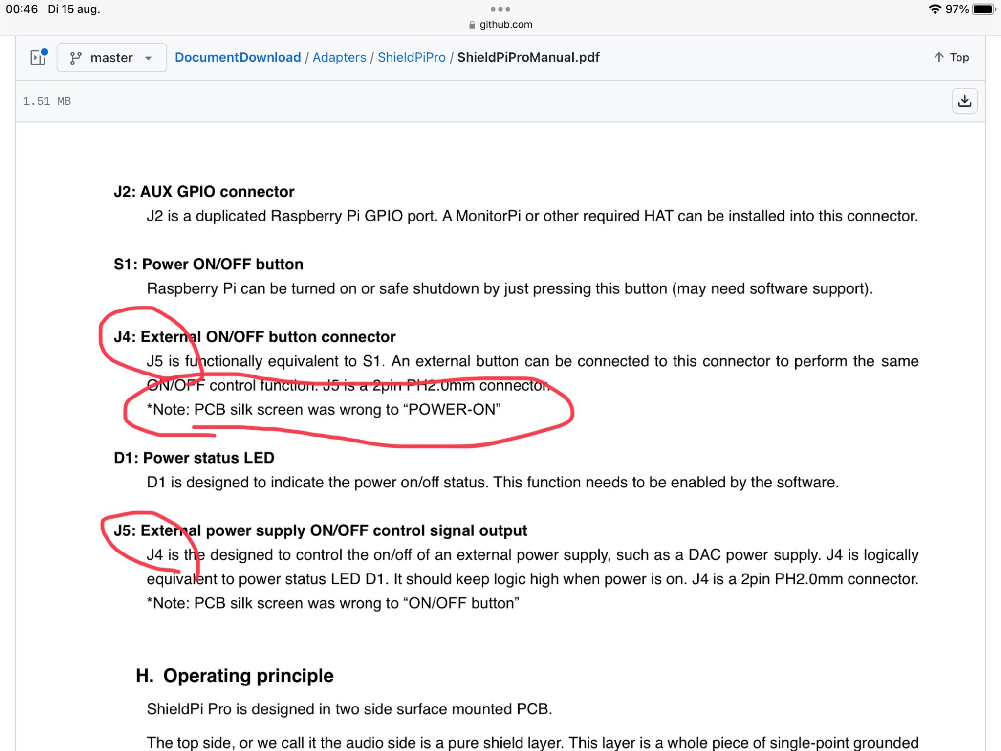

Ian, thanks for your superb products!@ Bensen
I have no any problem with ShieldPi Pro and the MkII. Please just follow the user's manual. It's very easy.
https://github.com/iancanada/DocumentDownload/blob/master/Adapters/ShieldPiPro/ShieldPiProManual.pdf
BTW, safe start up is the Linux feature which has no business with any software. But have the use the most updated RPi hardware.
Again, just follow the user's manual.
Ian
But, sorry, I did accurately follow the manual of the shieldpi pro. The manual of the shielpi pro MKII has been partly updated , similor with my findings. However not fully perfect yet.
My goal of mentioning this here is not to give critisism to the product or manual, but to help others with possible same issues.

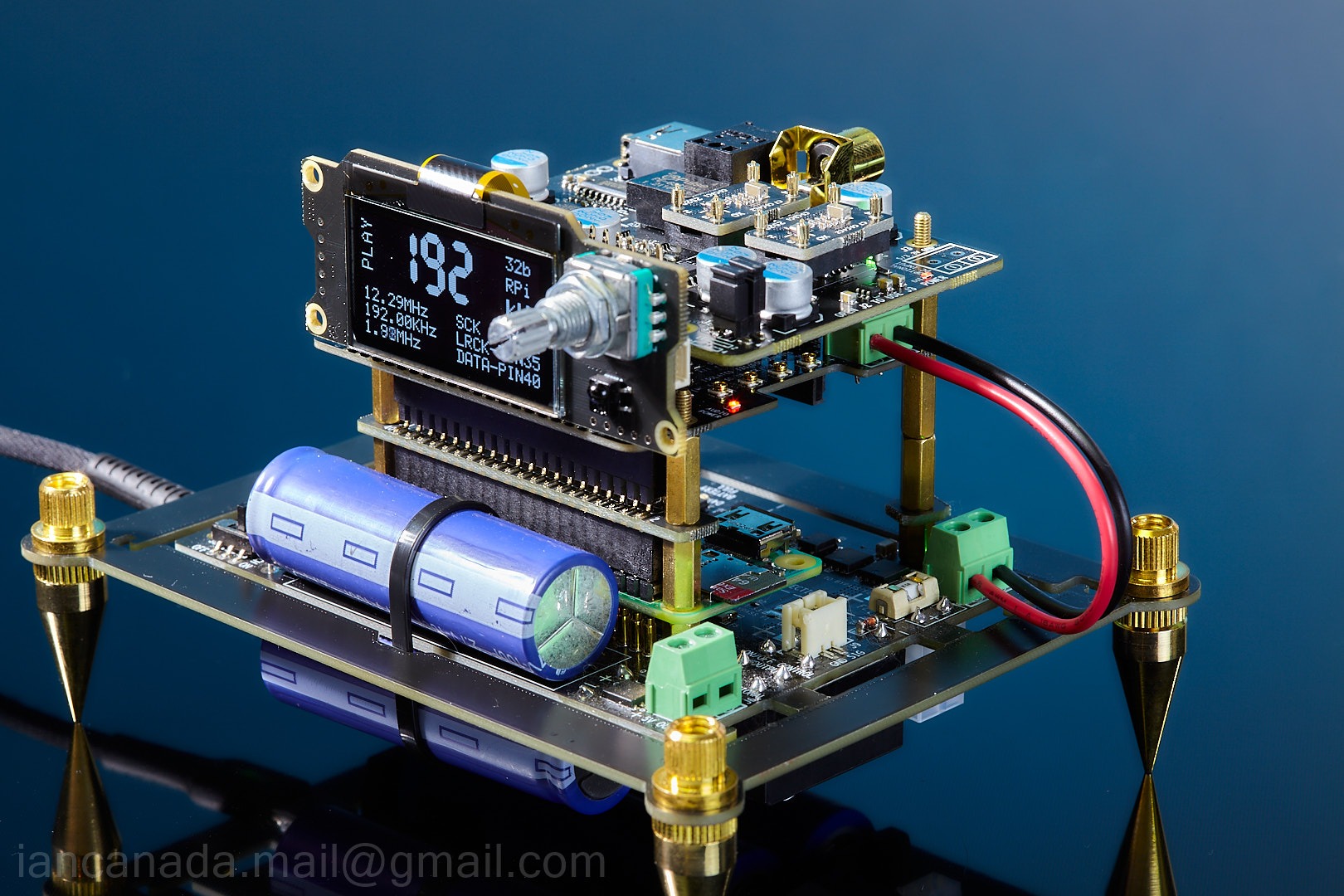

How to upgrade a TransportPi Digi with a IsolatorPi
TransportPi Digi’s performance can be upgraded greatly by cutting the noisy ground loop between the RaspberryPi with an IsolatorPi. The setups can be just:
1. TransportPi Digi
2. IsolatorPi
3. RaspberryPi
4. MonitorPi Pro or MonitorPi (optional)
5. PurePi power supply
The 3.3V isolated battery output of the PurePi should be connected directly to the J1 of the IsolatorPi. For the master mode isolation configuration, J13 has to be jumped by two jumpers while J12 keeps open.
TransportPi Digi doesn’t need any change just keeps everything default. As long as feeding the 3.3V to IsolatorPi J1, we can short the S1 of the TransportPi Digi later to lower the power supply ESR more (optional).
However, as an early design, the IsolatorPi may not have enough drive strength to drive the two XO select signals so that there could be a problem when playing 48kHz family music. If that’s the case, the solution will be simple.
You just need to solder a 360 ohms 0402 size chip resistor in parallel on top of the R36 of the IsolatorPi. The P/N of the resistor can be RC0402FR-07360RL or any others.

Thanks for pointing out.Ian, thanks for your superb products!
User's manual has been updated.

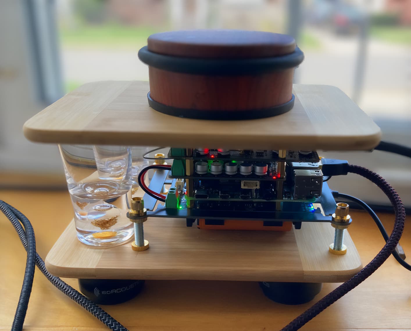

Ian and the good ppl here,
I ordered some 3M AB6005S EMI suppression sheets to add to my noob stack. I currently have it set up as the following
1. HDMIpi Pro
2. FifoPi Q7
3. Rpi 4
4. PurPi
I just ordered a UcconditionerMkII 3.3v, and it will be added to the stack in the next couple weeks.
Any pointers or experience where is the best spot to apply the 3M sheet? Is underneath the pi arm chip a good spot(Heat sink already installed on top of the chip)? How about sheets on the short power cables? Monitor pi cables? Unused USB ports?
Attached a pic of my current stack. The shot glasses are to fill the empty space reserved for the UcCond MK2.

@wudai_e
That's a good idea. If you run a phase noise analyzer, you will know how much phase noise generated by vibration, especially for the close-in.
Yes, anti-vibration would be very important if you use the ultra-low phase noise clocks.
Please let us know if you have new updates.
Another thing could be the thermal isolation, but that would be a long story.
