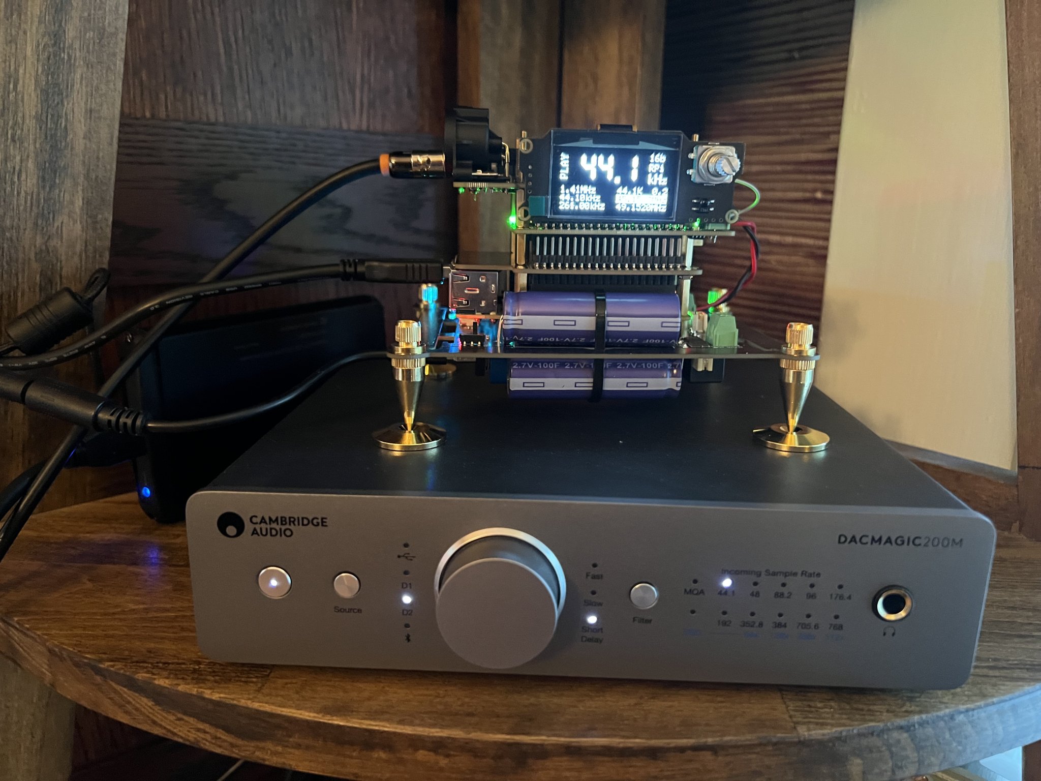

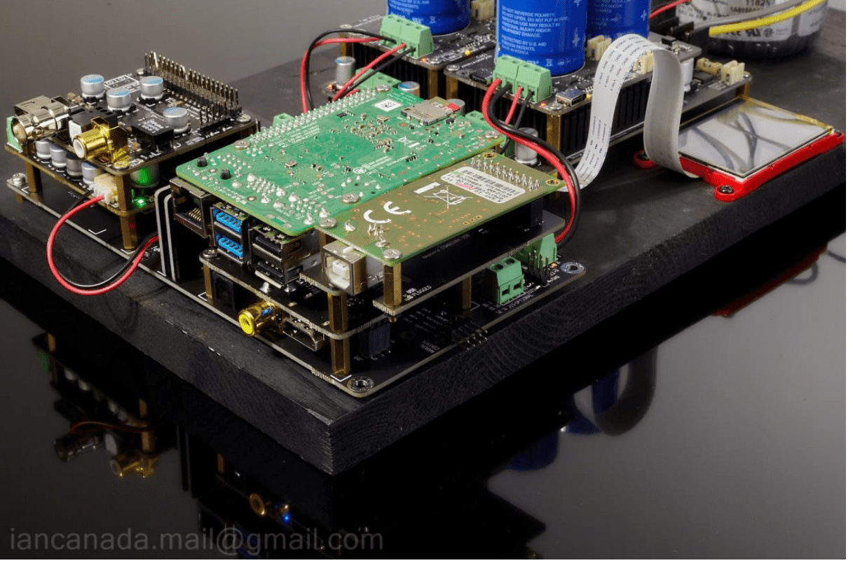

New build. Thanks to @iancanada for the great hardware and advice and @Gabster 2000 for some of his videos.
0. Spike Mounts until i figure a nice home to put in. Looks like a Lunar Lander!
1. PurePi
2. RPi3B | USB Flac Drive w Volume
3. ShieldPi Pro
4. FiFoPiQ7
5. MonitorPi Pro
6. TransPortPiAES | Coax PCM out
7. DACMagic200M Coax PCM in
Blown away by the clarity, transparency, sound stage and lush fullness of this thing.
Makes my Cambridge DAC Magic 200M sound like it should through the coax input streaming the IAN Pi Stack through it.
The Cambridge DAC bluetooth input is Shite compared to this - thin and fragile - same with the USB input.

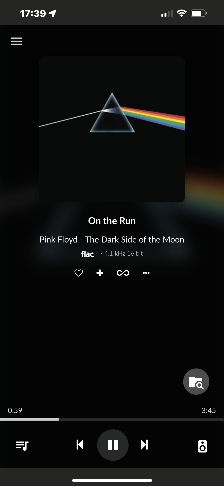

I’m playing off FLAC on PiUSB and via Apple Airplay CD Audio quality - both fantastic. I actually can't tell them apart aside from the odd AirPlay dropout due to my Wifi. Now to put iFi wifi filters on my gear.
Revealing more source than I've ever heard in a 16b44.1 file before. Like listening to a CD for the first time in 1980.
Jitter? What Jitter?
Gonna build a DAC pre-amp next.
Cheers
John

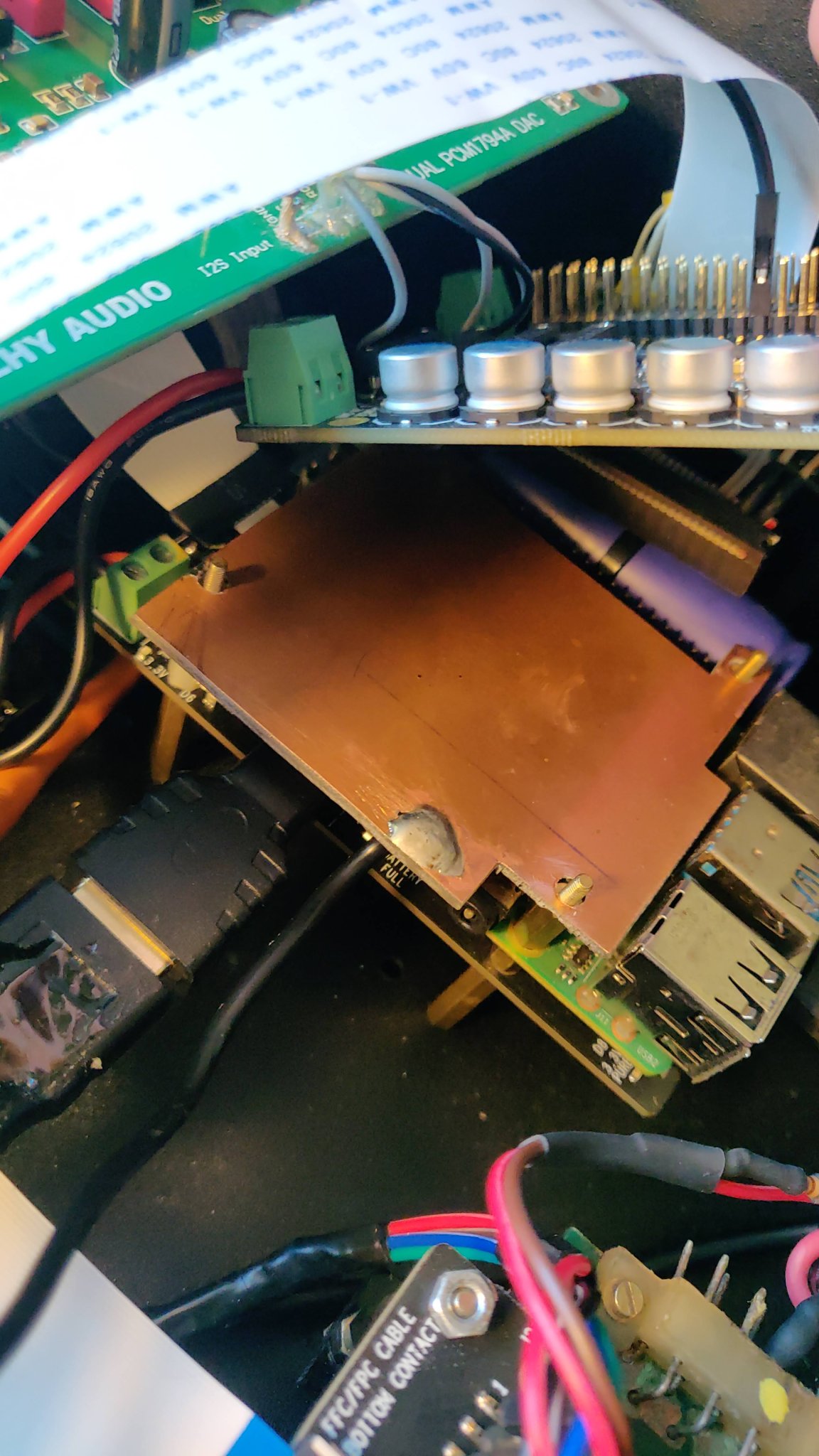

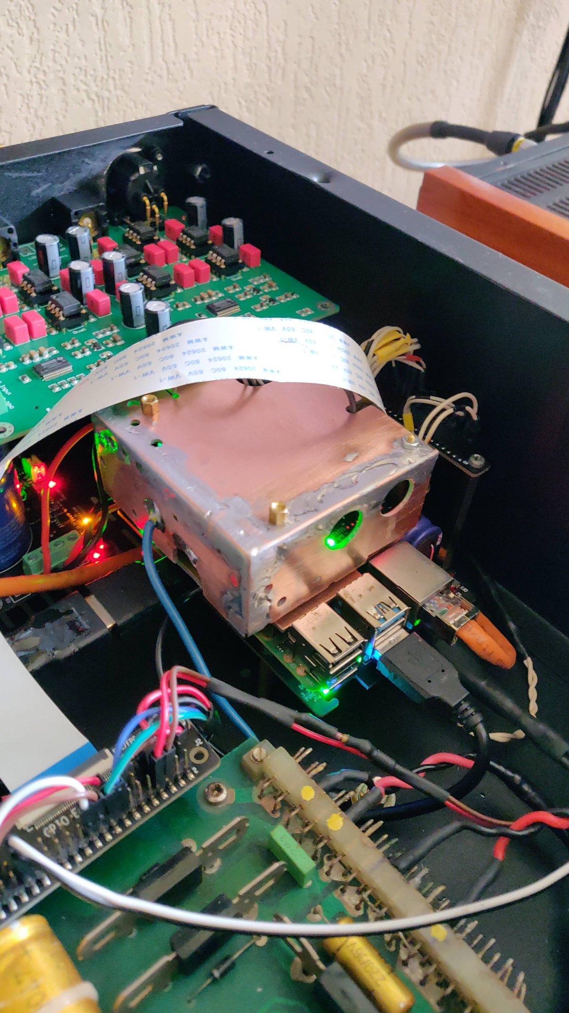

made a copper shield based on video gabster.
shield for the pi I think I hear a little less noise, the FiPiMA also shielded but no improvement here.
Understanding Shielding with a Raspberry Pi in a HIFI Dac. How to Measure noise with (simple tools)
later i saw that ian canada has a shield pro that does the same.

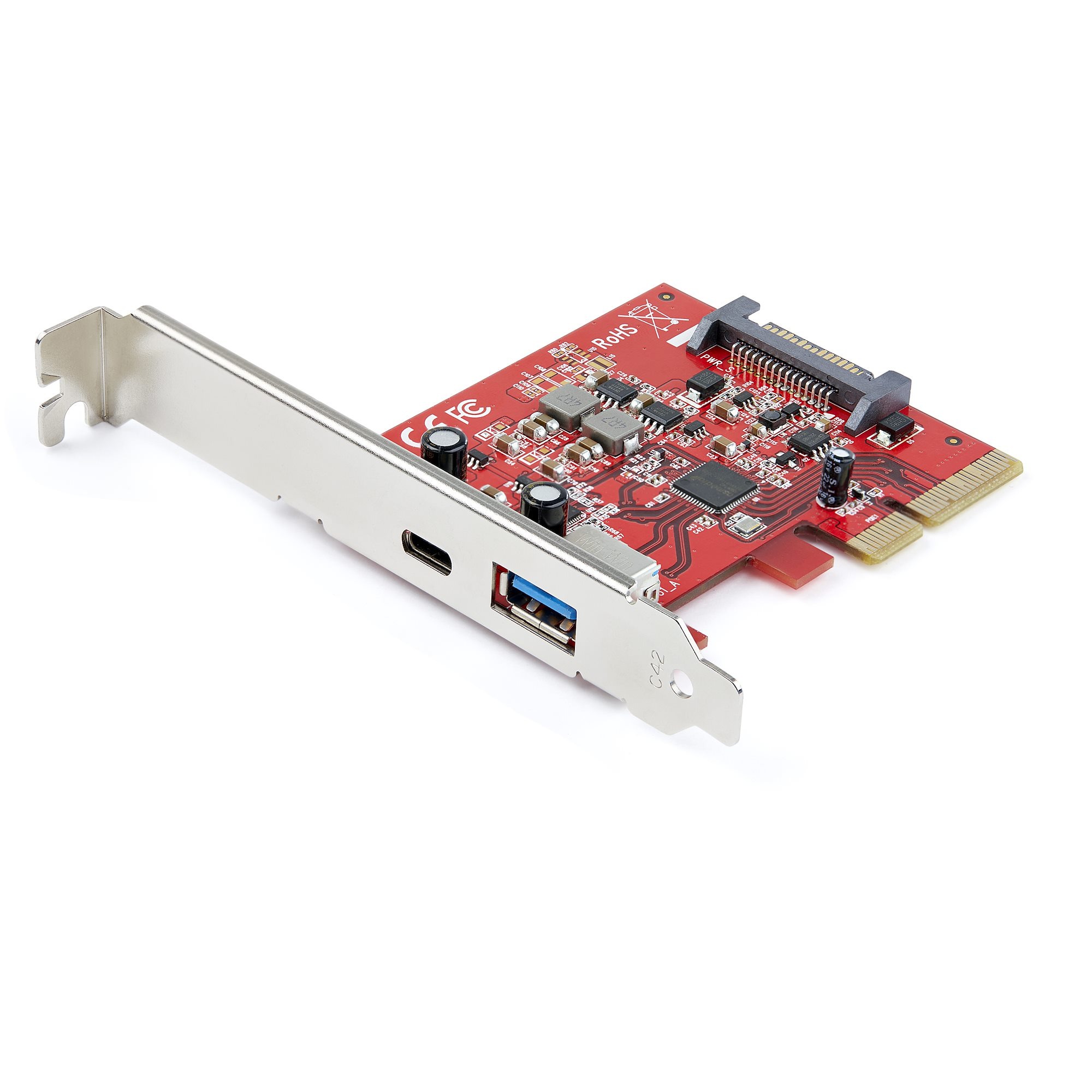

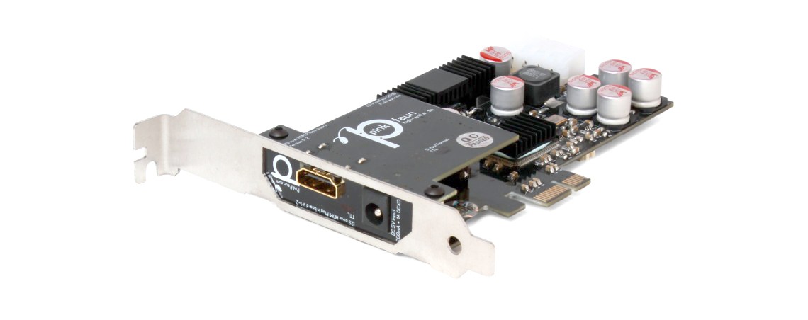

I'm currently using PCI-E USB (AsMedia ASM3142 USB chipset) for Gaming with a USB DAC and can never go back to Non-PCI-E.
So USB PCI-E or HDMI PCI-E or i2S bridge PCI-E into a Q7 for re-clocking I would consider moving on from the RPi. Of course, it would have to be off Mains so passively powered.

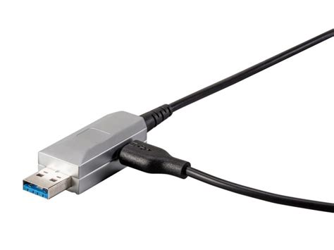

With a USB optical cable, I'll retain isolation but lose 16-bitness.

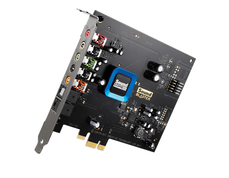

If I use a PCI-E Soundcard with Toslink OUT, would it retain it's 16-bitness? I understand you mentioned the quality will be there due to the Q7 re-clocking the Toslink input but what about Pure 16-bit? You mentioned if you want isolation, this is the way to go.

PCI-E USB
USB optical works for isolation, but lose Pure 16-bit. No thanks.
PCI-E Toslink Soundcard
16-bit?

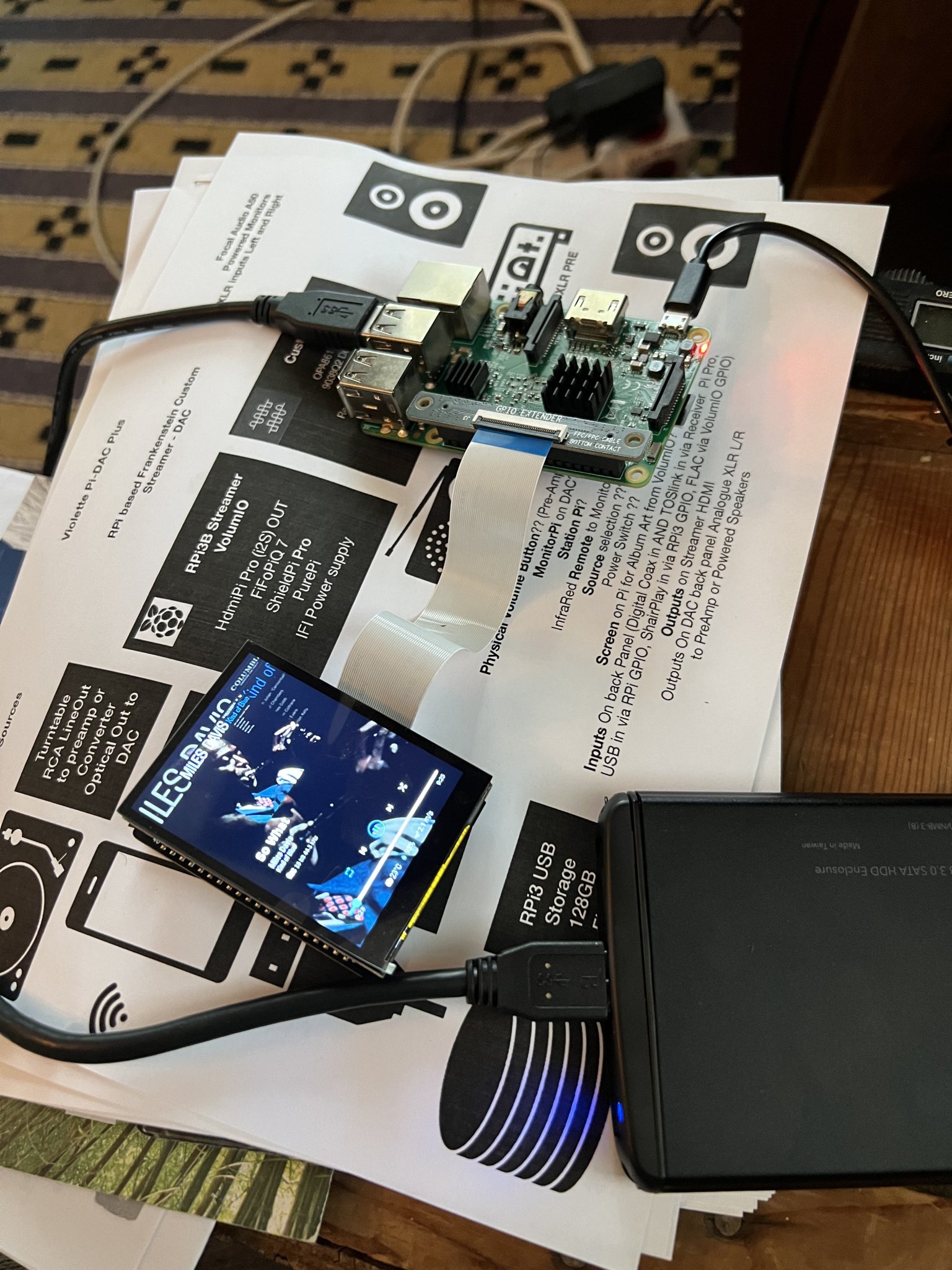

Hi, Does anybody know if this screen works with Ian Pi Audio stacks?
https://www.waveshare.com/wiki/2.8inch_DPI_LCD?amazon
I'm running Pi, USB SSD drive, Ian streaming stack (shield pro, fifopiQ7, monitor pi pro, TransportAES, volumio
Note, it works with volumIO and a bare RPi3B with ian GPIO extender kit no other hats for sure. See picture. I just don't want to blow anything up but adding the audio boards. This is a 5V2.5A iFi power supply. The screen seems to say you need a 3A PS, but so far it works with just RPi3B and VolumIO and USB SSD.
excerpt from above site on pinouts below. It looks like the pinout for RGB uses some of the same pins as i2S, so i don't think they will work together.
If this is too off topic from the audio board stuff, let me know. I have built the streamer and now just want a kiosk display running and have chosen this little DPI LCD screen which goes on the 40 PIN GPIO.

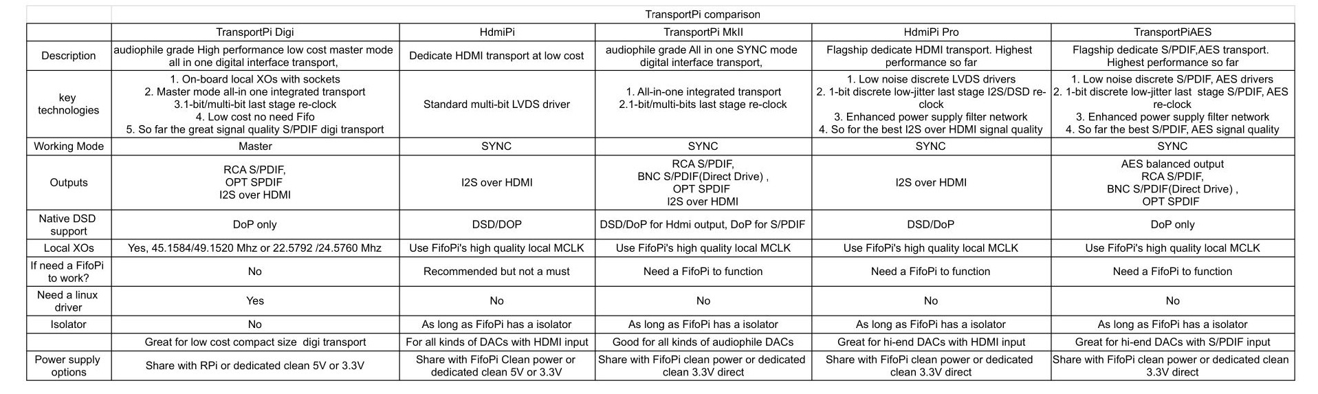

Your comparision chart really pushed me over the edge for a possible TransportPiAES. Not because it has AES functionality, but because it's the Flagship S/PDIF transport with the highest performance. I don't want to ruin my FPGA DAC ARC, so I'm hoping to justify for GB2023.
I believe I bought the TransportPi MKII this year so I didn't need a doubler anymore, so it takes a lot to justify on my side but my chain is so tight the TransportPiAES S/PDIF flagship would always be in the back of my mind. Because I have no leaks, the TransportPi MKII may be consider a leak even though it's completely new. No worries, The TransportPi MKII will go towards my Redundant system as I plan to order another 5.6448 MHz clock in 2024-2025. I wish I never stumbled upon TransportPiAES as a Flagship S/PDIF transport. I was quite content for it to be a AES option. But once I realise it's an S/PDIF upgrade, I don't think I can resist. Especially since no one focuses on improving S/PDIF anymore for at least the last decade so I think I can justify.

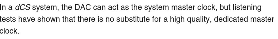

With that said, my FPGA DAC also has an internal PLL Clock close to the DAC. So for modern use, it is considered best practice to architect your chain to utilise the Internal PLL CLock. I'm not ready to go there yet as my use case is maximise 16-bit CD-quality with State of the Art Clocks via 16-bit Toslink.
So for example, 95% of dCS users purchase a external clock along with their DAC even though their DAC already has a internal clock. I'm in this camp for now running an external clock, but things can change and I can go back to running the internal clock close to the DAC which a considered a modern best practice. But I'm happy to have both options. One for 16-bit Redbook and another one day for streaming.

USB optical
So here is where romaz mentions pairing a USB cable with a USB optical cable:
That's right, Geoff. SlimRun optical + "any USB cable" I have tried sounds better than that USB cable alone with the Extreme.
pair
For I, the Ian Stack runs independently of the DAC so you can keep your options with third-party DACs open.
My reason for Toslink was optical isolation. USB did not provide optical isolation until a later point. I do enjoy my USB optical powered by UcPure 5V, but with State of the Art Clocks I need a few more years before experimenting with USB optical for Music again. For now, it's just for General Use and Gaming.
