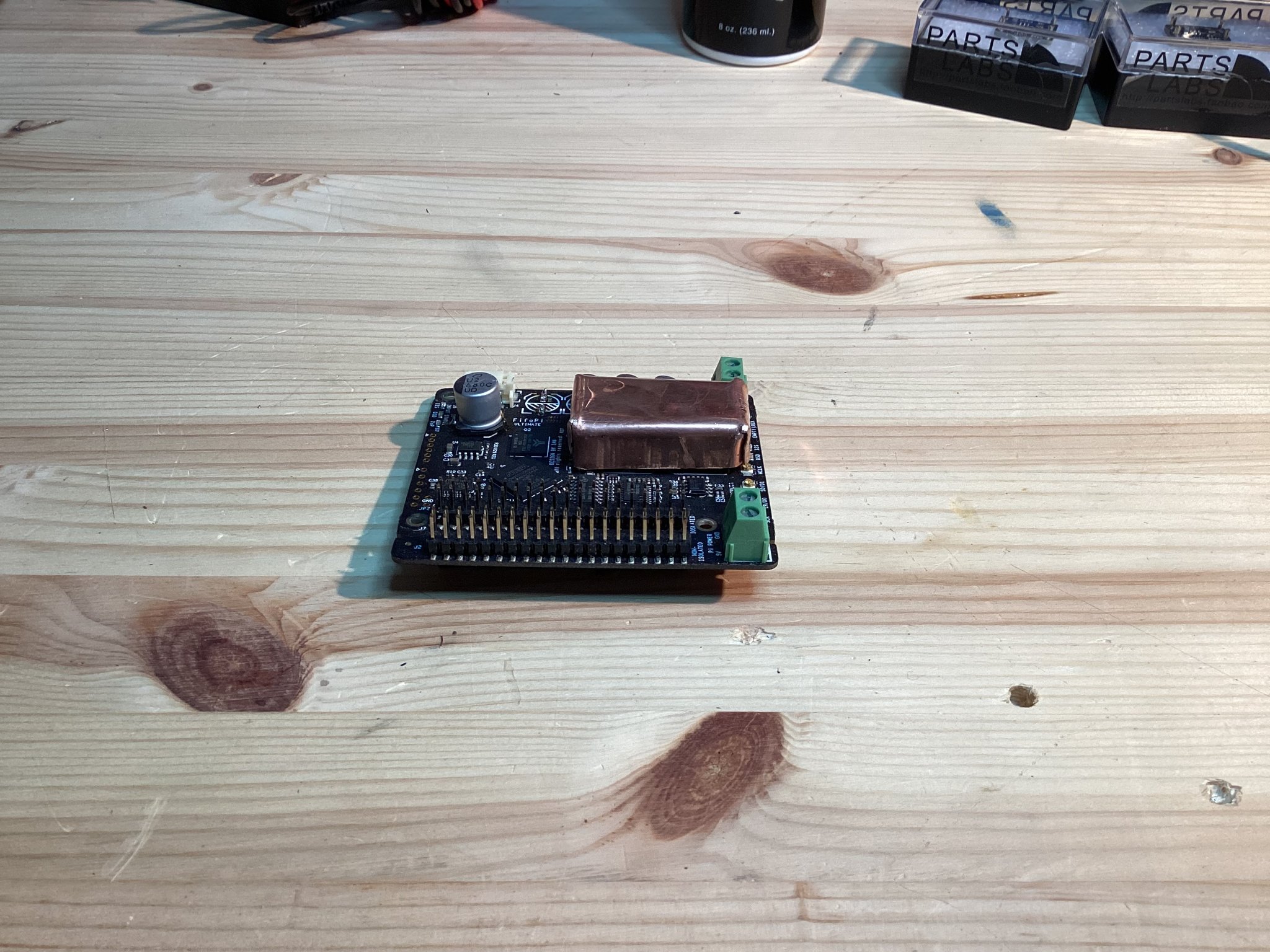

Earthing makes sense but try with and without and report back pleaseInspired by «gabster» on youtube. Copper shielding the clocks. Maybe I should ground the shield ? Anyway, time will tell if there is any upgrade doing this. View attachment 1206961

Very nice - what copper shield did you use (is that copper foil)? You DIY yourself or found something to fit?Inspired by «gabster» on youtube. Copper shielding the clocks. Maybe I should ground the shield ? Anyway, time will tell if there is any upgrade doing this. View attachment 1206961
@BogdanS i did it this way. but only the clocks might have been even more convenient as @smooth dancer has done.

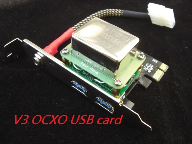

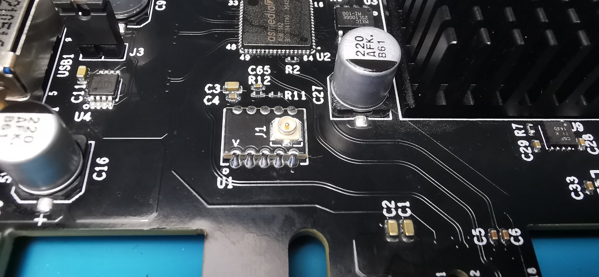

I took a peek how USB PCI-E cards are evolving before I shut down into end-user mode to prepare for future projects. I'm motivated now with my UcPure/UcBalancer powering a USB optical cable but without external clocking on USB PCI-E it's not worth pursuing.
As you can see, of course they are using the ASM3142 USB Chipset top-middle. It's dumb not to run PCI-E ASM3142 for USB Audio or USB Gaming Audio. Then J1 is for external clocks. So if USB PCI-E cards evolve further, I might delay my redundant 5.6448 MHz project and pursue 24/25 MHz for USB. Of course UcPure/UcBalancer will power @ 3.3V the PCI-E card. These PCI-E cards are over $1,000. I was hoping for Taiko USB PCI-E for gaming, but they suspended sales. The Taiko USB PCI-E is the same PCI-E card used in their $40,000 Music Server. I'll check again if a Taiko is available in 2025.
So exciting times, but my brain has to shutdown as it's all too much, too cutting edge. Need to shut everything out. USB Clocking is not ready for prime time for another few years. Same with Motherboard Clocking. But Passive Power Supplies like the UcPure / UcBalancer can always be re-purposed for USB use.

Not sure what you mean? USB 2.0 High Speed is specced to run at 480 MHz ±0.05%. From a 6.144 / 12.288 / 24.576 MHz clock you can use an integer PLL to arrive at 480 MHz (6.144 * 625 / 8). Often a USB board will have a 12.0 MHz oscillator (not 12.288 MHz) for USB 2.0 Full Speed and then use a PLL to do x40 for High Speed. Many variations are possible, but I guess a PLL is not what you're looking for, so that's why I'm genuinely interested what you mean.
Then there's the whole matter of isochronous transfer mode which has a FIFO on the "receiving" device but I don't want to stir that pot any further -- whoever wants to insert USB Reclocker is more than free to do so, more than enough threads on that already.
