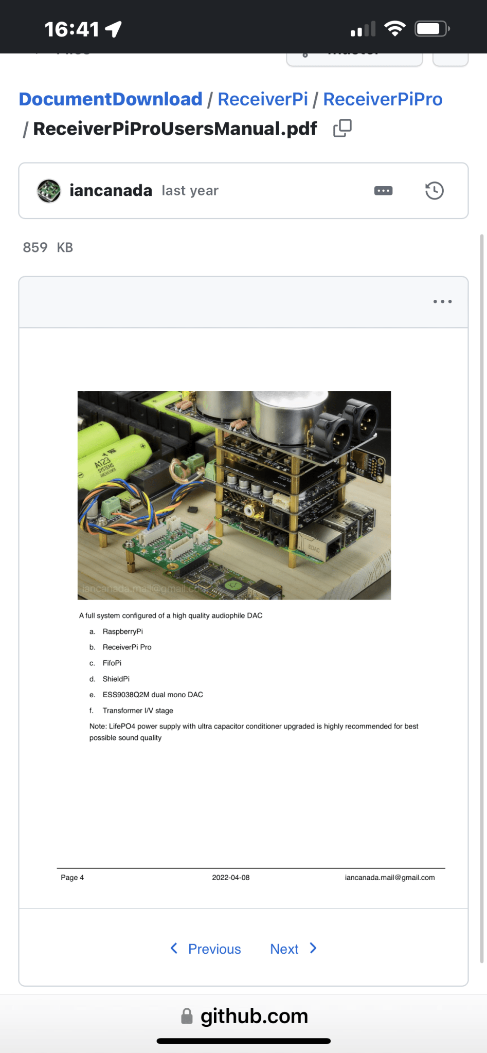

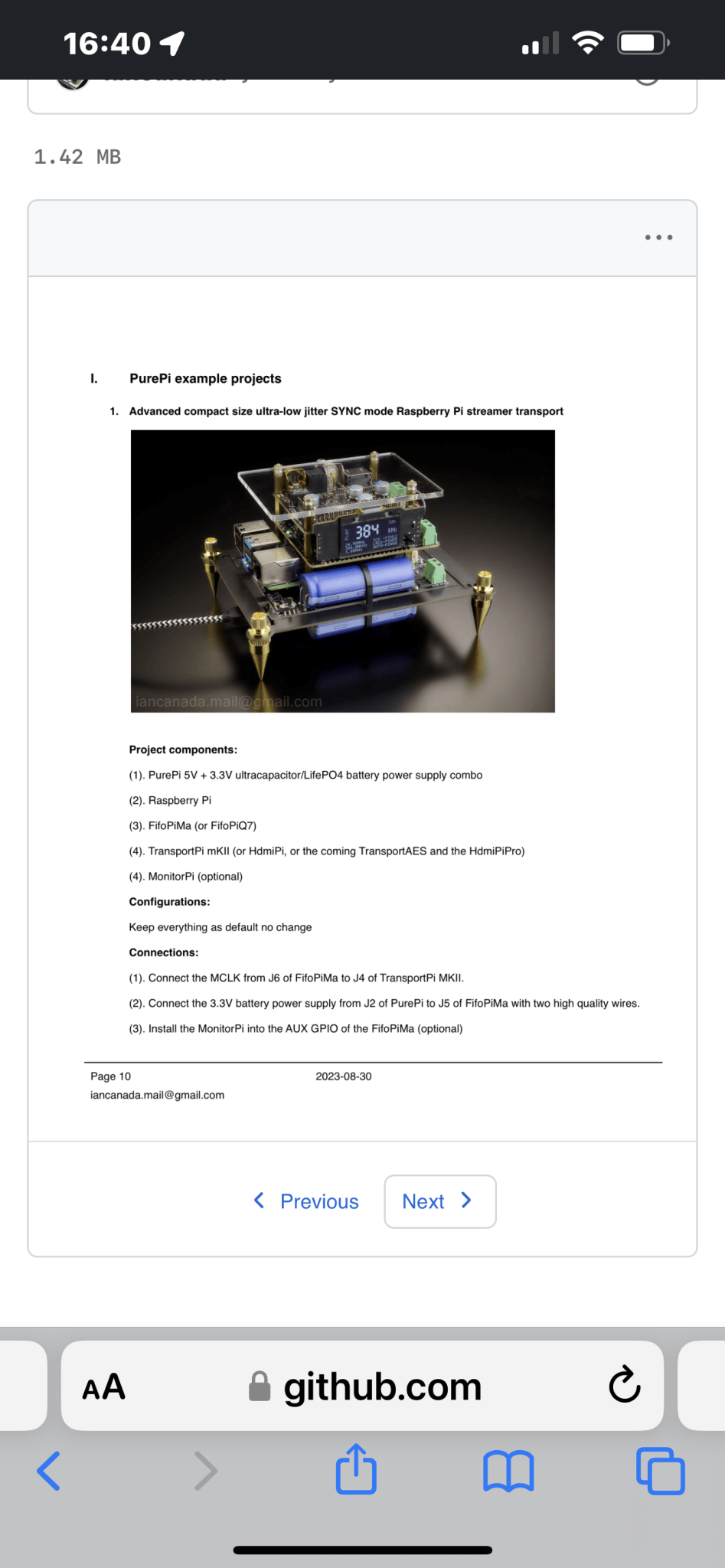

See two screen caps for streamer stack from purepi II manual and DAC stack from receiver pi pro manuals.
Stay tuned - I’m building a DAC in the next couple days. See my streamer stack from recent threads.
