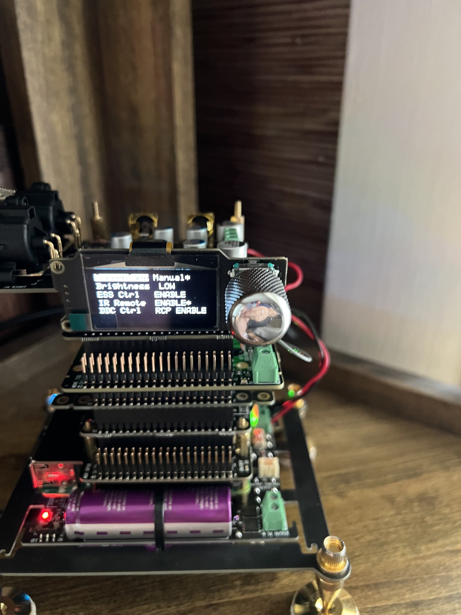

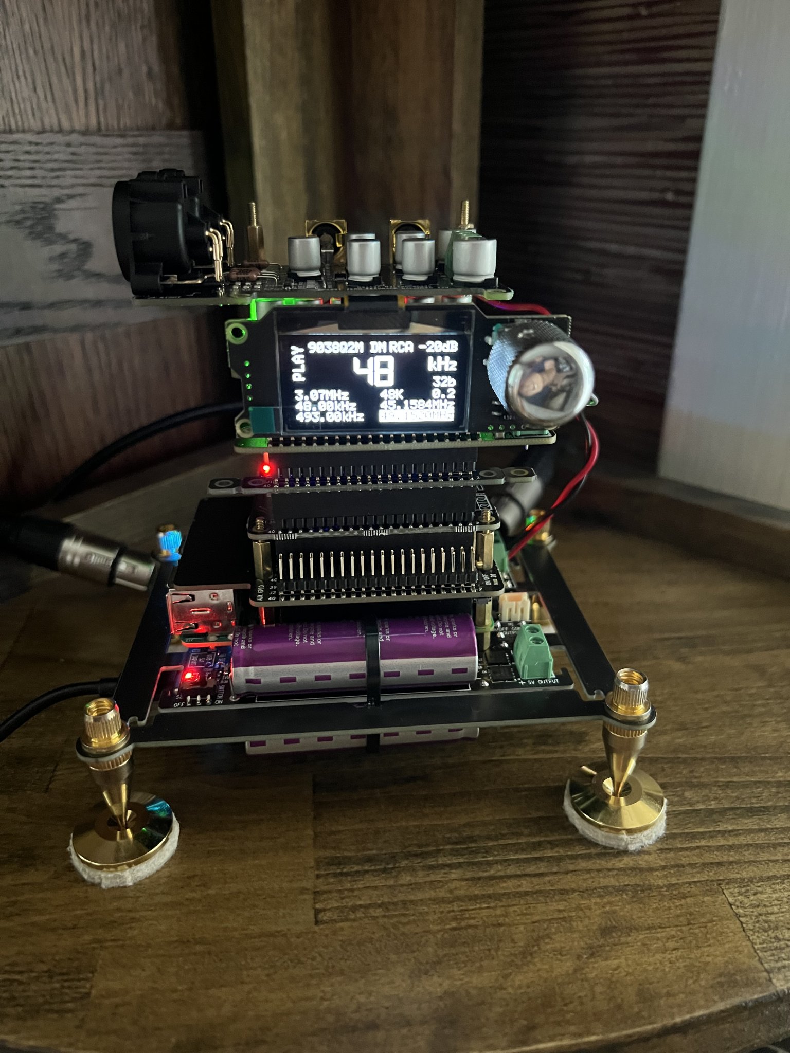

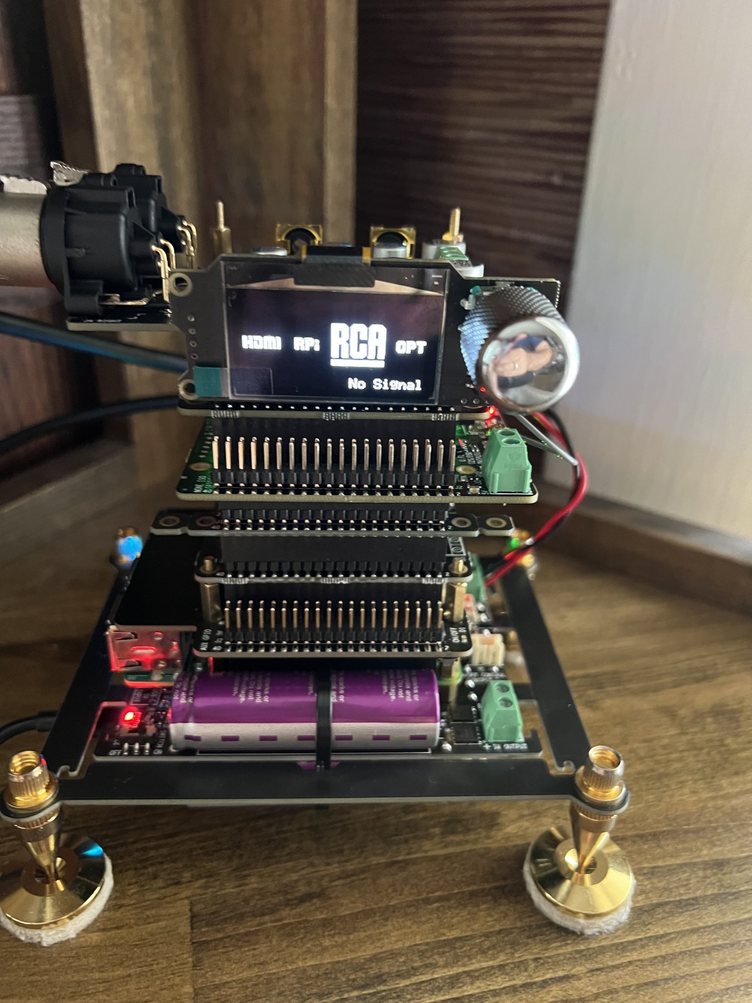

Hi all, here is a list of the Streamer/DAC stack I posted yesterday:
0. Amazon Spikes (stand)
1. PurePi II power supply (clean 5V and 3.3V power) fed by iFi Silent iPower2 Power Supply
2. Raspberry Pi3B
3. ShieldPiProMkII shield (reduce noise, although this should be higher up in stack, i don't have a required adapter so its here now)
4. ReciverPiPro input board (input from GPIO, HDMI (I2S), RCA (Coax digital), Optical)
5. GPIO Spacer to get next board above receiverPi input hardware
6. FiFoPiQ7 (reclocker magic)
7. MonitorPiPro installed onto FiFoPiQ7 (new board combining ESS controller and monitorPi functions and then some. no manual yet. I am one of the first users)
8. 9038Q2MPIDualMonoPlus DAC Hat (converts to analogue out). Remove clock as FiFoPiQ7 is doing the clocking function.
9. OPA861 Fully Balanced Zero Feedback 1/V Stage (XLR and RCA outputs)
Notes
i) FiFo Master clock connected to DACHat Master Clock.
ii) 3.3V connected from PurePiII to FiFoPi and then bridge to all 3 3.3 volt blocks on the DAC Hat board. Be very careful not to mix the polarity up or you will blow the boards.
iii) This is still somewhat non functional as I need to power the OPA861 with +5V, -5V and Ground from a clean power supply such as the LinearPi Solo or Duo, and then this also needs fed with another external power supply. So I am working on figuring out what i want there. I do get sound, it is just not loud as obviously the OPA861 opamp board needs power to amplify the signals I assume.
iv) I had to jumper the ReceiverPi Pro to select audio input to the RCA digital input (coax). I believe the future receiver boards will be able to have a jumper from the MonitorPiPro to the ReceiverPixxx to enable the selection from the front panel to work. Of course you could attach your own switches to do this function easily.
Hope this helps.

Yes. This is interim to see what else I need to buy for the DAC build. The Pi is only there to mount the receiverpipro onto. I need to buy a kit to be able to mount onto PurePiII directly without the Pi.For future are you going to plan ShieldPiProMkII placement between Fifo Q7 & DAC Hat? required adapter will be a spacer or any thing specific?

Yes the recommended build is with the shieldpipro elsewhere.

This was just a basic test to see if the DAC and output boards worked. And I discovered I need a truckload of different power 😂 super fun project.
I currently output from the streamer via coax or optical out to my Cambridge DACMagic 200M. I am going to try to better the DM200M with Ian’s stuff.
My current setup for analogue is XLR to powered Focal Audio A50 monitors. So when I ditch the Cambridge it will be XLR out from the custom built DAC OPA861 to the focal audio.
Eventually I will build a preamp but so far the DAC xlr out provides more than enough volume via powered speakers. Ie precessional line out signal to powered monitors. I am a musician too and I love XLR.
Cheers
