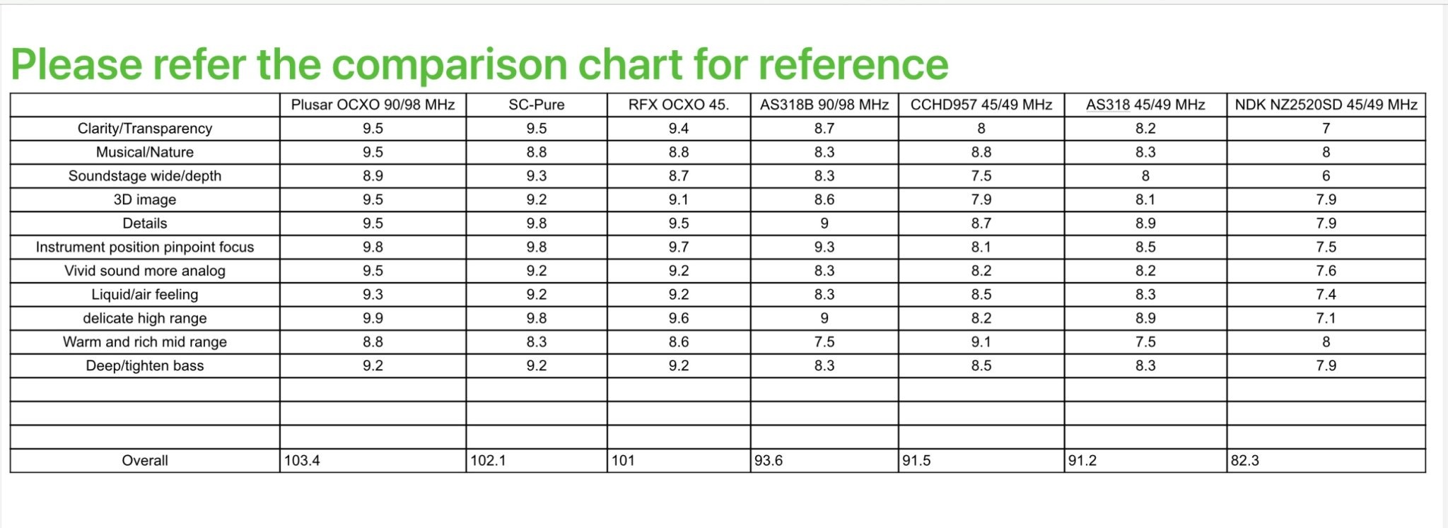

Ian has a chart that I think he will send out.Hallo Fusion en andere sc-pure-kopers,

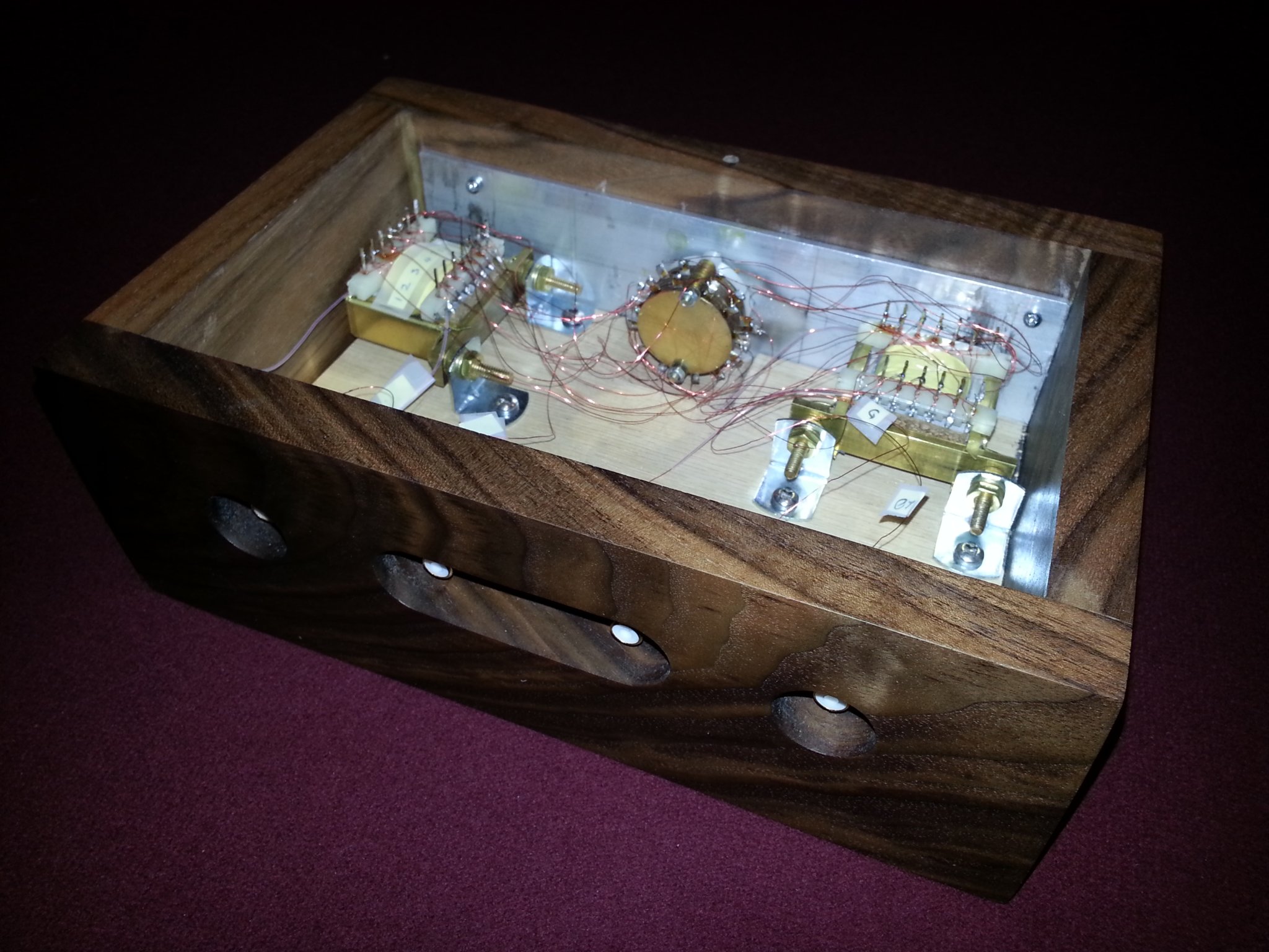

I'll share what I use which is off the beaten path but really very good. Autoformers from Dave Slagle aka www.intactaudio.com . Resistive volume attenuation is same as dragging the breaks on your car. Autoformers are like downshifting the transmission. One throws away the power, the other transforms it in a good way. Instead of killing micro detail, it just gives more current at lower volume.Can you point me to some ply board kit how-tos
https://www.enjoythemusic.com/diy/0611/slagle_autoformer_volume_control_modules.htm
I mounted them in a wood box, but they'll work equally well on a board.

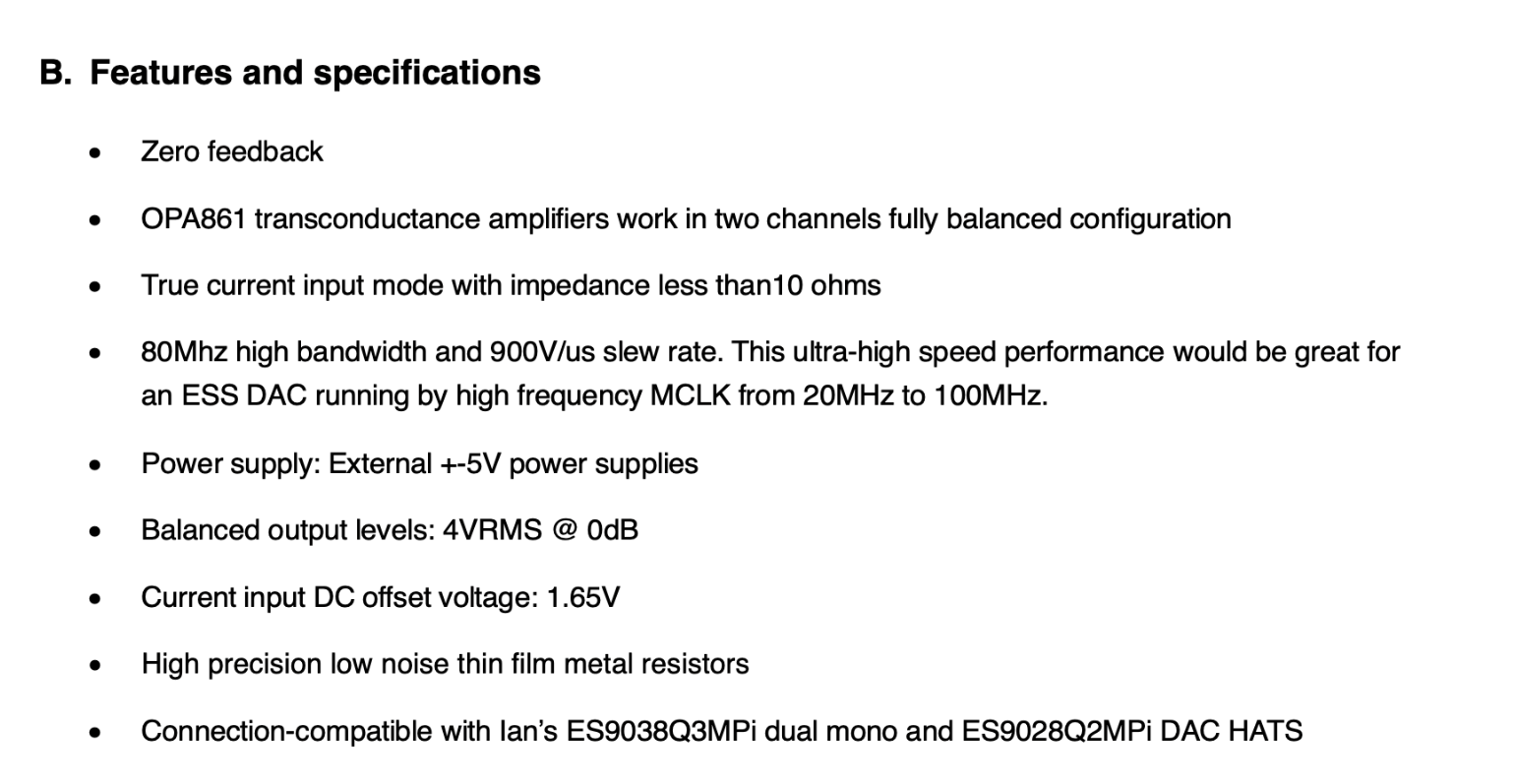

So for my analogue output board on the ian DAC (dual mono) I built (OPA861), it's giving me 4V out @ 0db (full ESS chip output) at XLR analogue side. So a pre-amp just gives me essentially a volume control to REDUCE the volume (voltage from 4 to something lower than 4V) before handing it to the power amp? Because power amp input voltage is 2-4V.
And I need a good pre-amp to preserve the dynamic range on the pre-amp side to be as close to the digital SNR of the DAC?
So what is benefit of the pre-amp? Isn't it just one more place to degrade the signal? Why not use MonitorPiPro volume control and go straight into a power amp if the OPA861 is able to give power amp input voltages no problem?

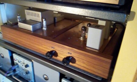

I am using the siver wire autoformers from slagle too in my tube line pre amp.
A few decades ago there was the same discussion why use a pre amp if your cd player gives you more than enough output voltage.
So i am sure the answer is out there.
Having balanced connections is a nice advantage. I remember a meeting with a French diy audio group in the nineties in a real cinema. The chairman of the group did install the sound and vision system in that theatre . We watched a James Bond movie with the best movie sound i ever heard.
After that we played music using a Revox/Studer D730 which was positioned in front of the stage and ALL the other equipment was in the room where the projector was. SO probably minimum of 100 meters balanced interconnect ( Mogami/Prefer/Neglex surely no audiofool brand) and a remarkable good sound.
That was the reason to go for a balanced output on my tube line stage with a pair of Tango output transformers.

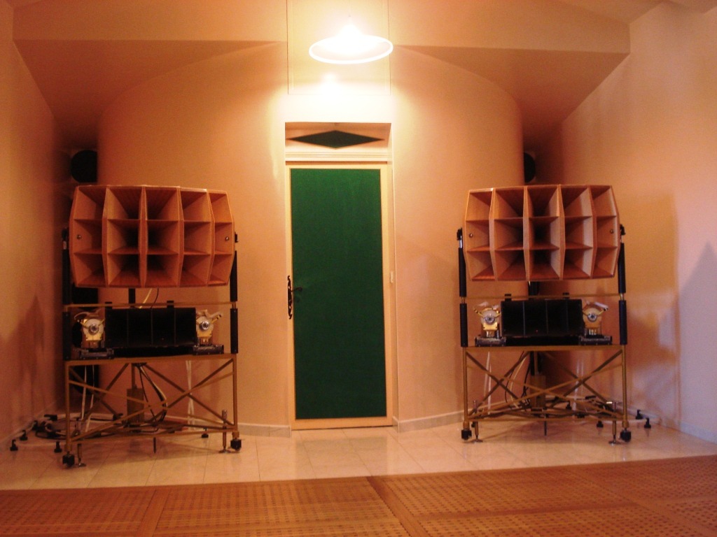

In the attachment the loudspeaker system of a French audiophile friend recently deceased and my homebrew tube line amp.
Greetings, eduard
