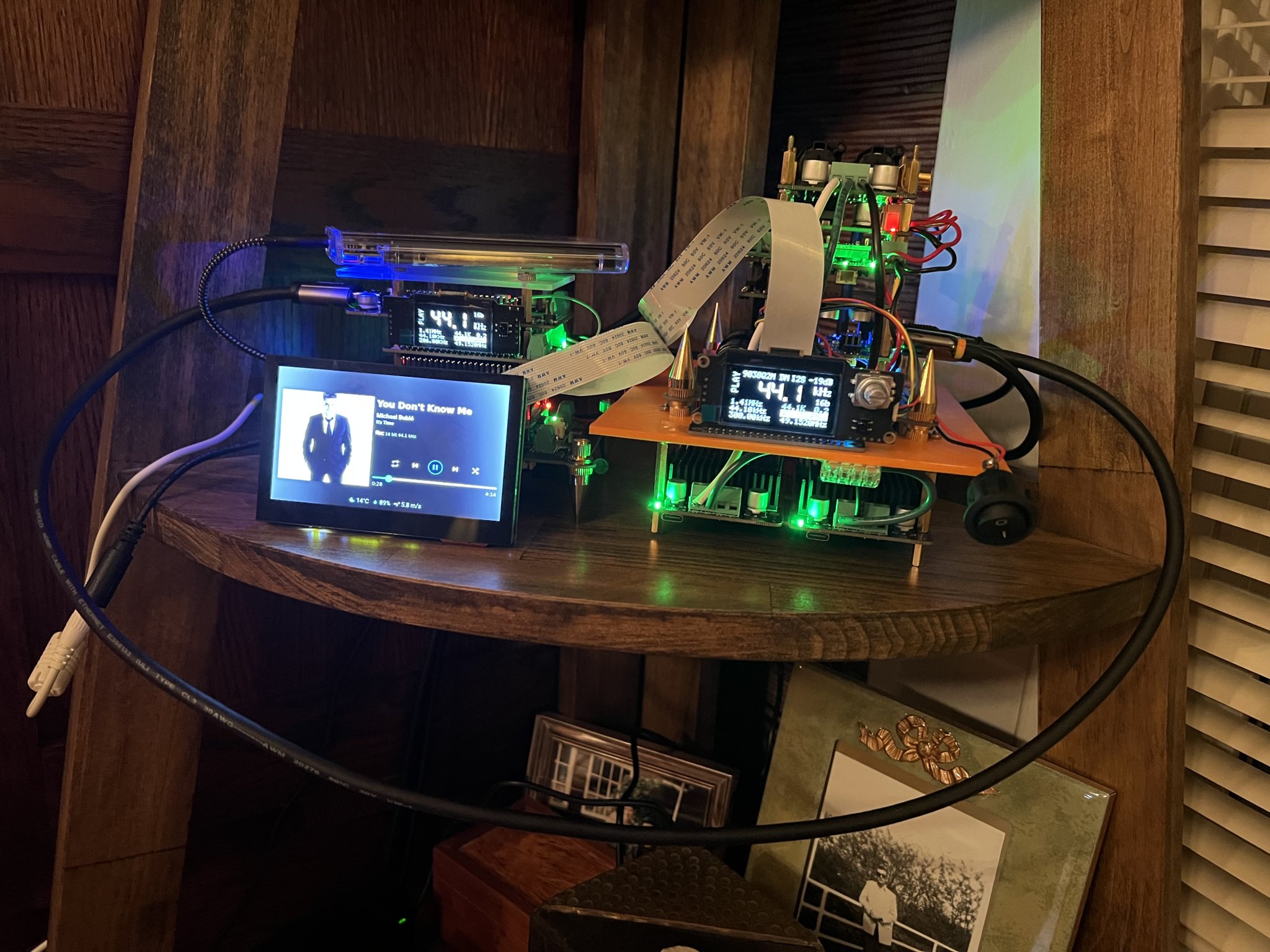

Hi!My streamer stack rebuilt with HDMIPro transport board and connected to my recently built DAC stack via ReceiverPiPro II via HDMI input. MonitorPi on streamer and MonitorPiPro on DAC. DAC output to powered professional studio monitors speakers via OPA861 I/V analogue board. Both stacks powered by PurePi II. Linear Pi Duo for the DAC output board. Irreverent DSI screen and SSD FLAC drive on the RPi4 streamer. IFi X 3 amp supply for streamer. IFi 2.5 amp for DAC. Dual 12v DC bricks for the linear duo.
May separate screen and music one day to a separate box but for now I’m loving it.
Thank you @iancanada for all the advice and guidance and newbie questions.
Now to figure out how I want to package them up but for now enjoying the bliss with a 🍷!
There is a lot of capability and power and sublime sound 🎶!
Why did you not build everything into one stack? You can stack ReveiverPiPro II + FIFOPI Q7 + DAC hat + MonitorPiPro + I/V board.
I do not understand why you separated them.

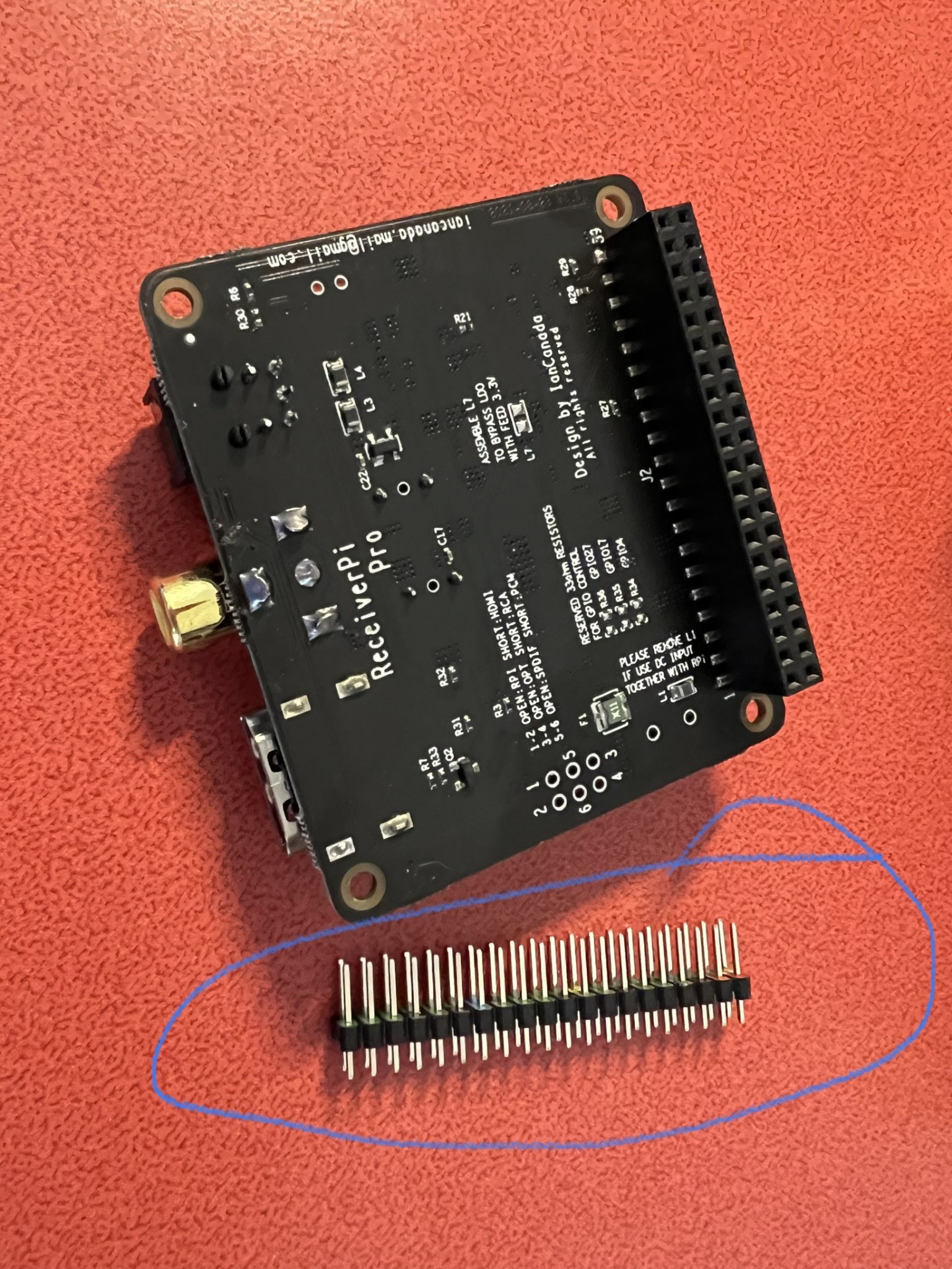

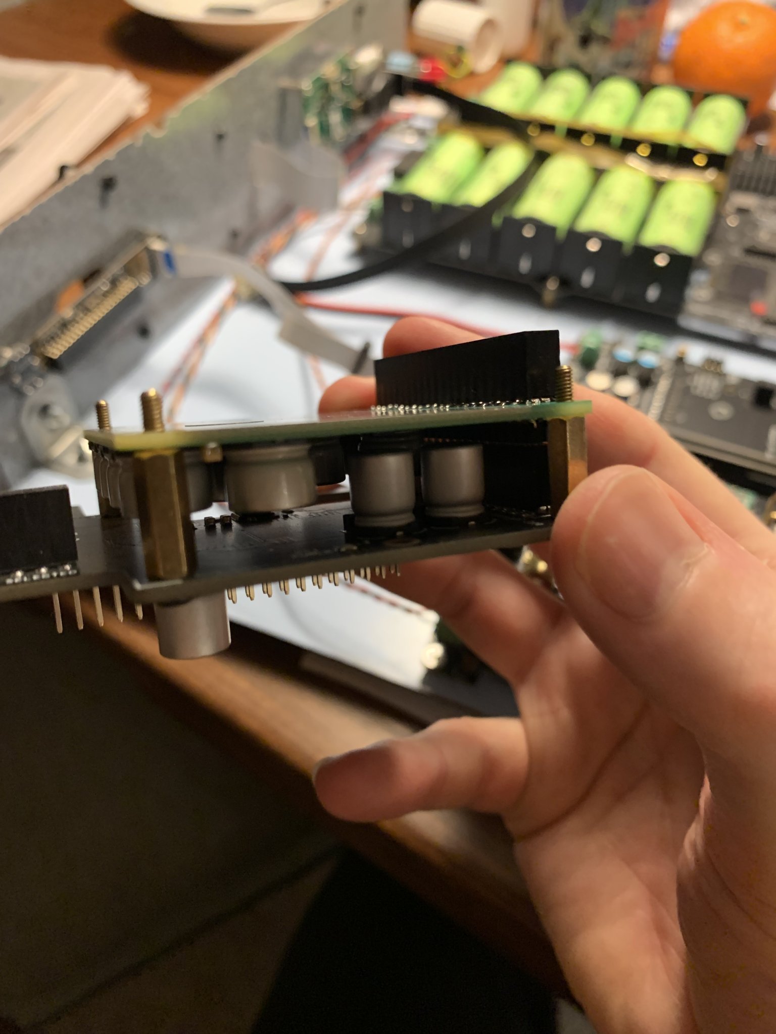

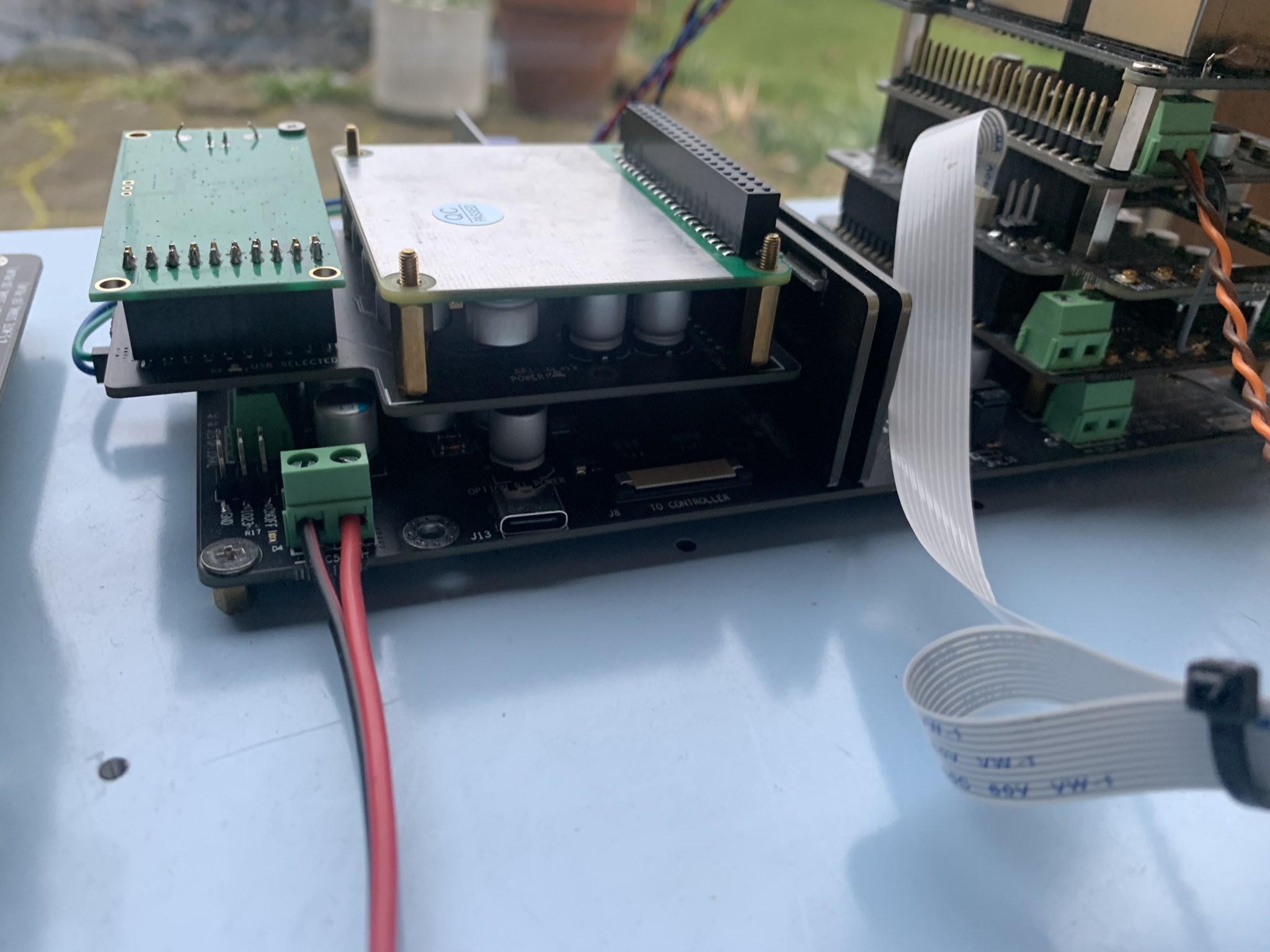

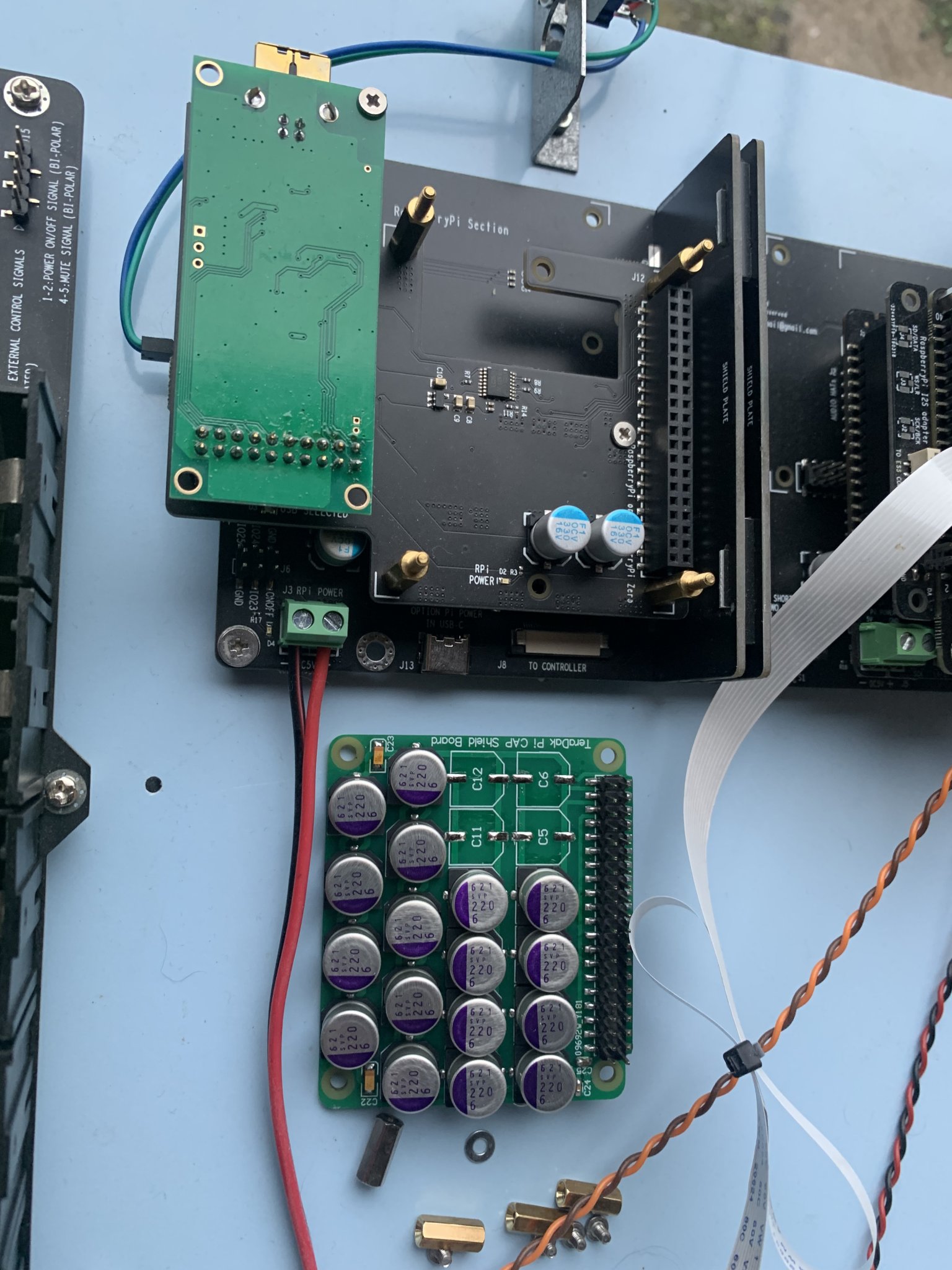

I am also using the Teradak filter board.@WladimirMXP
Could you please provide Teradak shielding/filtering board link and more details on that? how is this supported in between?
After having ShieldPi Pro, do we still need shielding plate? will that be additional support?
I am mostly using it as a GPIO extension due to the use of a RPi and Amanero USB on the station pi pro. In this configuration the HDMI port of the RPi is not accessible. The Teradak lifts the RPi up a board.
I removed four capacitors at the teradak board so it could fit the StationPi pro.

I don’t want stuff on the streamer stack to interfere with other inputs going straight into the DAC only stack. No RPi on DAC stack. Ie turntable or other S/PIDIF into DAC.Hi!
Going old school. Component system of analogue and digital components. Plus I wanted to learn how i2S works.
I built the DAC as a replacement for a Cambridge DACMagic200M. To see if I could beat it. And if I need to I can plug the streamer into another DAC.
Completely blows it out of the water. It’s now a doorstop if my stacks go up in flames 🔥 from turning them up too loud. It just kicks - probably would blow out a match if I had bigger speakers.

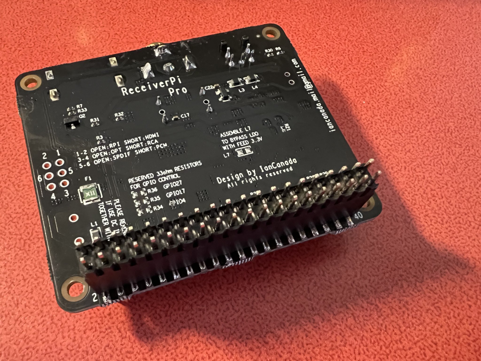

This is what I used to go ´PiLess’ under ReceiverPiPro to mount directly to PurePi II to reach the spring power pins.@fusion360guy

Thanks to @miklau for answering most of the questions. I'll just add that I don't see much reason to add this Teradak on top of ShieldPi or the cooling copper plate, but the Teradak might fit between those boards where ShieldPi doesn't. The biggest difference is that Teradak has capacitors on the top side of PCB, so it's not obstructing anything below it.
The minimum height / spacers for this board is 11mm. Happy listening @VMRKarnati
